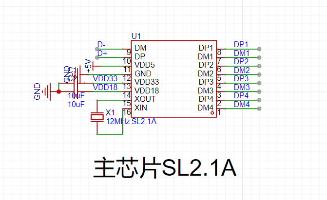

Main control chip circuit:
This chip can be purchased from LCSC Mall or Taobao

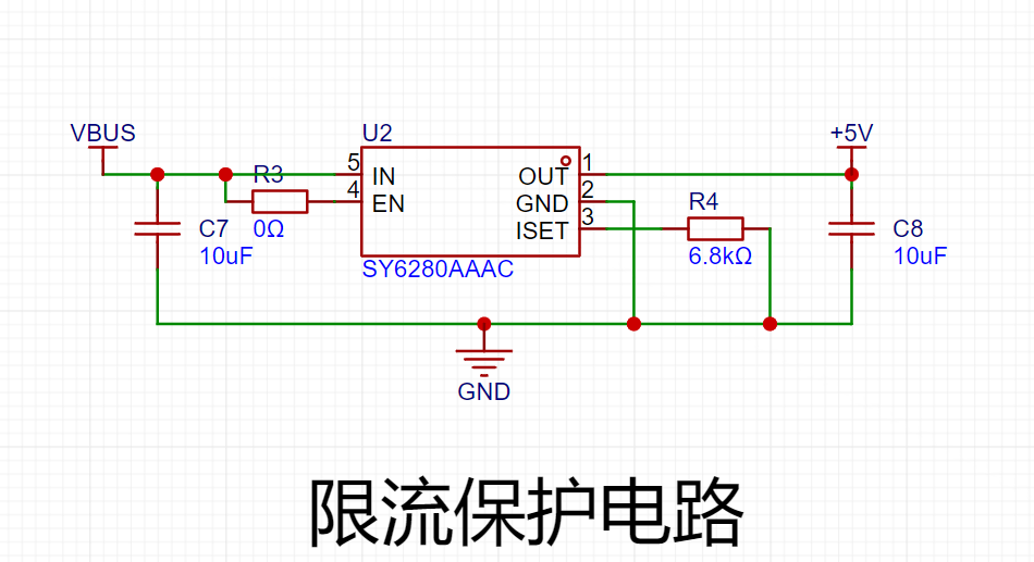

. Current limiting circuit:
A current limiting circuit is used to avoid damage to the computer caused by short circuits.

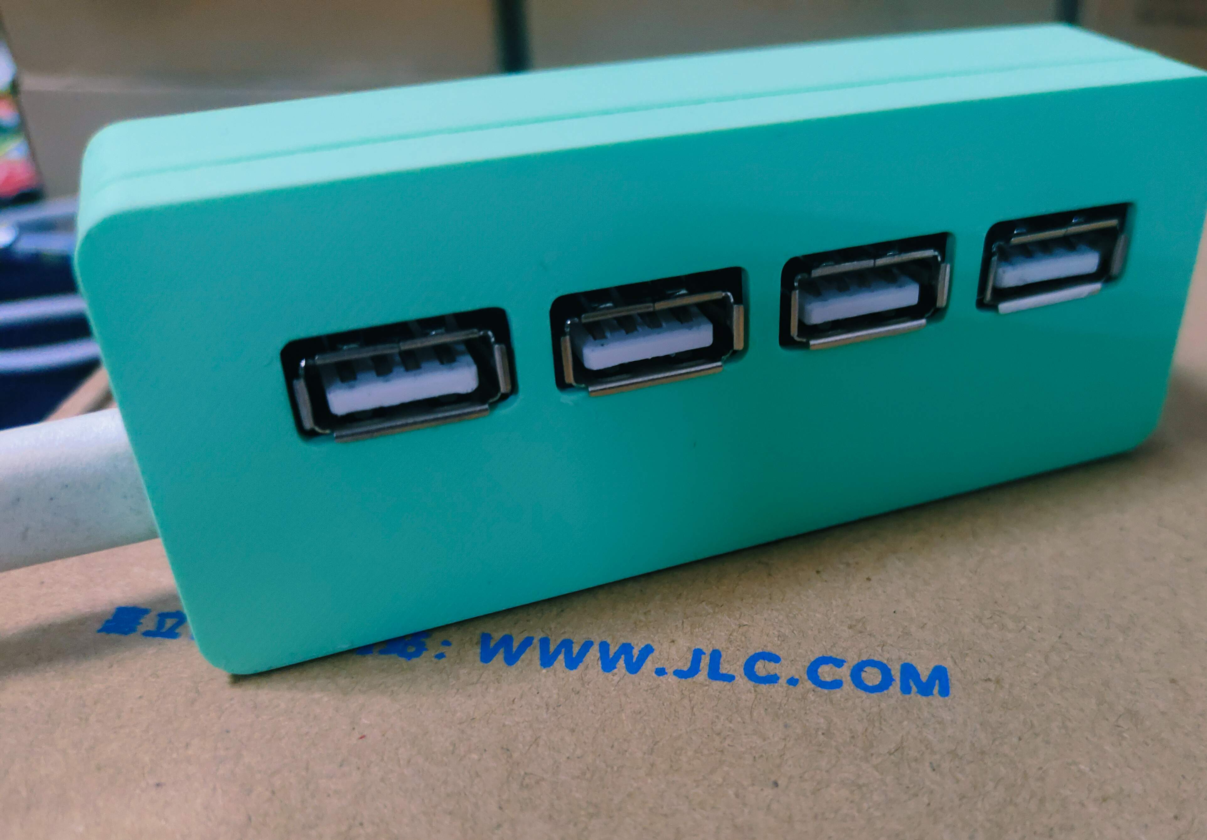

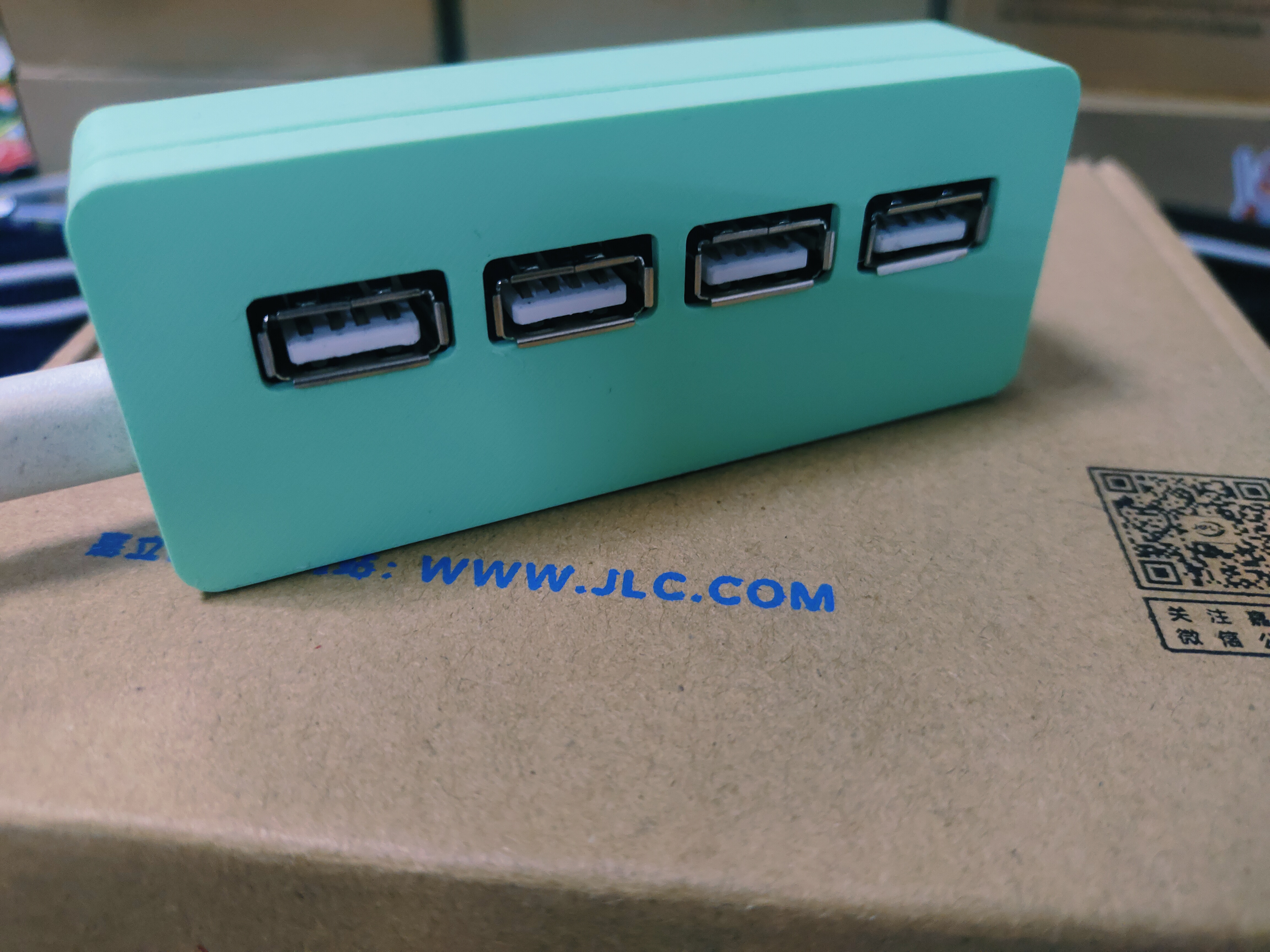

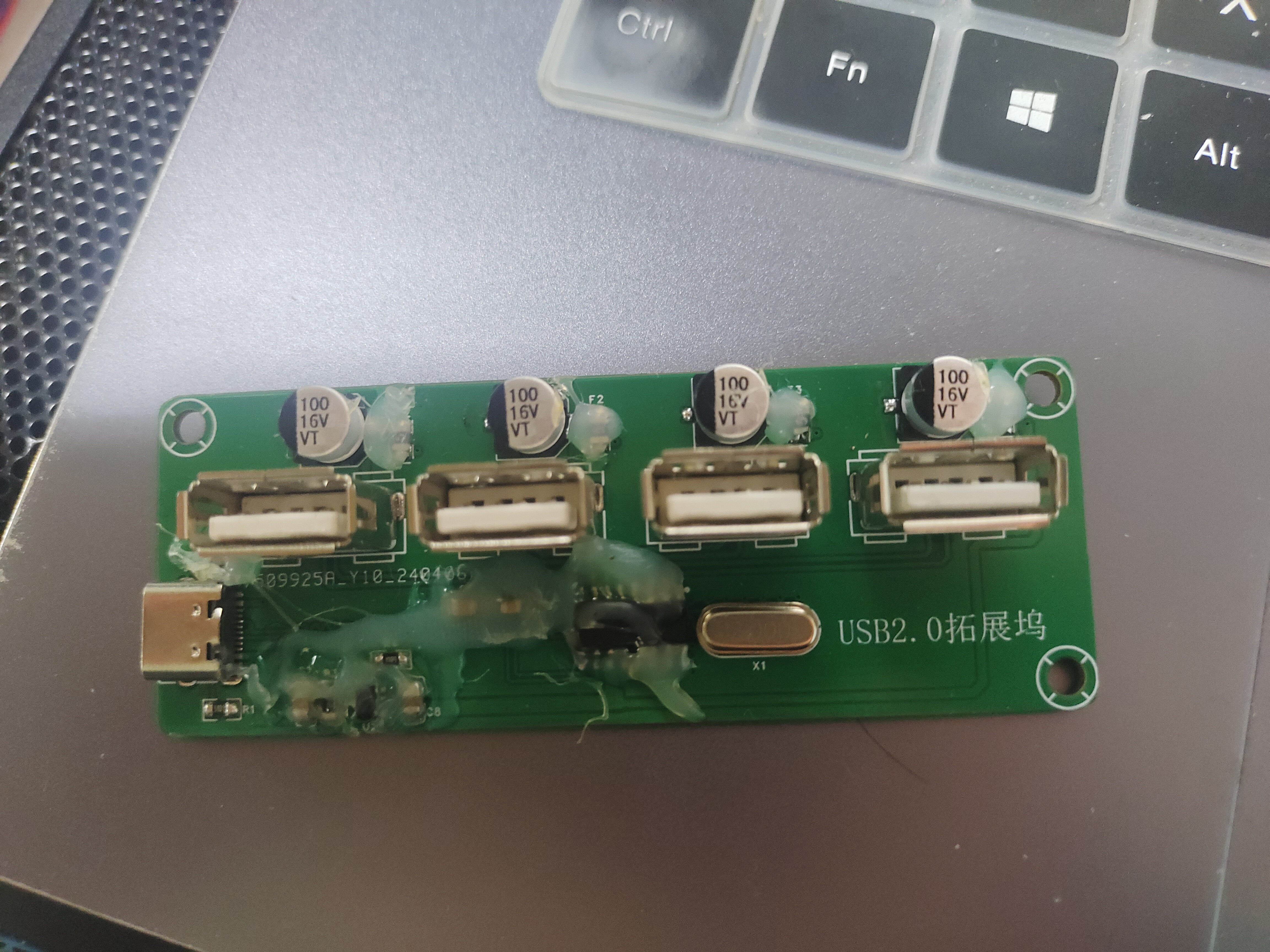

Actual product image:
Tested and working; those interested can place an order. By the way, it's best to use the Type-C version; the Type-A version seems to have some minor issues. I recommend ordering the Type-C version docking station. The shell file is provided below.
