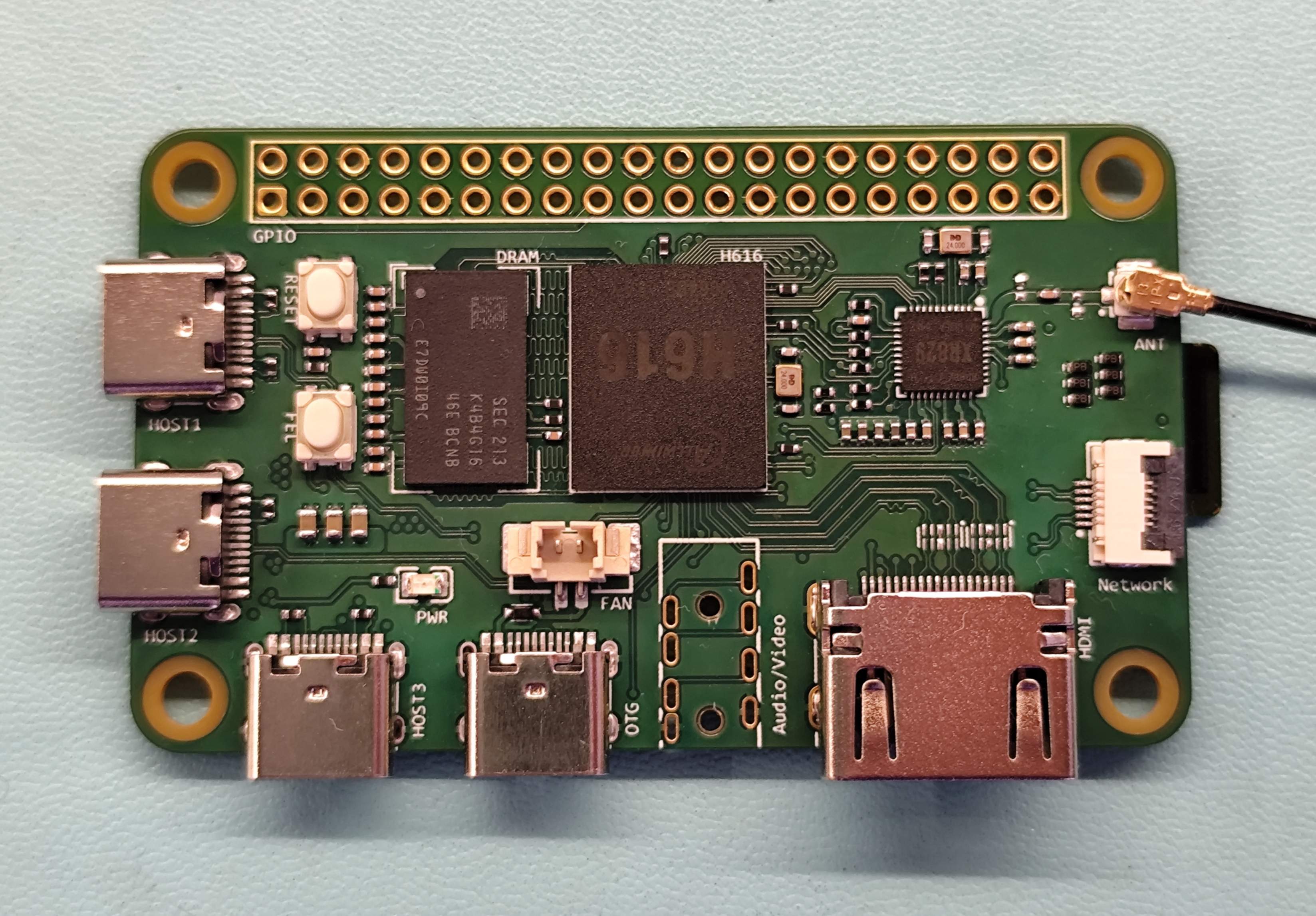

Bomb Pi Zero
Thanks to the developer for the open source! This is a smaller version of the original H616 development board project based on Yuzuki Chameleon: https://oshwhub.com/gloomyghost/yuzukih616.
The Bomb Pi Zero
completely redesigns and relayouts the PCB to reduce its size and adapt to JLCPCB's through-hole technology.
To further reduce size, the eMMC is placed on the back.
The GPIO pin definitions are silkscreened on the back.
There is no copper around the screw holes, so there's no need to worry about soldering (the copper pillars won't connect to GND).
The CC pin resistor of the Type-C port has also been modified. The original circuit might have issues when using CC lines or cables with E-mark.
Other circuits remain unchanged and function identically. The initial version of
V1.0 could not be programmed for unknown reasons. Thank you, Ling.
