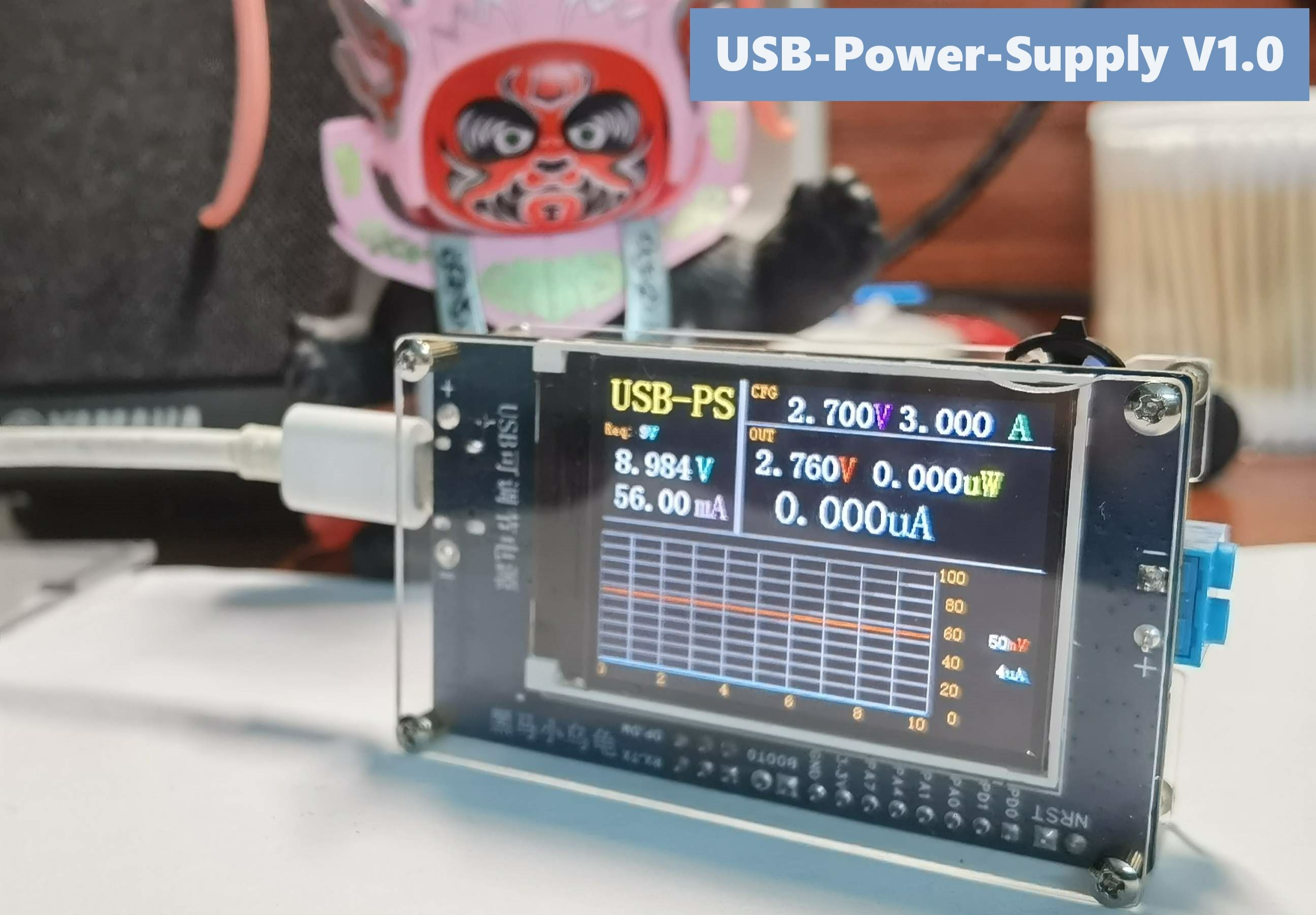

Project Introduction
———————————————————————————————————————————————————————————————— This design supports USB PD3.0 and BC1.2 protocols. It can power the system
with 5V, 9V, 12V, 15V, and 20V power from USB power adapters supporting the PD/BC1.2 protocol . It features a wide-range output voltage, adjustable from 2.7V to 20V, and a 3A load capacity. Input and output voltage and current are monitored in real time and fed back to the user via a 320x240 TFT screen or a host computer. Output and input voltages can be adjusted via a multi-function button or the host computer. This is an initial version of the project, and there are still some minor hardware design issues, listed at the end. If you wish to replicate this project, it is recommended to work on version V2.0. Below is the open-source address for V2.0. Why retain V1.0? The main reason for keeping version 1.0 here is that some friends have already been working on it. We want to keep version 1.0 here so that they can refer to the relevant information. [Spark Program] USB Programmable Power Supply/Power Monitoring - JLCPCB EDA Open Source Hardware Platform (oshwhub.com)                                                                               (Click image to view larger image) The host computer WeChat mini-program is now online. You can scan to open the mini-program: Project Background ———————————————————————————————————————————————————————————————— I am an embedded software engineer who likes to tinker. I usually enjoy making some interesting "toys". Since I don't currently have an adjustable power supply, I often use voltage sources such as 12V, 3.3V, 5V, or simulating battery voltage changes when tinkering with my "toys". I don't want to spend money to buy an adjustable power supply. I thought, " Can I make an adjustable power supply that is portable, compact, does not depend on a specific voltage source, and can meet most of my daily needs?" My first thought was, "Can I use an existing power adapter (USB adapter) and connect an external DC to DC chip to achieve step-up and step-down voltage conversion?" I got right to it. I even checked out some open-source projects to see if there were any similar ones I could replicate. But... either they required a fixed input voltage source of 10V or higher (which is pretty impractical; I'd need a separate adapter to use that voltage source, which doesn't meet my design requirements); or the circuitry was too complex, making the whole device bulky, inconvenient to carry, and not suitable for DIY. Fine, I'll have to do it myself! Let's get started... Project Highlights : Supports USB PD3.0/PD2.0, BC1.2 protocol, supports 5V~20V input /output voltage adjustable from 2.7V~20V, 3A output current load capacity, sufficient for daily experimental use. Input/output voltage can be configured via WeChat mini-program. Real-time monitoring of input voltage and current is available for output voltage. Voltage detection resolution is 8mV, current detection resolution is 40uV/10mR=4uA. (320x240) The TFT screen displays real-time power consumption and can be used as a simple power meter to monitor the power consumption of electrical equipment. It can communicate with a host computer via BLE to expand its applications. It requires few peripheral components, has a simple implementation principle, and is very convenient for DIY. It is compact and easy to use, does not rely on a specific power supply, and can be used with any USB adapter. The hardware and software are completely open source . This project can also be used as an entry-level development board. Most peripherals used in embedded systems learning are used in this project, such as I2C, UART, SPI, USB, and IO control. Unused IO ports are brought out. Hardware Introduction ———————————————————————————————————————————————————————————————— Hardware Resources and Dimensions                                                                   (Click image to view larger image)                                                                  (Click image to view larger image) Power Output Terminal Block                         (Click image to view larger image)      Here I will focus on explaining why this design chose the output terminal block shown in the figure. The purpose is simple: convenience. It does not rely on a specific connector; any ordinary      wire can be used. Moreover, it can be operated without any additional tools (anyone with hands can do it).      I've seen some similar open-source projects in the open-source community, but they all use dedicated sockets, which have limitations and don't meet the requirements for portability and convenience. Schematic diagram introduction (click the image below to see a larger version): Below is the power input circuit. The input in this design is divided into two parts: one part is through the USB Type-C port; the other part is through      the U10 and U11 terminals connected to a DC power supply. PD protocol chip circuit: This part of the circuit is relatively simple, just the necessary power supply and control circuitry to complete the interaction between the PD protocol and the BC1.2 protocol. Note: The following series resistor for VBUS is not included in this version of the PCB; only the schematic has been updated. Without the 10k series resistor, the PD chip will overheat under 20V power supply, which may damage it over time! USB switching circuit: Used for multiplexing and switching between the PD protocol chip's USB D+, D- and the MCU's USB D+, D-. The working principle is: when powered on, D+ and D- are handed over to the PD protocol chip to complete the BC1.2 protocol interaction; when protocol information interaction is not needed, it can be used as the MCU's external communication USB interface. Additionally, the MCU's firmware is also downloaded through this USB port. A 3.3V DC-DC circuit provides a 3.3V power supply to the system. It supports input voltages from 3.0V to 40V.
The voltage and current detection circuit uses the INA3221, which supports 3 differential inputs and 3 bus inputs. The differential inputs are typically used to detect
small voltage changes in analog signals, such as current detection. Its ADC is 16-bit, with one sign bit, resulting in a 15-bit actual numerical representation. The LSB
is 40µV, and the full-scale range is 163.8mV. The bus inputs can be used to measure analog signals with lower resolution requirements, such as system input/output voltage detection.
The LSB is 8mV, and the full-scale range is 32.76V.
This design uses IN-1 to detect the VBUS input voltage, and IN+1 and IN-1 to detect the VBUS input current. IN-2 detects the output voltage, and IN+2 and IN-2
detect the output current.
The digital power supply Buck-Boost circuit provides power to the load. Its main function is to provide power to the device based on the user-defined output voltage and current limiting
. The output voltage and current limiting can be configured via the I2C interface.
The circuit in the red box in the diagram below, marked "New," was added during later debugging. This version of the PCB board was not updated; only the schematic was updated. This is important to
note. Currently, components are added using jumper wires. The SC8721 supports input voltages from 2.7V to 22V and converts output voltages from 2.7V to 22V.

The upper left corner of the LCD displays two pieces of information: 1. It displays the currently set maximum allowed voltage, which is
the maximum allowed voltage requested from the USB power adapter via the PD protocol or BC1.2 protocol; 2. It displays the real-time voltage and current information of the input source.
The upper right corner of the LCD displays two pieces of information: 1. 1. Displays the currently set desired output voltage and current limit; 2. Displays the real-time actual output voltage,
current, and power information.
The lower half of the LCD is used to record the output voltage and current information of the most recent 250 sampling points. The red line represents the output voltage, and the light blue line represents the output current. The multi-function button

After waiting for several days, it finally arrived!! The board was SMT-mounted today and shipped to Shenzhen. I unpacked the package as soon as I got home. Below is a picture of the assembled board. Two boards were SMT-mounted free of charge. Finally, I don't have to do it by hand anymore,
it's so great!! Two chips were not available from LCSC, so I had to hand-solder them.)
February 1, 2024:
Today, I soldered on the missing components and prepared to power on the circuit to check the power supply. However, after powering on, I found that the 3.3V power supply to the MCU and other ICs was abnormal, only around 1.1V. Ugh, what a hassle!
After troubleshooting, I discovered that the resistor in the RC filter circuit of the power supply was incorrectly mounted.
February 2, 2024:
Completed the driver for the INT3221 and the detection of its input/output voltage/current. Started debugging the SC8721 driver. During debugging, I repeatedly controlled the CE pin, and unfortunately,
one board of SC8721s started smoking. It's inexplicable; I didn't apply any load. Why did this happen?
It seems I can only stop here before the New Year. I'm going back to my hometown tomorrow, and this problem can only be addressed after the New Year. I don't know if it's a hardware problem or a software control logic problem.

Received the acrylic board today and assembled a machine immediately. Thankfully, it went smoothly without any unexpected issues. Here's the result! Hmm... instantly upgraded!
