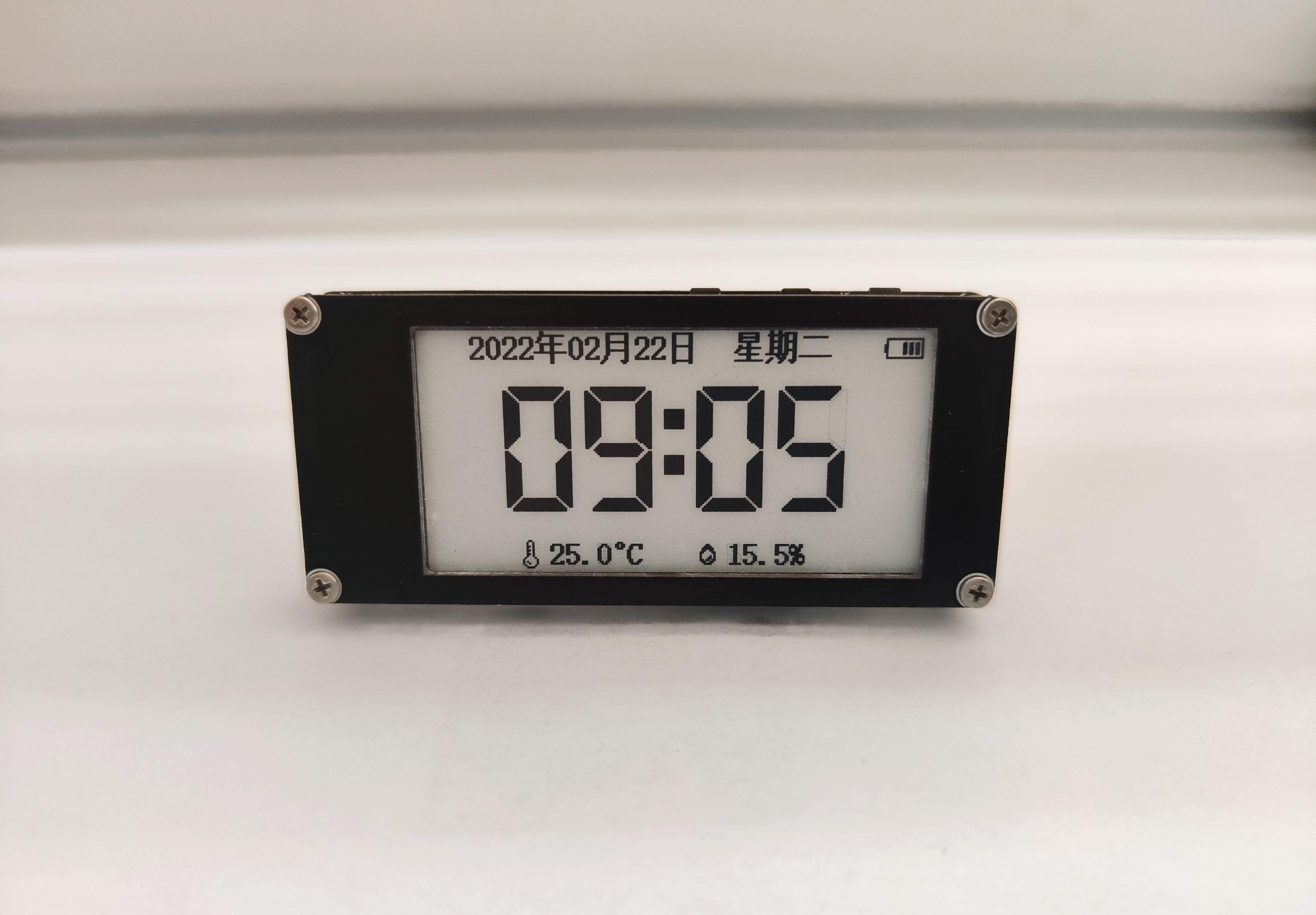

Introduction:
The idea for this work comes from DUCK's ink screen clock, which was completed in October last year. Original open source link ink screen clock 2.0 - Lichuang EDA open source hardware platform (oshwhub.com)
After more than 4 months of stable testing and bug fixes, it is now open source. For communication purposes. To prevent profiteers from selling software, only firmware is provided and needs to be activated for use. Join the group 215204131 and contact the group owner to provide PCB photos and Lichuang account name to activate .
Using RX8025T clock chip. And SHT30 high-precision temperature and humidity sensor or replaceable temperature and humidity sensor in the same package. The sleep power consumption is 3 ua. The time, temperature and humidity are refreshed every minute when waking up. Brush everything every night at 0 o'clock. The power consumption is about 1maH per day. Theoretically, the CR2032 battery can be used for 200 days, and the CR2450 battery can be used for 600 days (it is recommended to purchase high-quality batteries based on the actual quality of the battery).

Front rendering
Front rendering
Back rendering
Back rendering

Production notes:
1. You need to put a layer of tape on the back of the screen cable, otherwise the thickness will not be enough.
2. All component sizes are subject to silk screen printing
3. Do not power off or reset during the activation process, otherwise the activation code will be modified. If the device is sleeping, just press the setting button to wake it up.
It is recommended to make a 2032 battery version which looks better.
PCB board thickness is 1mm.
If you don’t want to make it, you can go to a certain fish to buy the finished product and search for the 2.13-inch ink screen clock.
Use sbw mode to download the program. If you need to use BSL to download, please modify the circuit to lead to other pins.
Download software and firmware are placed in the attachment.
