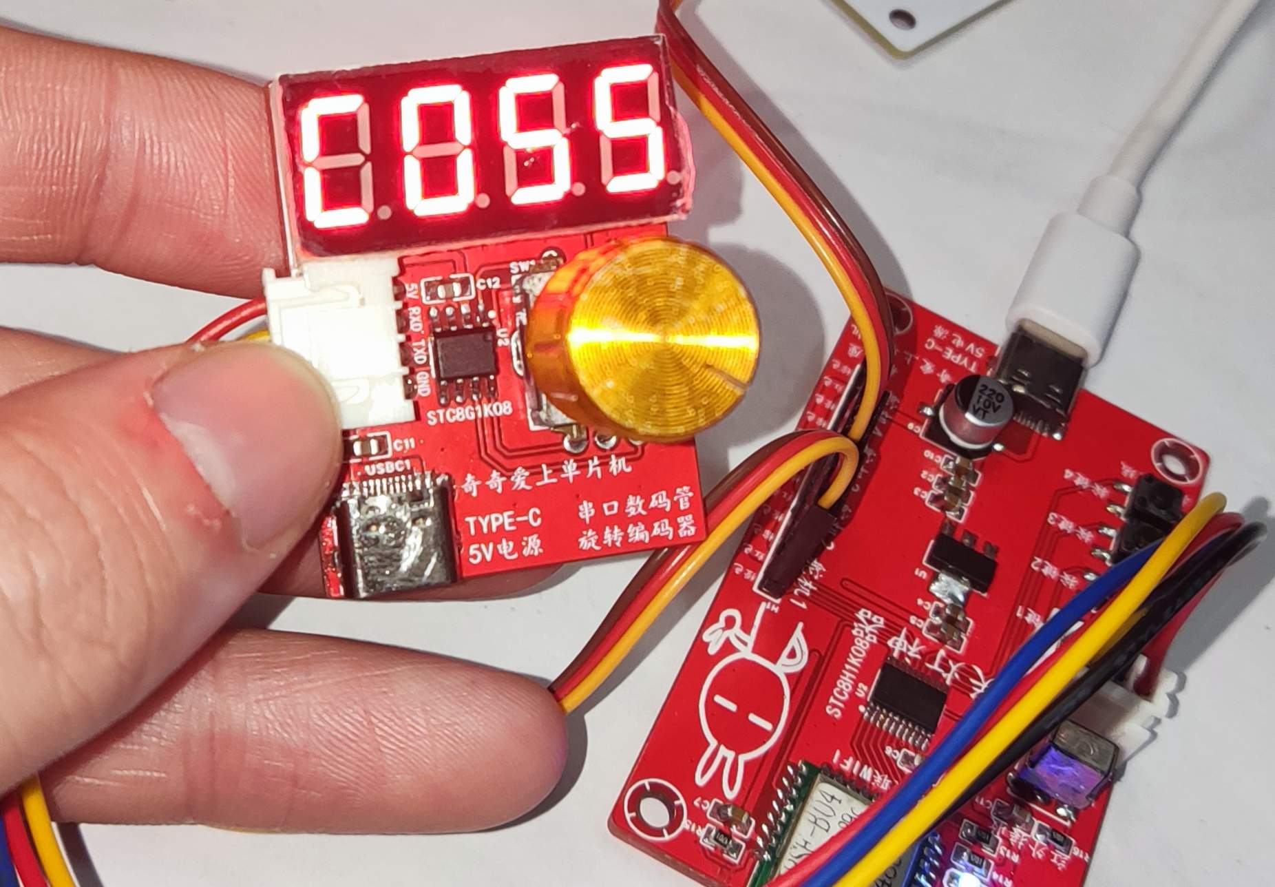

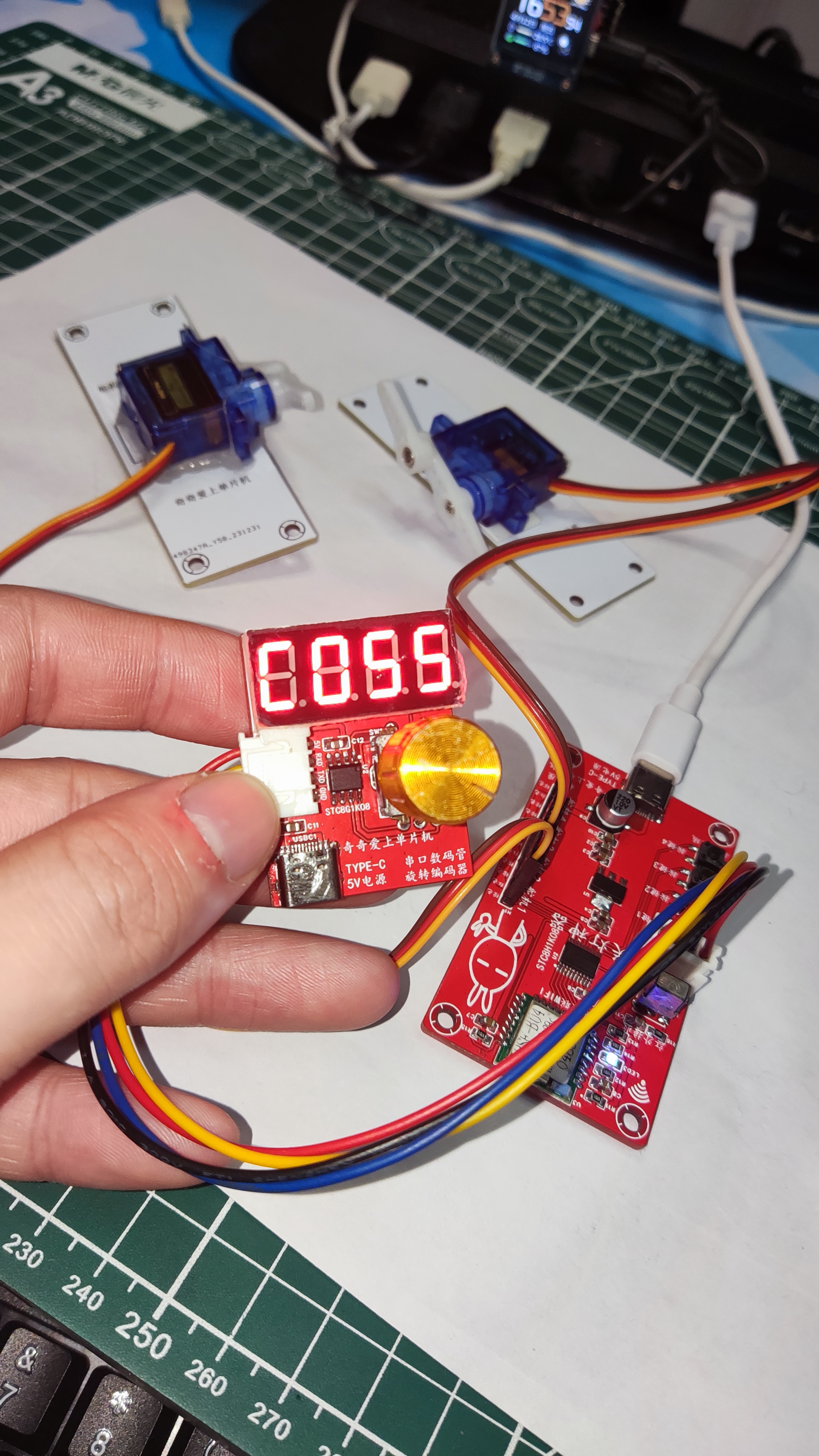

Digital tube rotary encoder
Real-time adjustment of the servo angle of the Yiweilian light switch via serial port. This is a video demonstration of controlling it. [https://oshwhub.com/liujianqi1688/dan-pian-ji-guan-deng-shen-qi-lan-ren-kai-guan](https://oshwhub.com/liujianqi1688/dan-pian-ji-guan-deng-shen-qi-lan-ren-kai-guan
) The program can be downloaded directly (latest optimization as of November 20, 2024; one servo can be adjusted to three angles, highly recommended).
Below are the parameters for two servos installed on either side of the switch panel for on and off (for reference only). The angle can be fine-tuned according to the site conditions.
//The source code and PCB for the above work are publicly available. Search for the username "奇奇爱上单片机" on the "LCSC Open Source Hardware Platform".
//Microcontroller model: STC8G1K08 //1. When burning the program, be sure to select built-in IRC=30MHz. //2. Change the IRC debugging mode to "Do not adjust, use the internal preset frequency". //2. Set the reset pin to the IO port. //3. Uncheck "Erase user EEPROM area when downloading user program".
