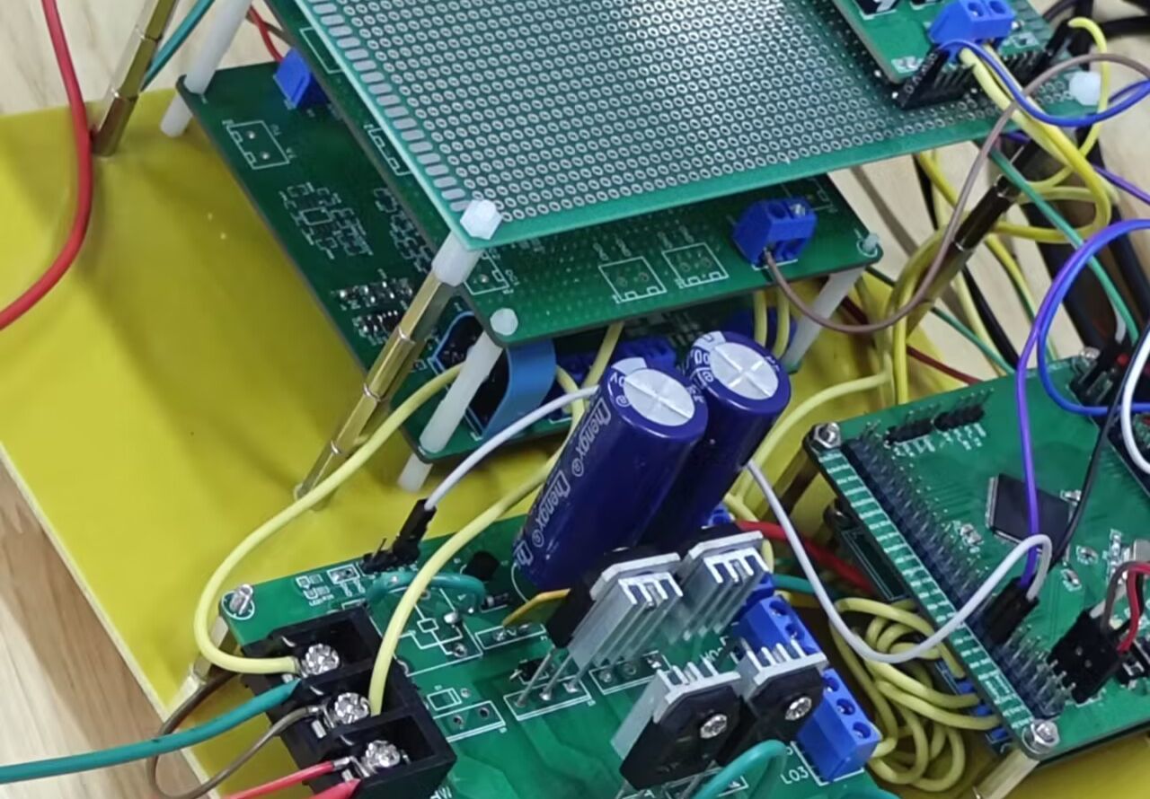

2023 National Electronic Design Contest - Single Item: Inverter Parallel System
The project was submitted for the competition in August 2023 and was subsequently collected by the school. Therefore, the physical prototype cannot be reproduced .
I was responsible for the software during the competition, so this section will mainly describe the software-related content in detail
. The software development platform was CubeIDE, and the hardware development platform was JLCPCB Professional Edition.
The software analysis includes
a minimum system board pinout diagram.
The core of the software part uses the output of the SPWM to control the switching transistors to achieve a full-bridge inverter. The SPWM is output through the microcontroller's advanced timer. To output the SPWM, a sine wave meter is needed, and the duty cycle of the advanced timer's PWM output is adjusted using the timer. By adjusting the SPWM modulation ratio, the amplitude of the final inverted voltage can be controlled. We can use hardware to proportionally reduce the inverted AC voltage and add a DC bias. Finally, the inverted AC power can be acquired by the microcontroller's ADC. The actual inverted result is calculated and corrected. Here, a professional instrument is needed to correct the coefficients. This coefficient is crucial; to achieve the accuracy required for the competition, the coefficients must be correctly corrected. Then, a PI controller is used to dynamically control the amplitude required for the competition. To accurately control ADC acquisition and reproduce inverter results,
the ADC is configured with right-aligned data, scan mode, timer-triggered, and DMA used to transfer ADC acquisition data to improve efficiency. Timers are frequently used. Advanced timers output complementary SPWM, while ordinary timers implement microsecond (µs) delays. Timers can be used to implement sinusoidal duty cycles at 20kHz. Note that the operating frequencies of the STM32F407VET6 timers differ, as shown in the figure. When a timer interrupt occurs (timer 3 (htim3), a series of operations are executed: if (htim == &htim3) { /* * DC input voltage and current */ DC_U[Index_adc1] = 3.3f * ADC1_Value_DMA[2 * Index_adc1] / 4096; DC_I[Index_adc1] = 3.3f * ADC1_Value_DMA[2 * Index_adc1 + 1] / 4096; // arm_mean_f32(DC_U,400,&Udc_avg); DC_U[Index_adc1] = (DC_U[Index_adc1] >= 2.7)?2.7:DC_U[Index_adc1];//DC voltage limit maximum value DC_I[Index_adc1] = (DC_I[Index_adc1] >= 1.8)?1.8:DC_I[Index_adc1];//DC current limit maximum value Udc_temp += DC_U[Index_adc1]; Idc_temp += DC_I[Index_adc1]; if(Index_adc1 == 399){ Cycle++; if(Cycle == 3) Cycle_T = 1; Udc_avg = Udc_temp / 400 * UdC_K; Idc_avg = Idc_temp / 400 * IdC_K; Udc_temp = 0; Idc_temp = 0; } if (Udc_avg >= 60 || Idc_avg >= 10) { SD1(0); SD2(0); SD3(0); SD4(0); RedLed_on; } /* * Inverter current and voltage */ AC_U[Index_adc2] = 3.3f * ADC2_Value_DMA[2 * Index_adc2] / 4096; AC_I[Index_adc2] = 3.3f * ADC2_Value_DMA[2 * Index_adc2 + 1] / 4096; AC_U[Index_adc2] = (AC_U[Index_adc2] >= 2.52)?2.52:AC_U[Index_adc2];//Inverter voltage limit maximum value AC_U[Index_adc2] = (AC_U[Index_adc2] <= 1)?1:AC_U[Index_adc2];//Minimum inverter voltage limit AC_I[Index_adc2] = (AC_I[Index_adc2] <= 0.16683)?0.16683:AC_I[Index_adc2];//Minimum inverter current limit Uac_temp += AC_U[Index_adc2]; Iac_temp += AC_I[Index_adc2]; if(Cycle_T == 1){ AC_U_dc[Index_adc2] = (AC_U[Index_adc2] - Uac_avg) * UAC_K; AC_I_dc[Index_adc2] = (AC_I[Index_adc2] - Iac_avg) * IAC_K; RMS_Uac_U_temp += AC_U_dc[Index_adc2] * AC_U_dc[Index_adc2]; RMS_Uac_I_temp += AC_I_dc[Index_adc2] * AC_I_dc[Index_adc2]; }

First, the DC input voltage and current values ​​are extracted from the ADC data and clipped. Then they are accumulated into the corresponding variables, and the average value of the DC input voltage and current is calculated based on the accumulated values.
Next, the inverter voltage and current values ​​are extracted from the ADC data and clipped. Then they are accumulated into the corresponding variables, and the effective value (RMS value) of the inverter voltage and current, as well as the deviation of the inverter voltage from the average value, are calculated.
Finally, the grid voltage value is extracted from the ADC data and clipped. These values ​​are then accumulated into the corresponding variables, and the effective value (RMS value) of the grid voltage and its deviation from a reference value are calculated.
The index is updated for the next data acquisition.

The following is the design report submitted during the competition .
Design Report
Summary:
This work is based on the SPWM wave inverter principle. Through monitoring and control circuits, when a DC power supply is input, the circuit performs DC-AC conversion. The main circuit structure of this work is an H-bridge structure composed of IR2104S driven by the SPWM wave and IGBTs, which is used to realize the detection circuit structure for controlling the output voltage. The inverter circuit as a whole is powered by a DC power supply, which in turn powers an auxiliary power supply, which in turn powers the microcontroller, driver chip, and detection circuit. The first part reduces THD by adjusting the SPWM wave carrier frequency and the LC filter circuit.
The second part samples the AC voltage through a voltage transformer, amplifies it through an operational amplifier circuit, and inputs it to a microcontroller via an adder. The data is then processed, the modulation ratio is changed, and the output voltage is stabilized, reducing the load regulation rate.
Keywords: SPWM inverter, H-bridge, STM32, voltage transformer, modulation ratio, IR2104S

The output circuit uses a full-bridge inverter controlled by four IGBTs, followed by LC circuit filtering. The four IGBTs are driven by two IR2104S filters, enabling rapid switching, easy adjustment, and more precise waveform control using SPWM. Since a 50Hz sine wave is required, a low-pass filter needs to be designed. An LC filter is used, with the cutoff frequency calculated as f = 1 / 2π√LC. We decided to use a 500uH inductor (L) and a parallel connection of a 22uF and a 10uF capacitor (C). The calculated cutoff frequency is 1258Hz, resulting in a sine wave with low distortion.
III.
3.1 System Overall Block Diagram Figure
3.2 Inverter Topology
Figure 2 Inverter Topology Circuit Diagram
3.4 Detection Circuit The AC
voltage sampling circuit uses a ZMPT101B to sense the voltage, and the AC current uses a ZMCT103C to sense the AC current. The signals are input to the microcontroller via an arithmetic circuit and an adder circuit. The bias voltage signal is provided by a REF3318, providing a constant 1.8V DC signal. The operational amplifier is a TLC2272 low-noise operational amplifier. The microcontroller collects the data, subtracts the DC bias, and multiplies by the amplification factor to obtain the effective value of the AC voltage. The DC voltage is acquired using a resistor divider, and the input is fed to the microcontroller in the same direction. The DC current is detected using a low-side differential amplifier circuit.
3.5 Program Design
The core software uses the output of the SPWM to control the switching transistors to realize a full-bridge inverter. SPWM (Sinusoidal Pulse Width Modulation) is a mature and widely used technology. It is based on the principle of area equivalence, meaning that narrow pulses with equal impulse but different shapes applied to an inertial element produce essentially the same effect.1 SPWM inversion is a mature technology; both unipolar and bipolar inversion rely on SPWM modulation. For H-bridge full-bridge inversion, bipolar SPWM inversion is used.2 The microcontroller can output PWM via TIM. In the program, a sine table can be generated by calculating ARR and modulation ratio, and then the SPWM can be implemented by looking up the table. PWM events are used to trigger interrupts and update the next CCR value.
Secondly, screen information interaction is implemented on the controller MCU, enabling real-time response to screen input and output operations. This means that on-screen information interaction can receive rapid feedback after user input, providing a better user experience. The screen UI and its information interaction keys are designed through serial port screen host computer software, and some parameters are displayed or set through communication with the microcontroller via serial port.
To control the stability of the inverter voltage, the software collects instantaneous values ​​of DC input voltage, current signal, inverter voltage, current, and grid voltage signal, calculates effective values, and performs coordinated open-loop and closed-loop control to achieve inverter voltage stability and closed-loop control.
