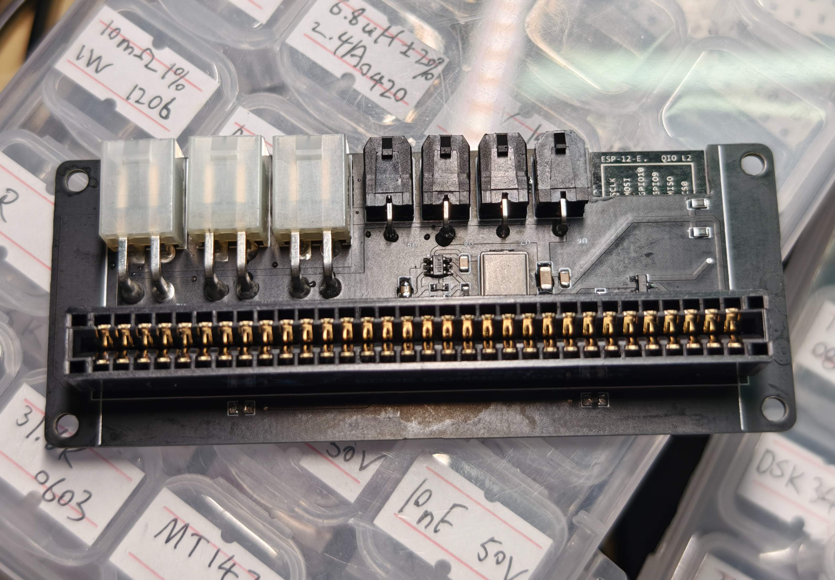

[wuyu speechless] Huawei 460W CSPS Power Supply ESP8266 Smart Power Supply Board 2
This is the revised version: https://oshwhub.com/wuyu233/wuyu-huawei-460w-csps-esp8266-zhi-neng-qu-dian-ban
The antenna faces outwards, and there are
four MX3.0 1*2p interfaces and
three 5557 2*2p interfaces cut out at the bottom.
The two MX3.0 interfaces closest to the module are low-power 12V, and the maximum total power of the two ports cannot exceed 30W, and they are not affected by the main 12V power supply.

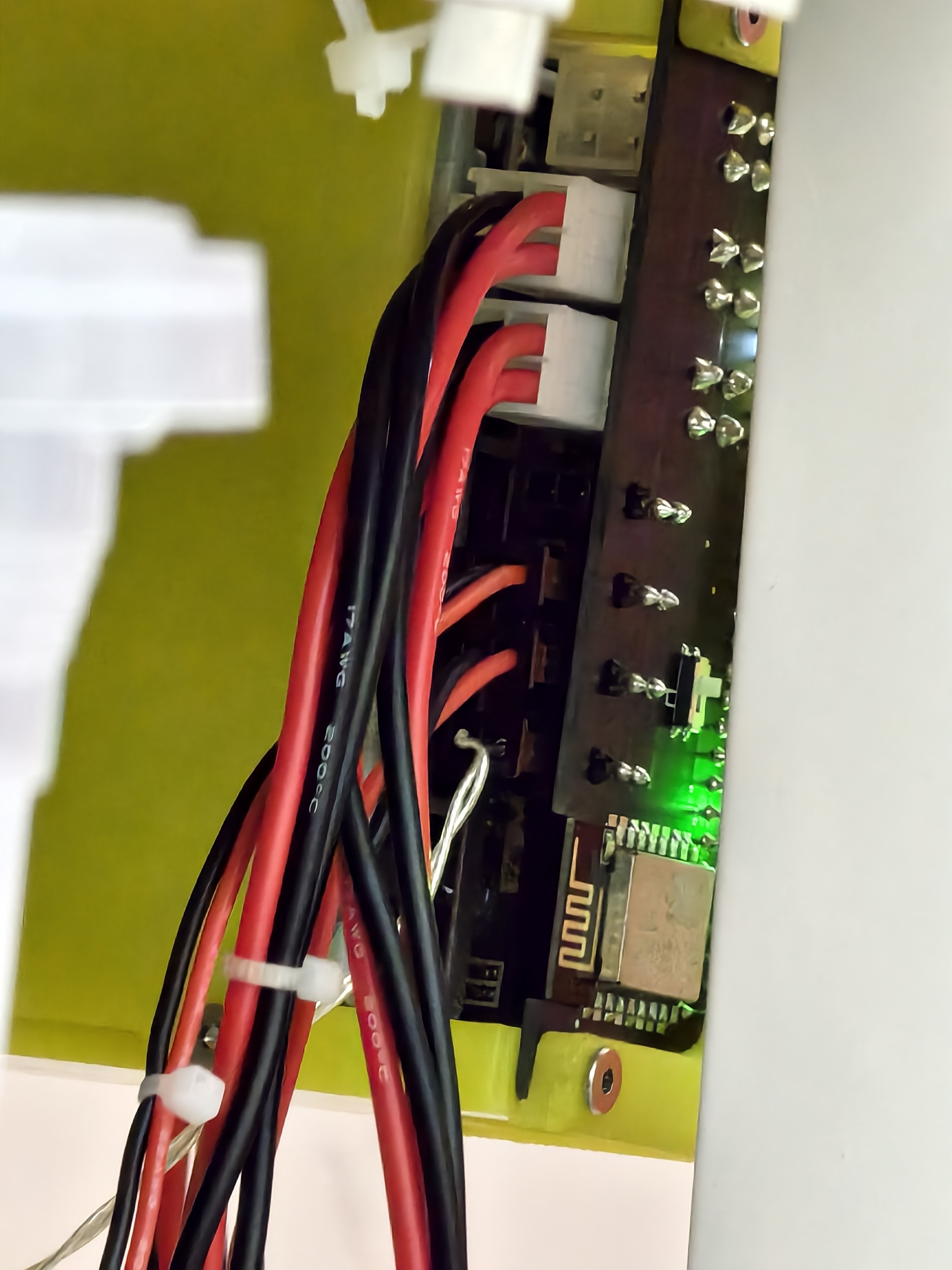

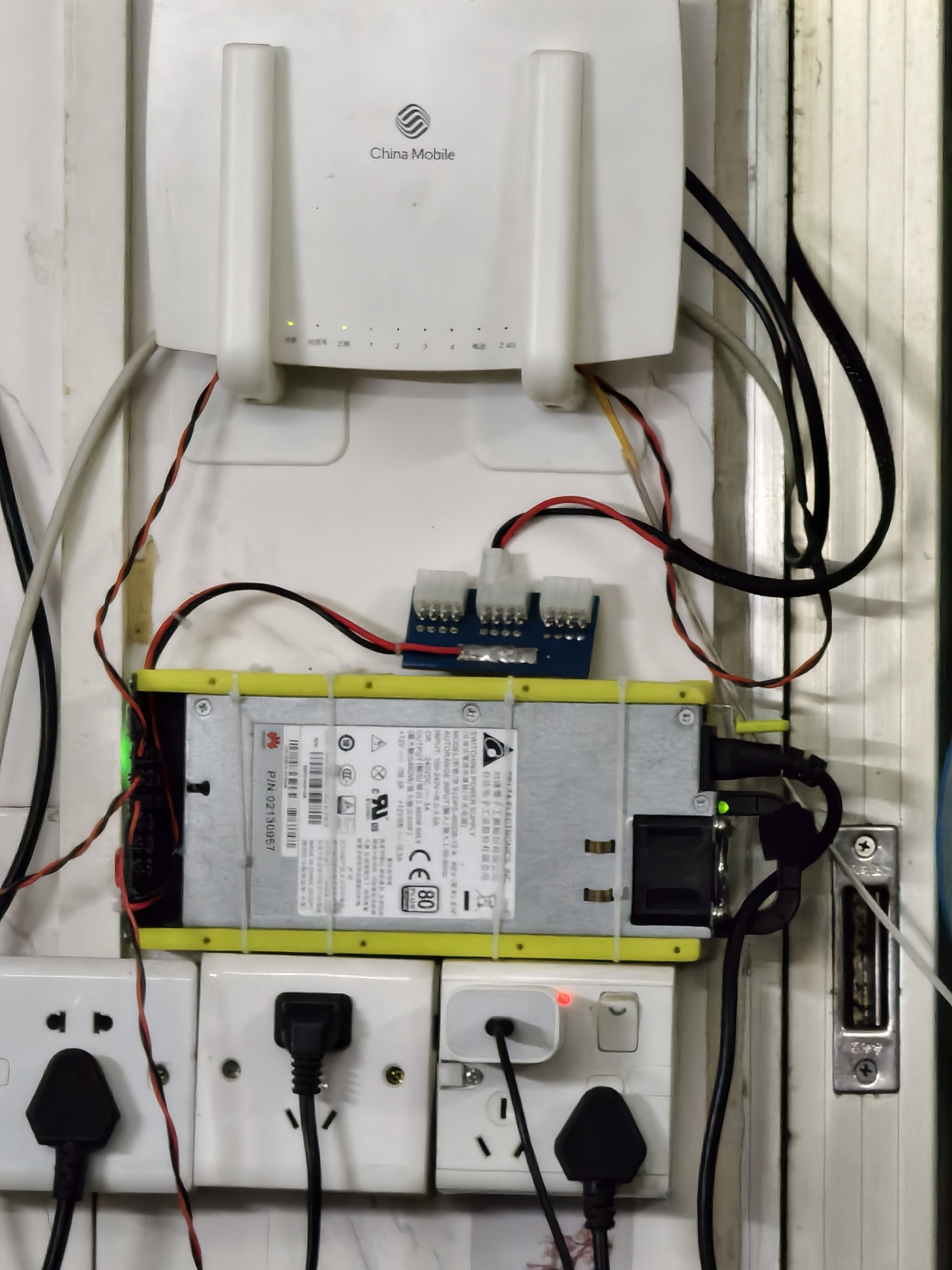

My purpose is to centrally power
two low-power ports, one for the optical modem and one for the router. A
pre-compiled bin format firmware is provided; the source code and shell are in the previous project.

After powering on the module, it will automatically open a hotspot named "CSPS Network Configuration" after a few minutes.
After connecting with a mobile phone, it will automatically redirect to the network configuration interface. To connect to your home WiFi, you
can manually add it in Home Assistant or wait for automatic discovery and pairing.
