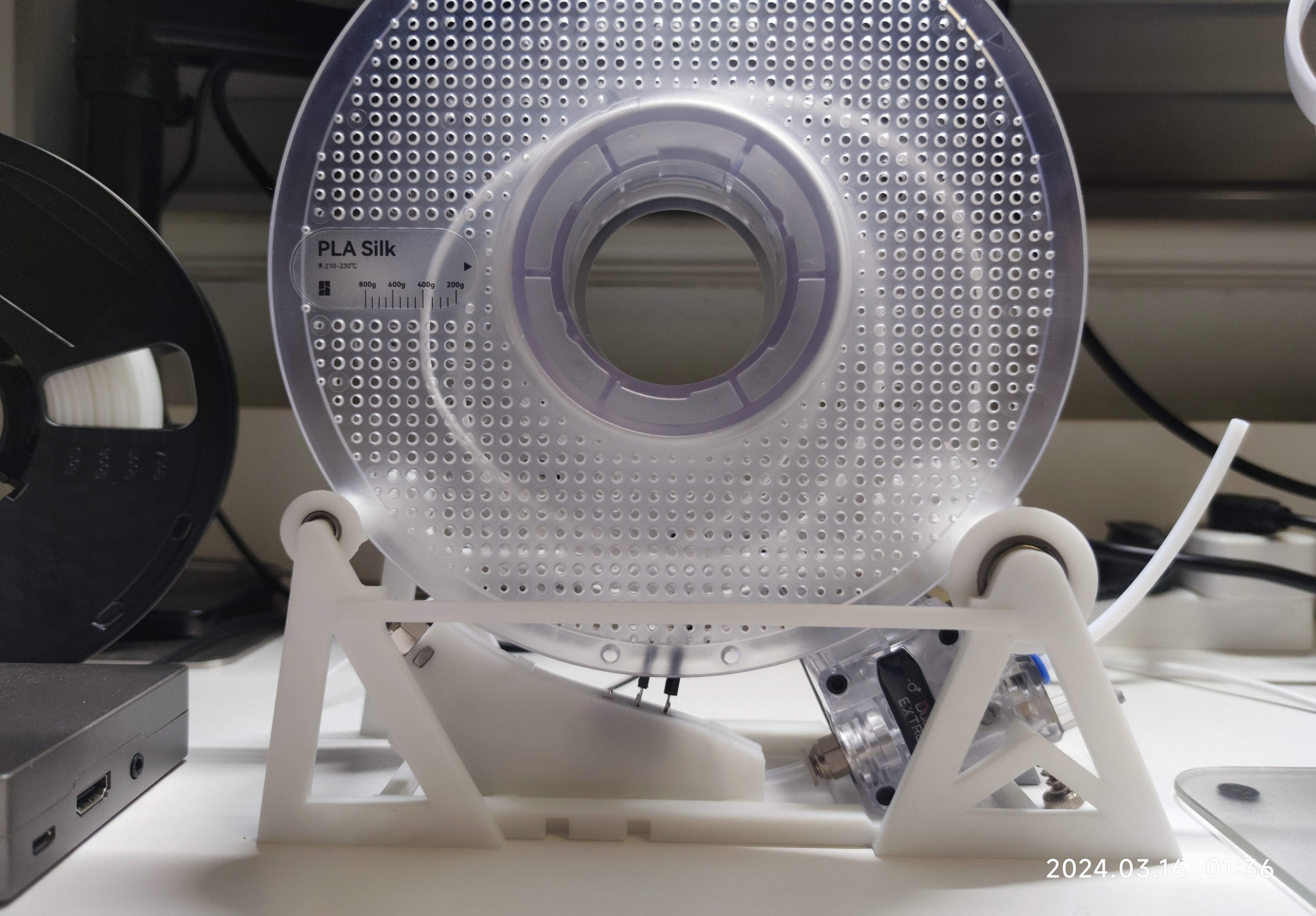

YBA-AMS
CH connects to the motor; the pin marked with a down arrow (⬇) connects to the bottom of the motor.
SW connects to the common and middle pins of the microswitch; U is the top pin, D is the bottom pin, pin distinction is not important.
M connects to the manual switch; + is for feeding, - is for unloading. When using
the DRV8833 motor drive module with the bottom facing up and
powered by the microcontroller's 5V interface, the bottom 5V-VCC needs to be shorted. In this case, there is no need to solder the step-down module to the DC socket.
All connectors are 2.54mm; you can choose according to your personal preference
. ![IMG_20240324_221757.jpg]
