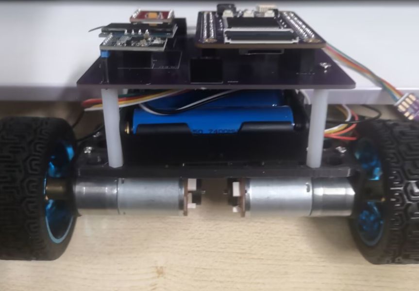

A balancing car is produced based on the development board of Lichuang Liangshan School. The main control core is GD32F470ZGT6. Adopting modular design and welded power strip, it is convenient and easy to maintain. The base plate can be externally connected to ultrasonic modules, Bluetooth modules, OLED displays, etc.
The PID has not yet been mastered. The car can currently run, but it cannot maintain balance (sad

## 3. Physical display
![238BFD61062146AE78274A3729FACB34.jpg] ![079BDFC5B4D10BE37D85555D584ED04E.jpg] ![D3202CD4B27A13A7ACE98B46CBB196AB.jpg]
