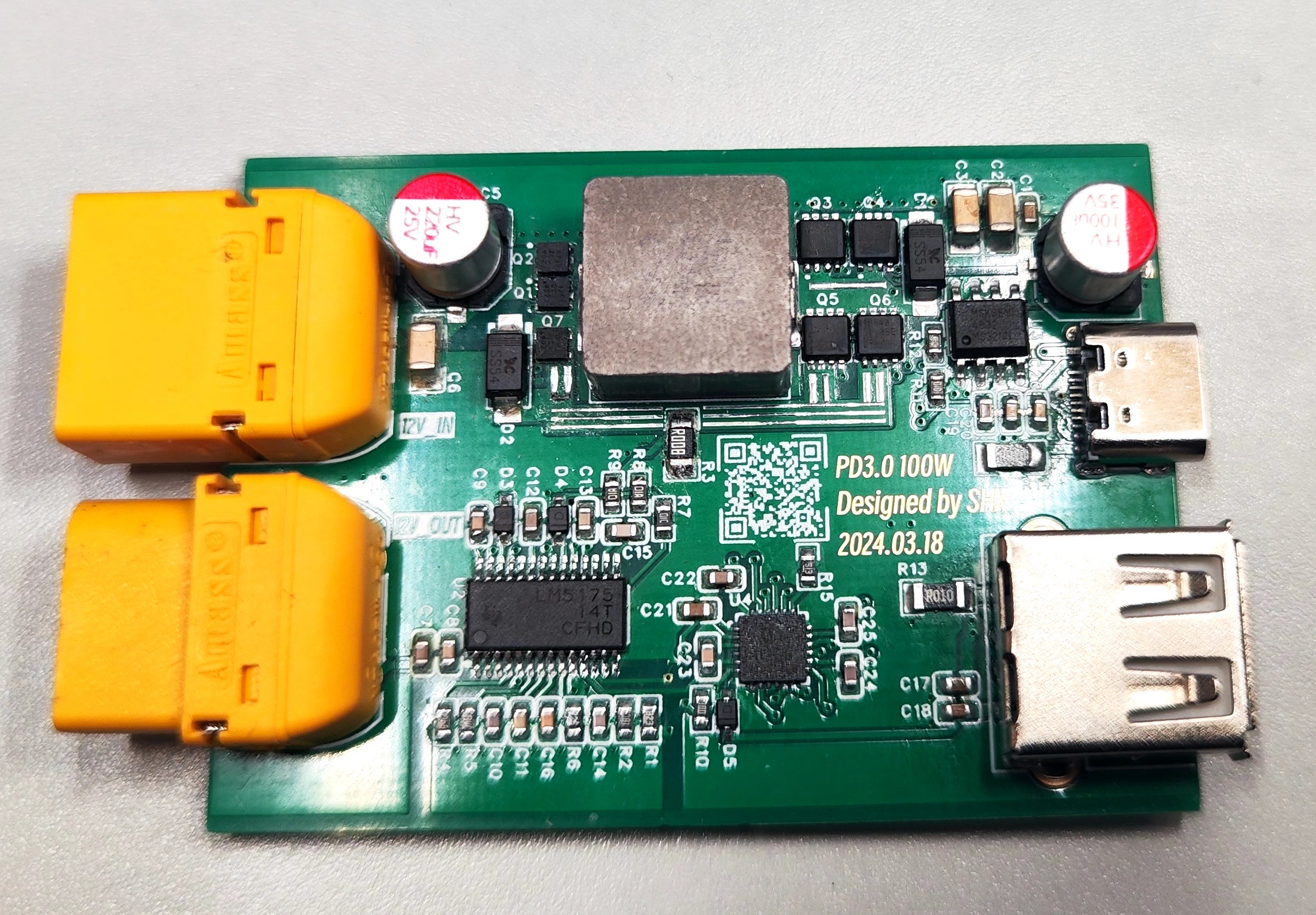

Desktop Power Station - PD3.0 100W Step-Up/Step-Down Charging Station
The Desktop Power Station - PD3.0 100W Buck-Boost Charging Station
features two XT60 modules, one male and one female, supporting multiple modules in series.

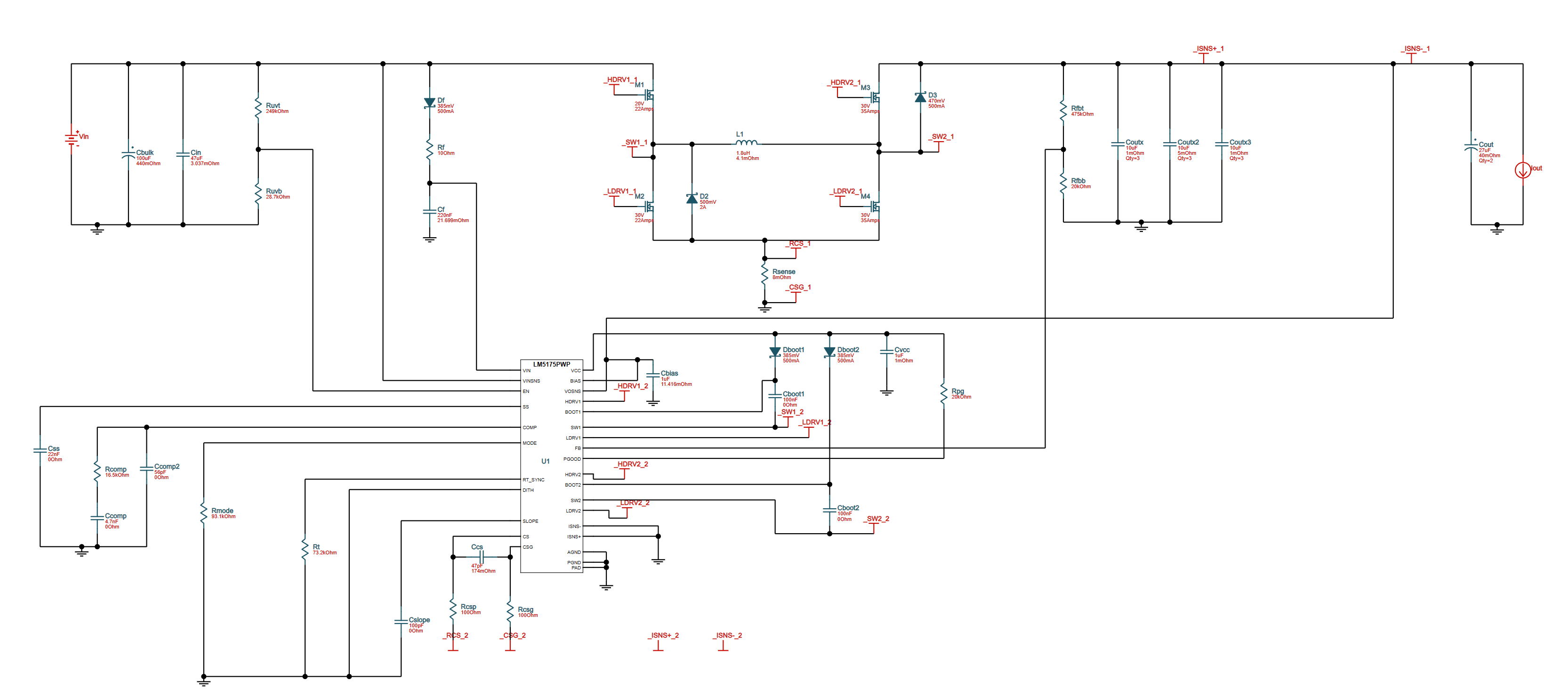

It uses an LM5175+IP2726 solution
, with the buck-boost section designed by TI Webench Power Design, achieving a theoretical peak efficiency of up to 97% in simulations
. It perfectly matches the aluminum profile housing found on Taobao, providing robust heat dissipation and protection. [Link to product :
https://item.taobao.com/item.htm?id=37894858237 ] [

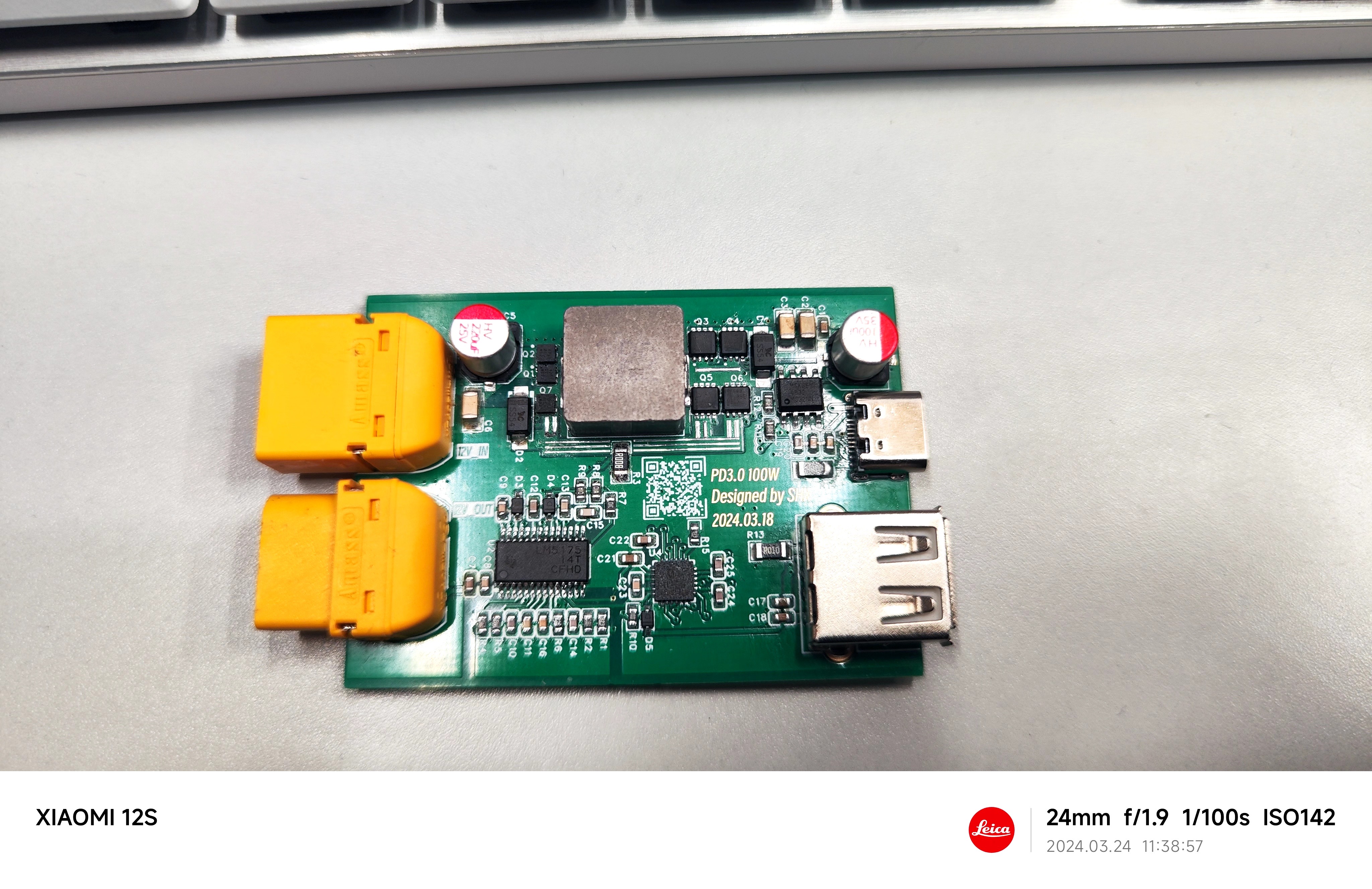

Image of the actual product follows]
