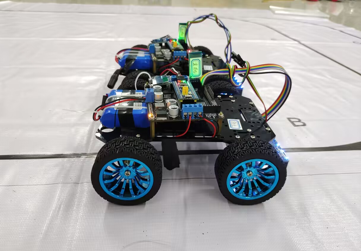

[2023 Electronic Design Contest] Intelligent Car Design
Test code is attached.
Contact the author via QQ: 2456640595.
The design includes:
1. Independent DC-DC regulator module (capable of outputting 3.3V, 5V, and ADJ adjustable output)
2. Car main control board (onboard DC-DC regulator, 16-25V input, step-down to 5V and 8V)
3. STM32 minimum system board (same size as commonly available STM32 minimum system boards, can be directly replaced)

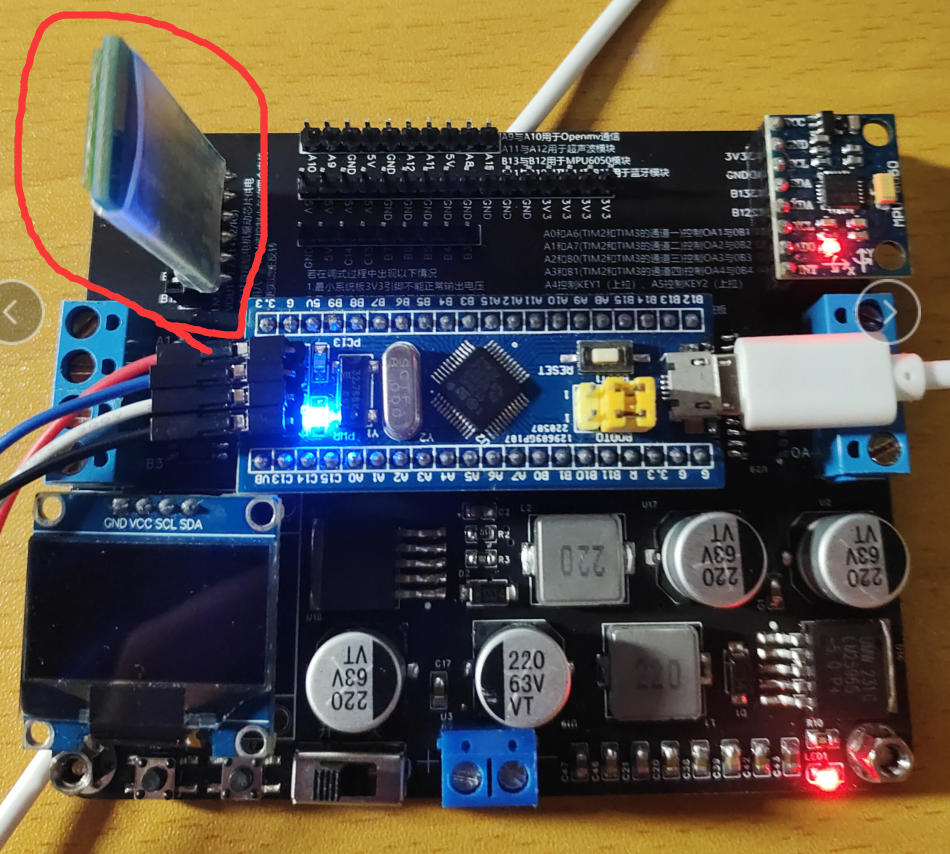

Please note: There was an error on the author's board, namely, the silkscreen of the Bluetooth module was reversed. It has now been corrected; simply plug in the Bluetooth module as shown in the picture.

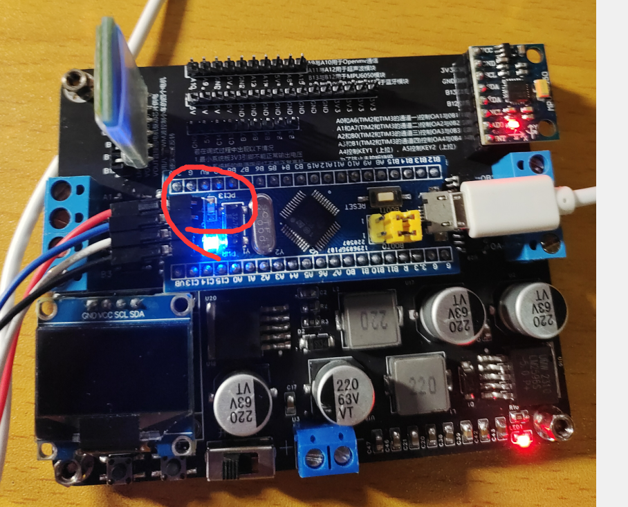

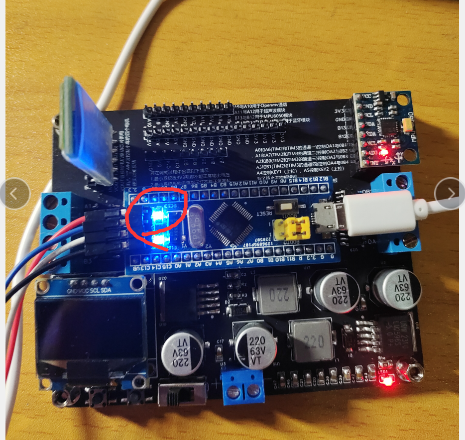

1. The effect after soldering and connecting the download and USB cables is shown below:
2. Test whether the car's Bluetooth module functions normally.

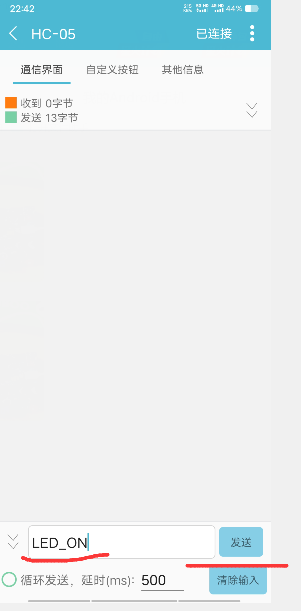

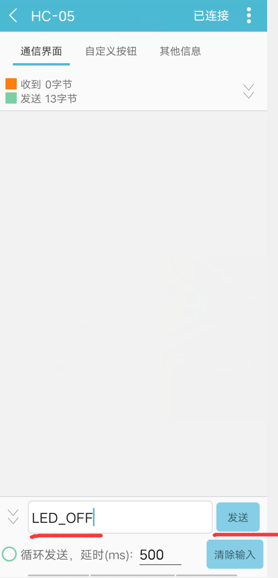

Expected experimental effect:
After the mobile phone sends the string "LED_OFF" through the Bluetooth assistant, the onboard LED of the STM32 minimum system board will turn off.
After sending the string "LED_ON", the onboard LED of the STM32 minimum system board lights up.
Test result:

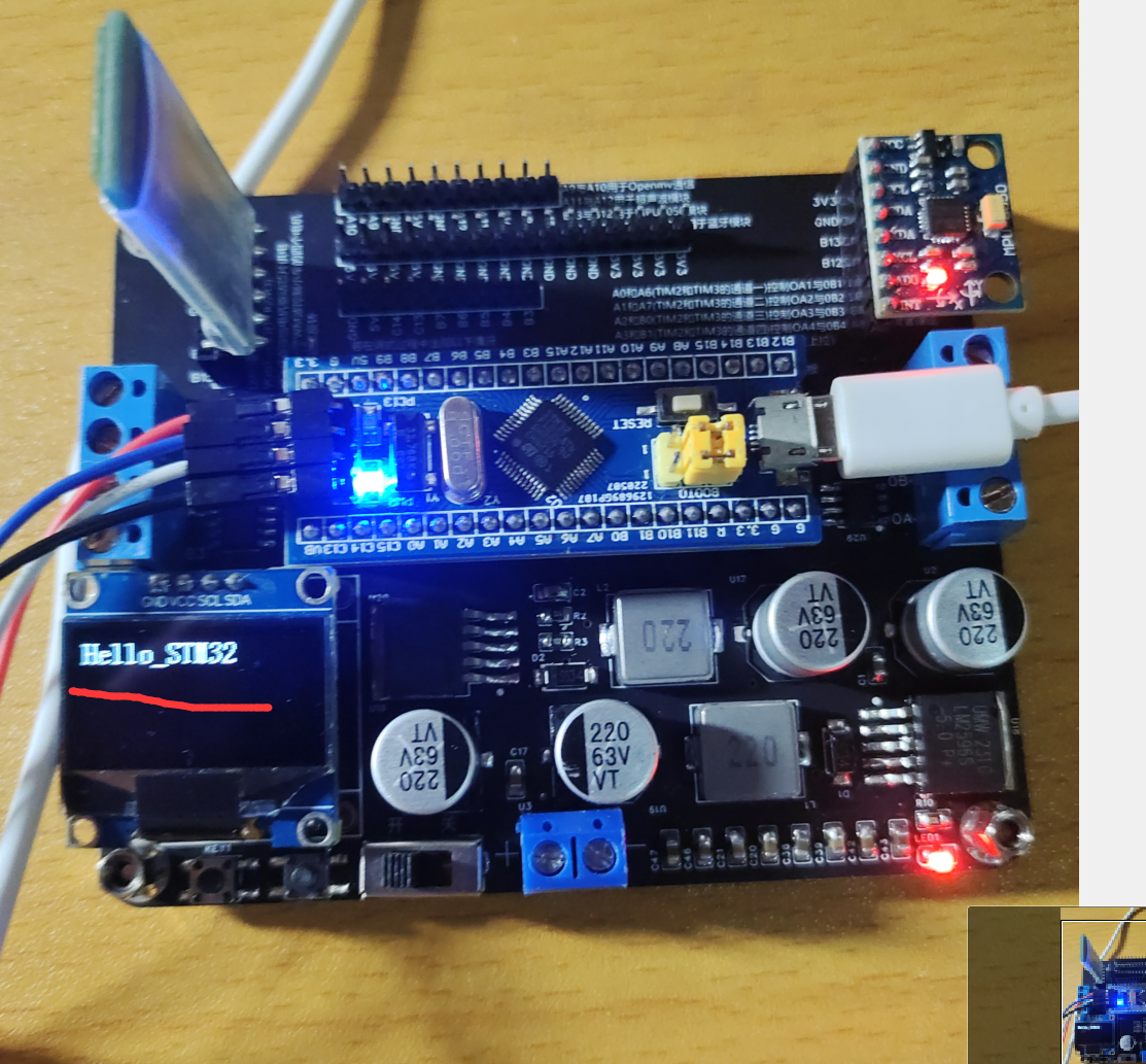

3. Test whether the onboard OLED screen display function is normal
. After programming the code, the OLED screen displays "Hello_STM32".
Test result:

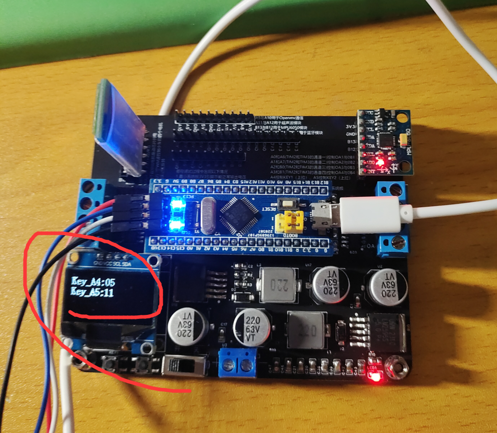

4. Test the onboard buttons
. After programming the code, the OLED screen displays the number of times each button is pressed.
Test result:

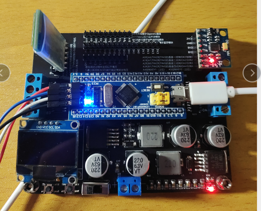

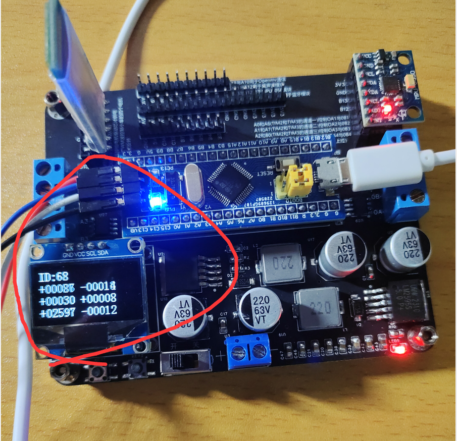

5. Test read the onboard MPU6050 data .
After programming the code, the OLED screen displays the MPU6050 data.
Note: Because the code does not perform any data filtering, the data is unstable.
