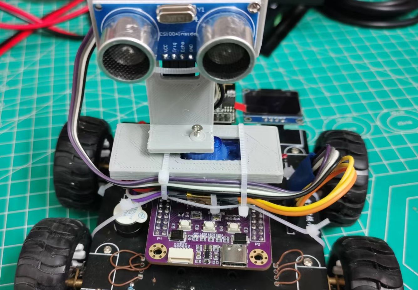

Project Introduction
and Functionality:
This project is a WiFi car built on the Liangshanpai development board. The car can be controlled by connecting to the WiFi network on the car (forward, backward, left turn, right turn). If there is an obstacle in front of the car while it is moving forward, it will automatically stop.
Hardware Circuit Introduction
(1) Power Supply Section: HE6250MPR is used for voltage conversion to convert the 7V input from the battery to 5V for the development board. The specific circuit is as follows.
(2) OLED Display Section: A 0.96-inch 4-pin OLED is used, and IIC is used for communication. When drawing the schematic, remember to add 4.7k pull-up resistors to the SDL and SCK pins. The specific circuit is as follows.
(3) ESP8266 Section: It can be directly connected to the UART of the development board. The specific circuit is as follows.
(4) Ultrasonic Section: It can be directly connected to the development board. The specific circuit is as follows.
(5) Servo Section: It can be directly connected to the development board. The specific circuit is as follows.
(6) Buzzer Section: It needs to be driven by a transistor. The specific circuit is as follows.
(7) Motor Drive Section: The LCSC Liangshanpai Open Source Car is referenced. The reference circuit is as follows.
