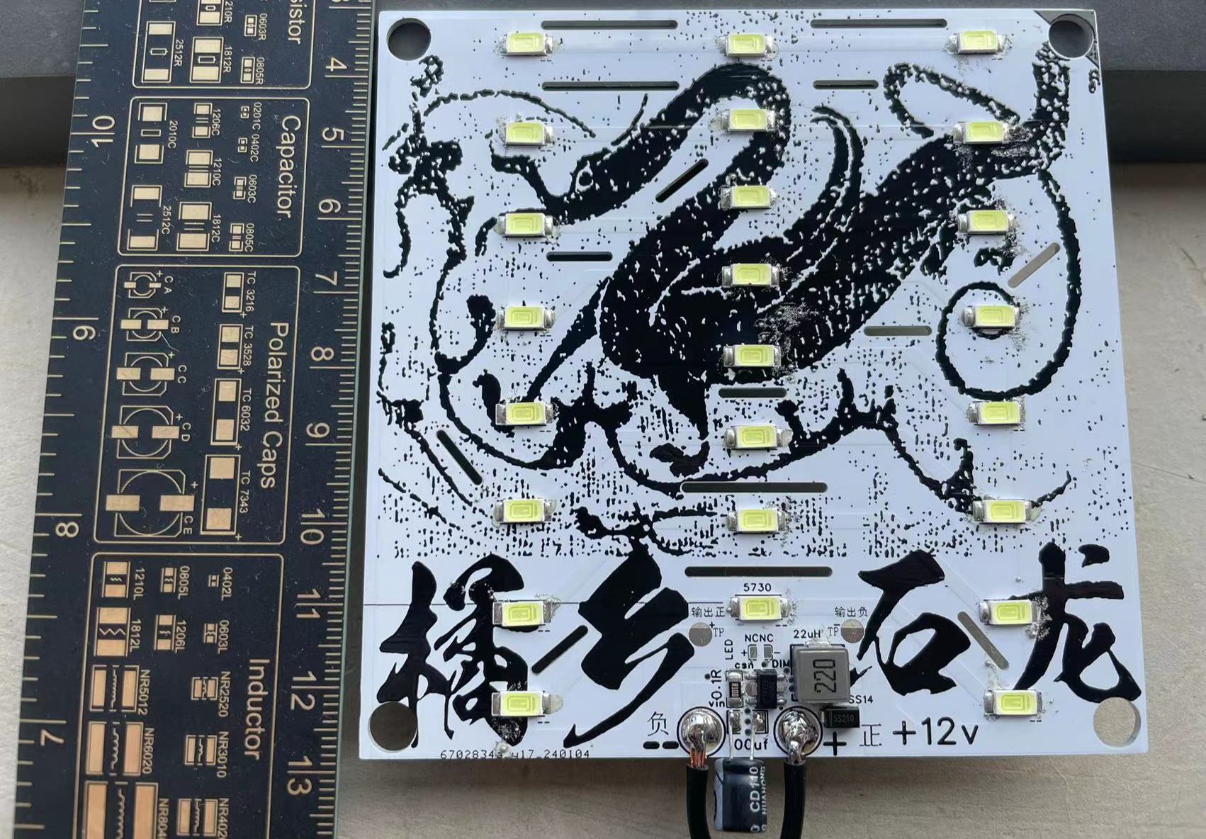

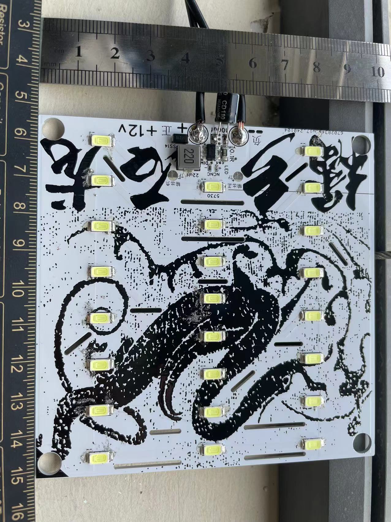

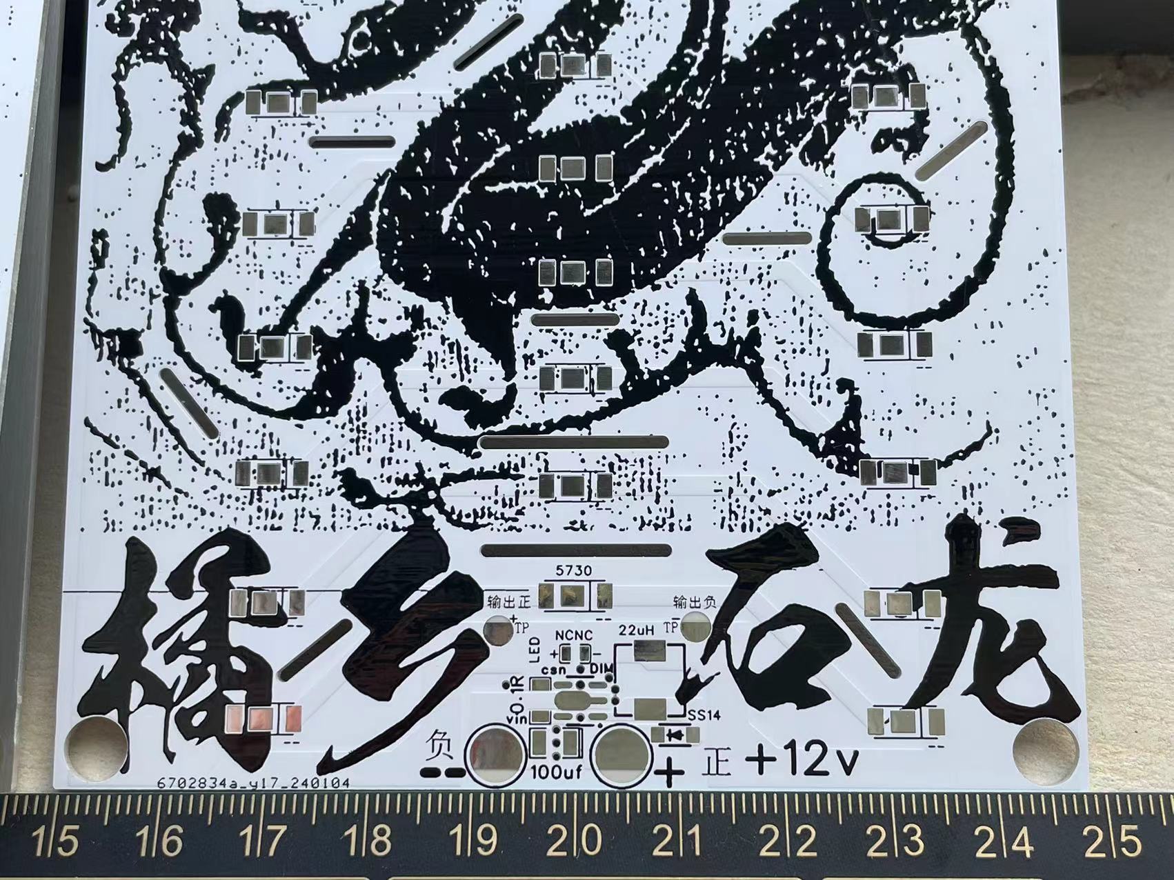

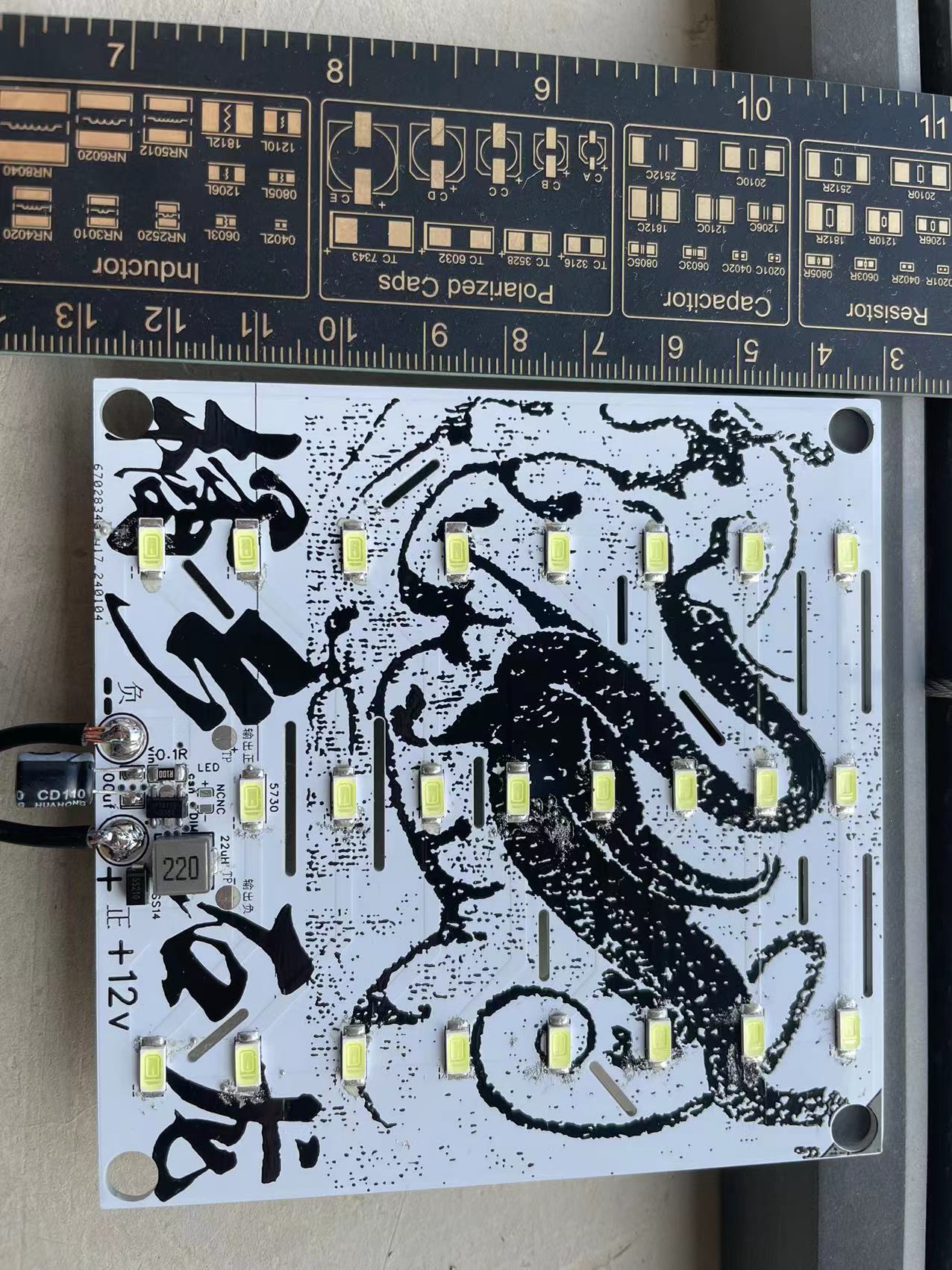

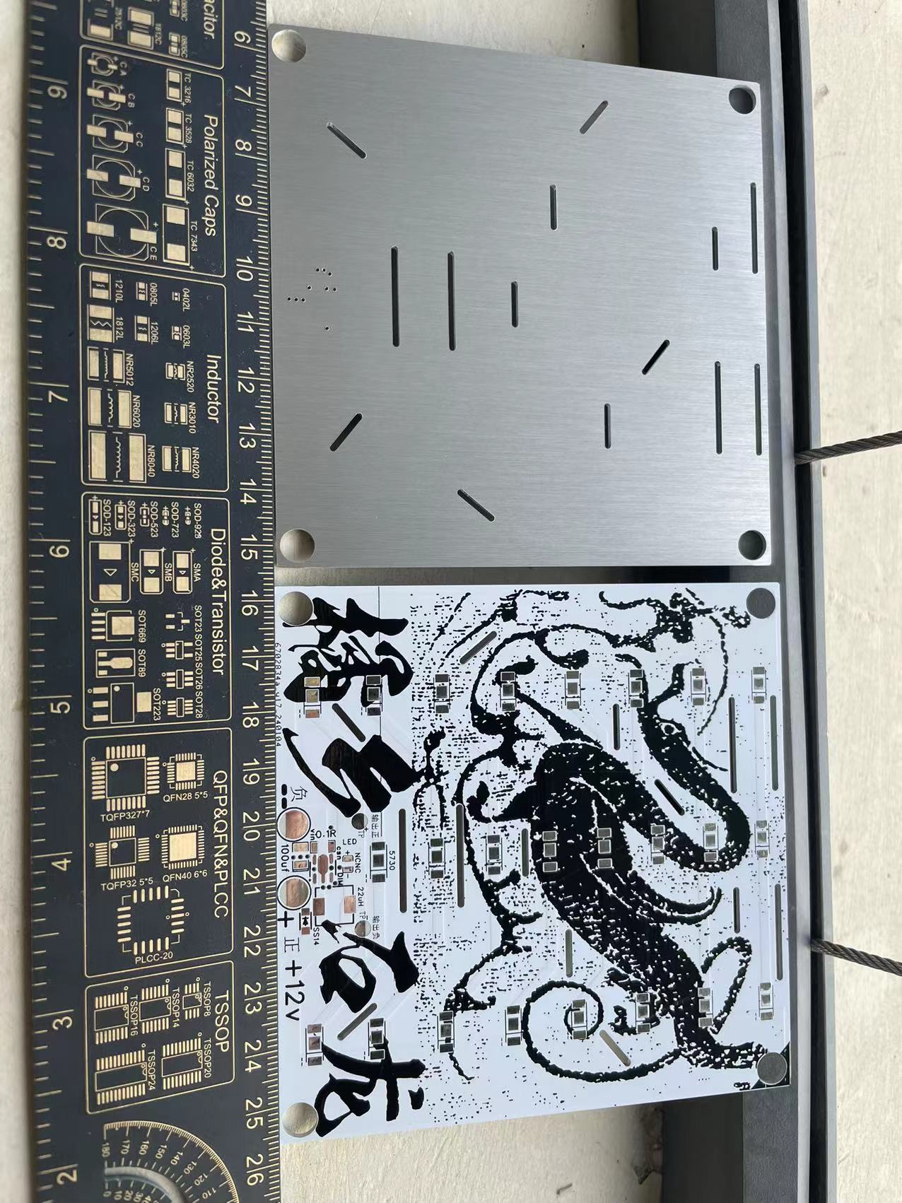

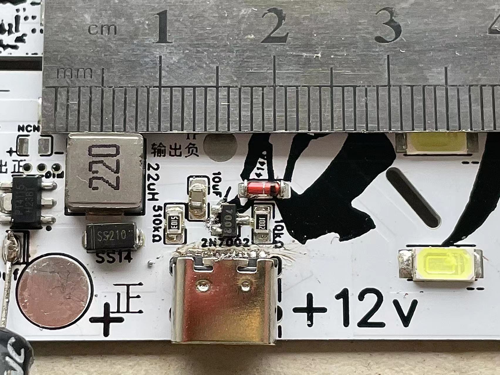

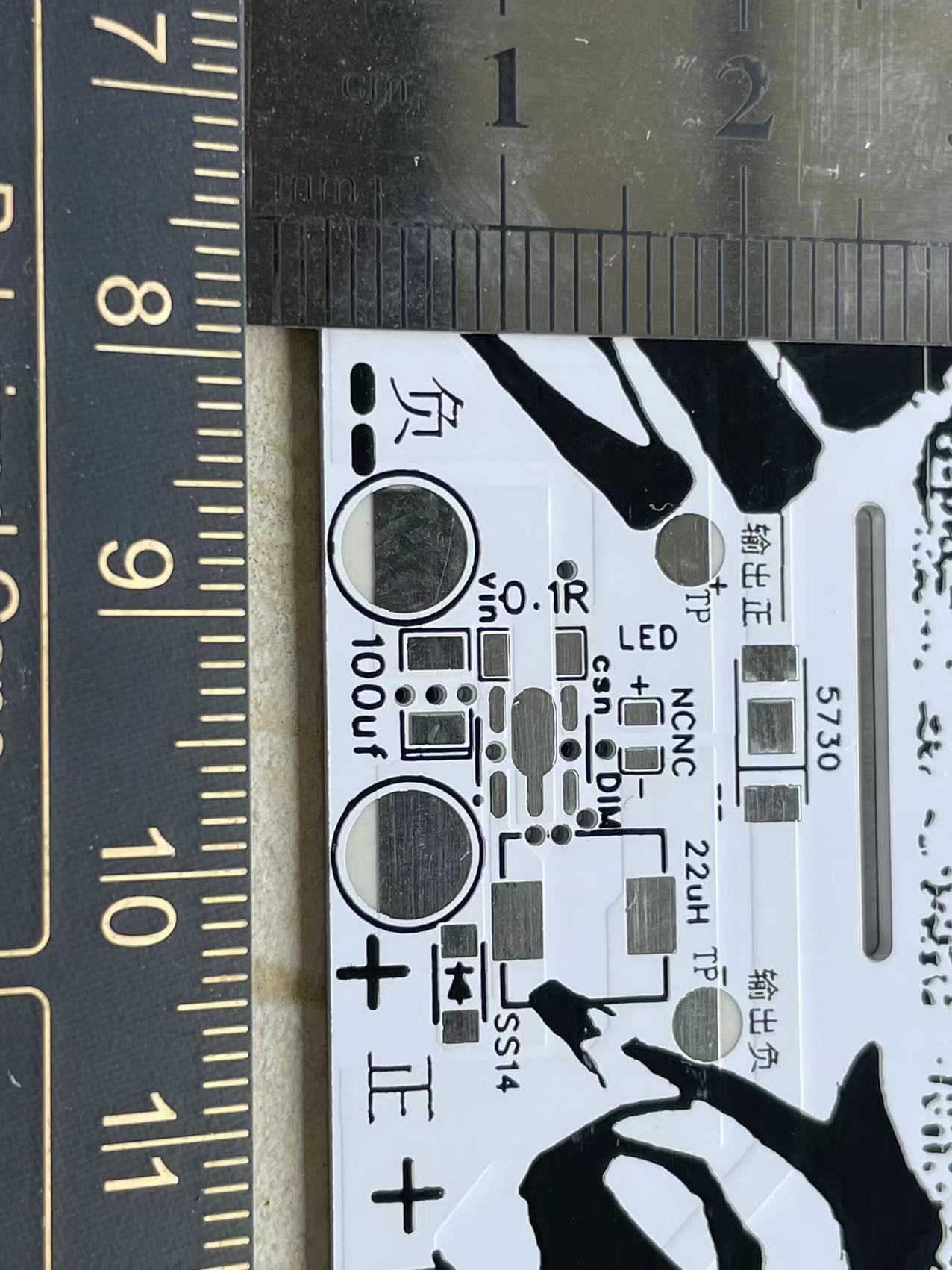

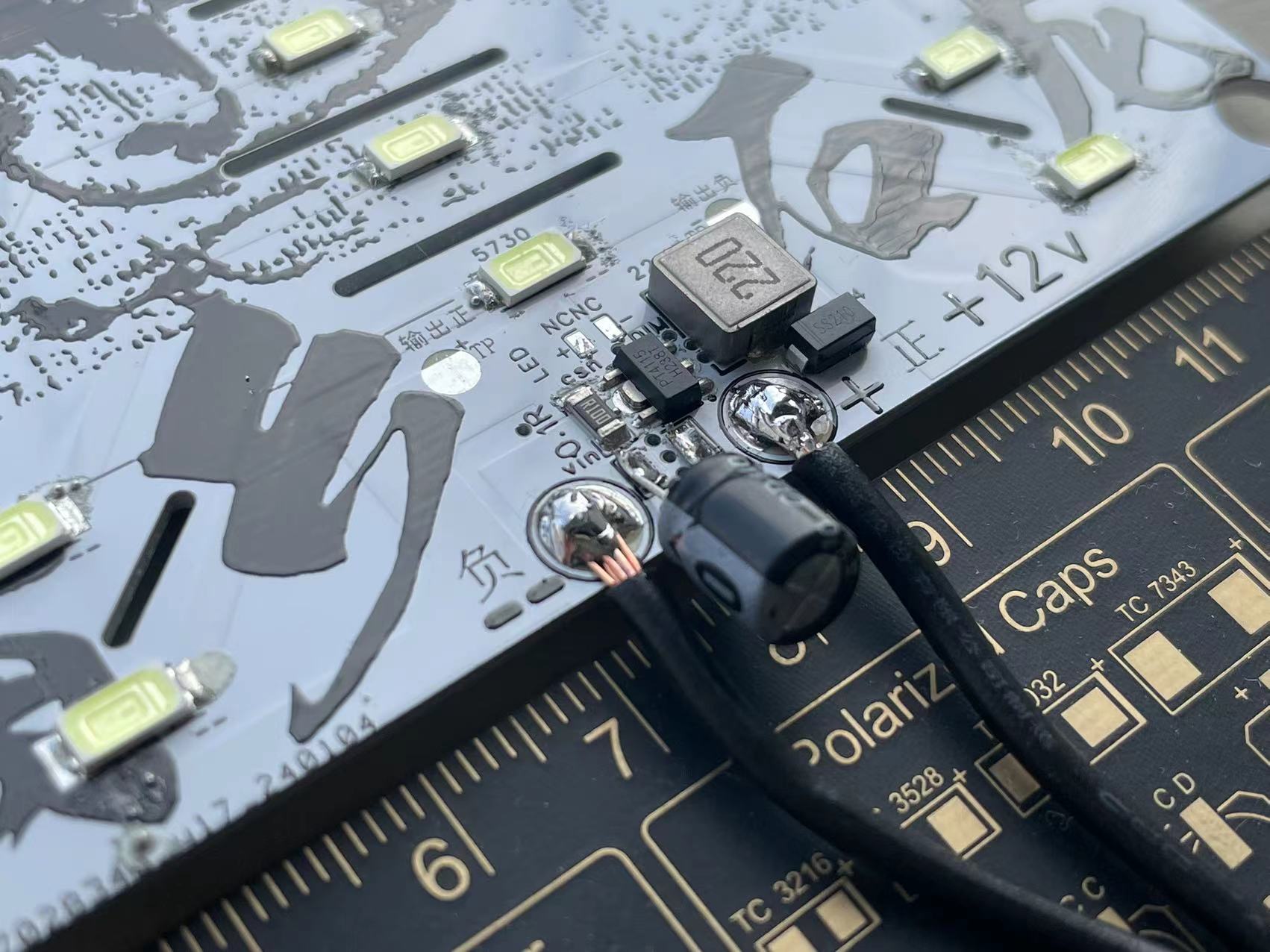

PT4115 aluminum-based LED lighting board (12V 1A 5730 LED chips)
This is a replica of zhqsoft's project
with some adjustments
. Original project address: Single LED Constant Current Driver Module Based on PT4115 Author: zhqsoft
DC 12V Power Supply
PT4115 Constant Current Driver IC

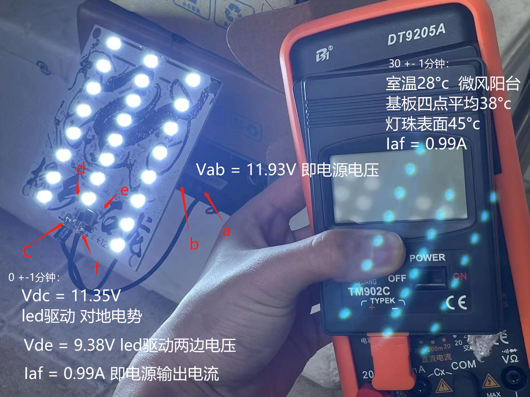

R1=0.1R Constant Current 1A Output
   First publication,
please correct any errors.

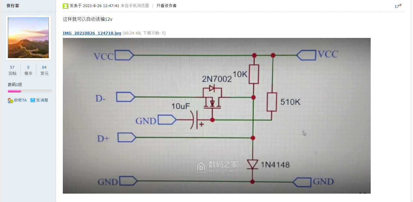

Added: Type-C 12V Trick Circuit (QC2.0 Protocol)
Source: The Simplest QC Trick, QC3.0 12V Output is Absolutely the Simplest - Creative DIY Digital Home (mydigit.cn) Author: Xia Xingke

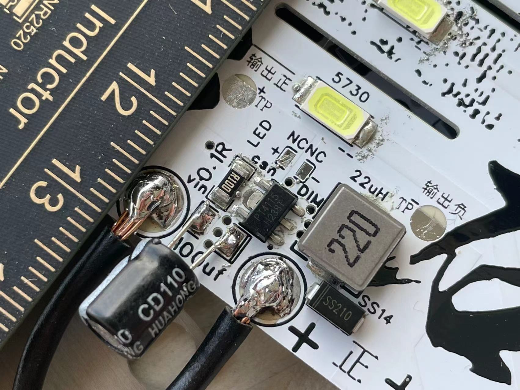

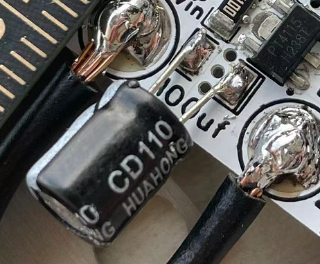

Type-C Version Disadvantages:
     1) Poor economy
     2) High requirements for soldering skills
     3) Low trick success rate and C to C lines generally do not support this protocol. Trick
will not work if the LED does not light up. It is recommended to keep the C port connected and try plugging and unplugging the charging cable multiple times.
To prevent pin bridging, it is recommended to heat the pads until the solder melts and shows a clear metallic luster before placing the Type-C female connector.
