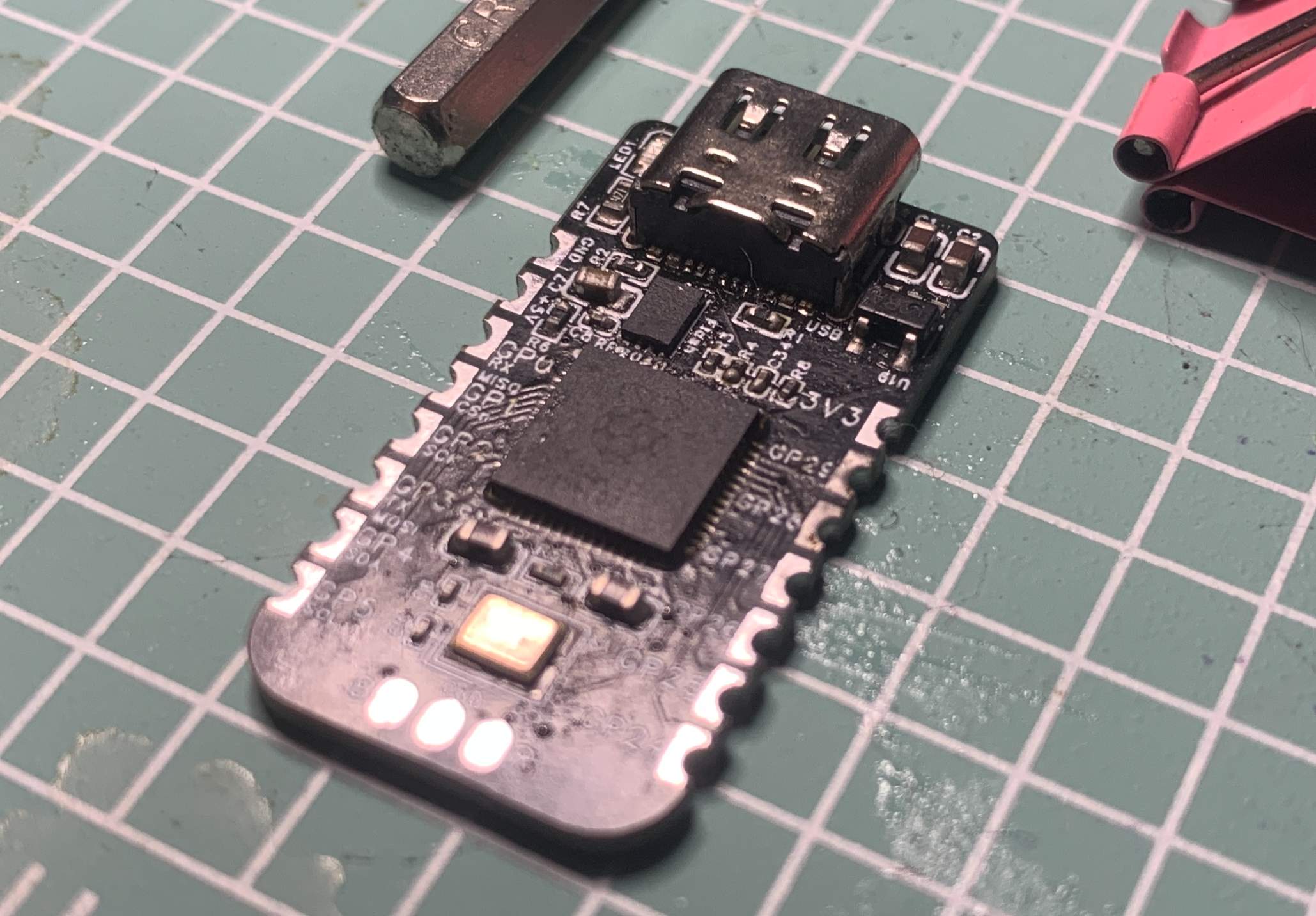

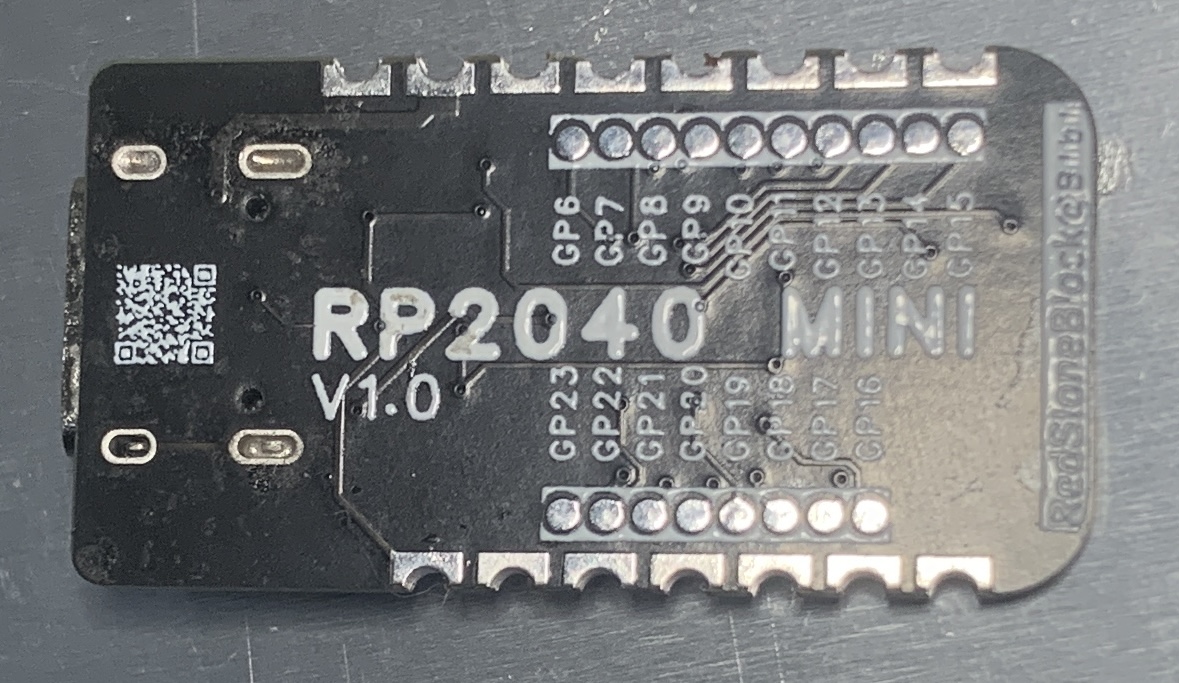

the RP2040 small PCB, 30mm * 16mm (USB-C protrudes approximately 2mm), which runs normally and costs less than 15 RMB. The voltage regulator is an RT9013-33GB, with a maximum current of 500mA. A total of 12 GPIO
pins
are brought out to half-holes, including 4 GPIOs that can function as an ADC. All other I/O pins are brought out to the back of the PCB. The pins on the front are labeled with their commonly used functions for my own convenience. (Image attached: 3V3 test shows 3.25V, Blink test is normal.) Note that my PCB uses 0201 packages. I'm about to take my high school entrance exam. If I release version V1.1, I will change all surface-mount capacitors and resistors to 0402 packages. CC BY-NC-SA 4.0 Creative Commons Attribution-NonCommercial-ShareAlike License. Commercial use is prohibited. Copying, modifying, and sharing are allowed, but attribution is required. Personal use is free . © 2023-2024 Song Yuanzhuo, All rights reserved.
