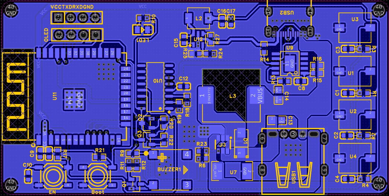

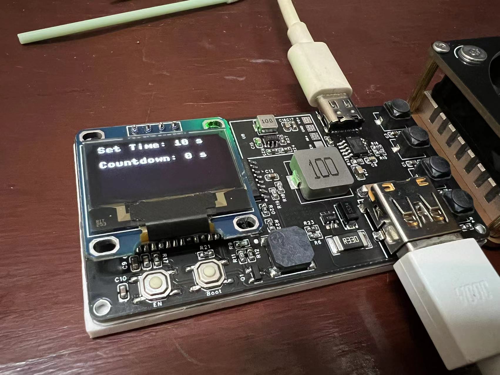

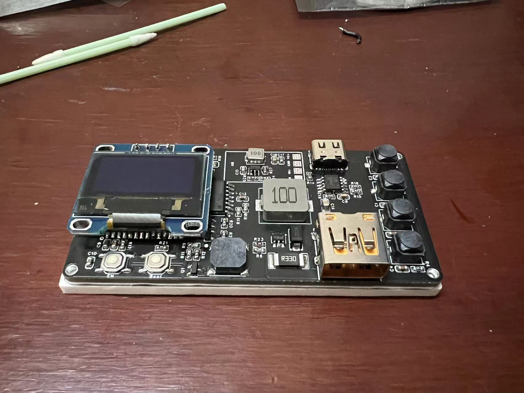

308nm UV Control Board - ESP32 Timing Control

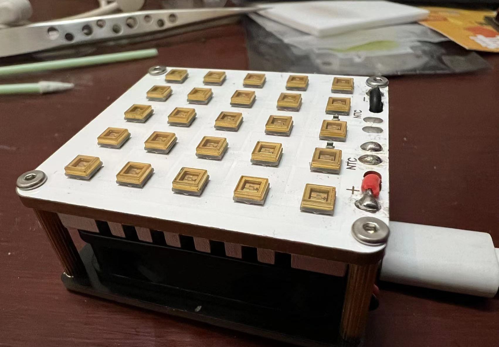

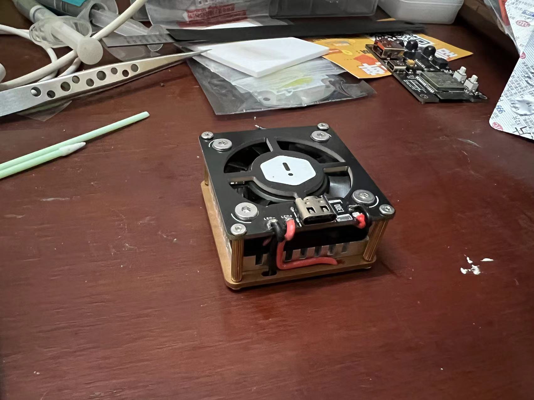

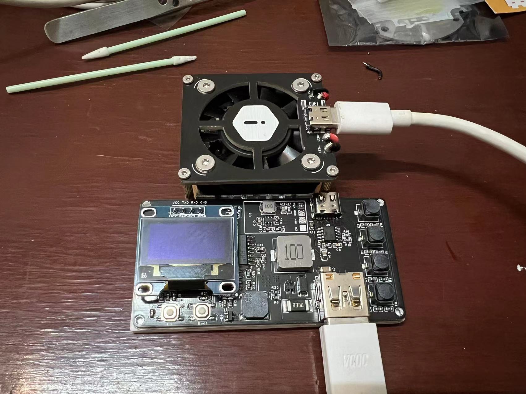

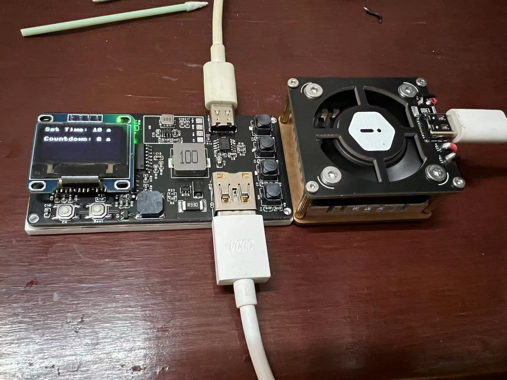

The system consists of a control board and a UV lamp module, including a heat dissipation module.

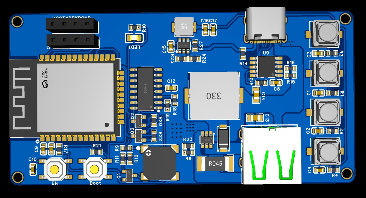

Power is supplied using a CH224K chip to trigger a 12V power supply. The control board includes four buttons (+, ---start, --reset) for time control.
The LED driver uses a constant current driver (SY7200A), paired with an ESP32 to control the on/off time, achieving a timed start-up effect.
A buzzer on the control board provides a countdown timer.

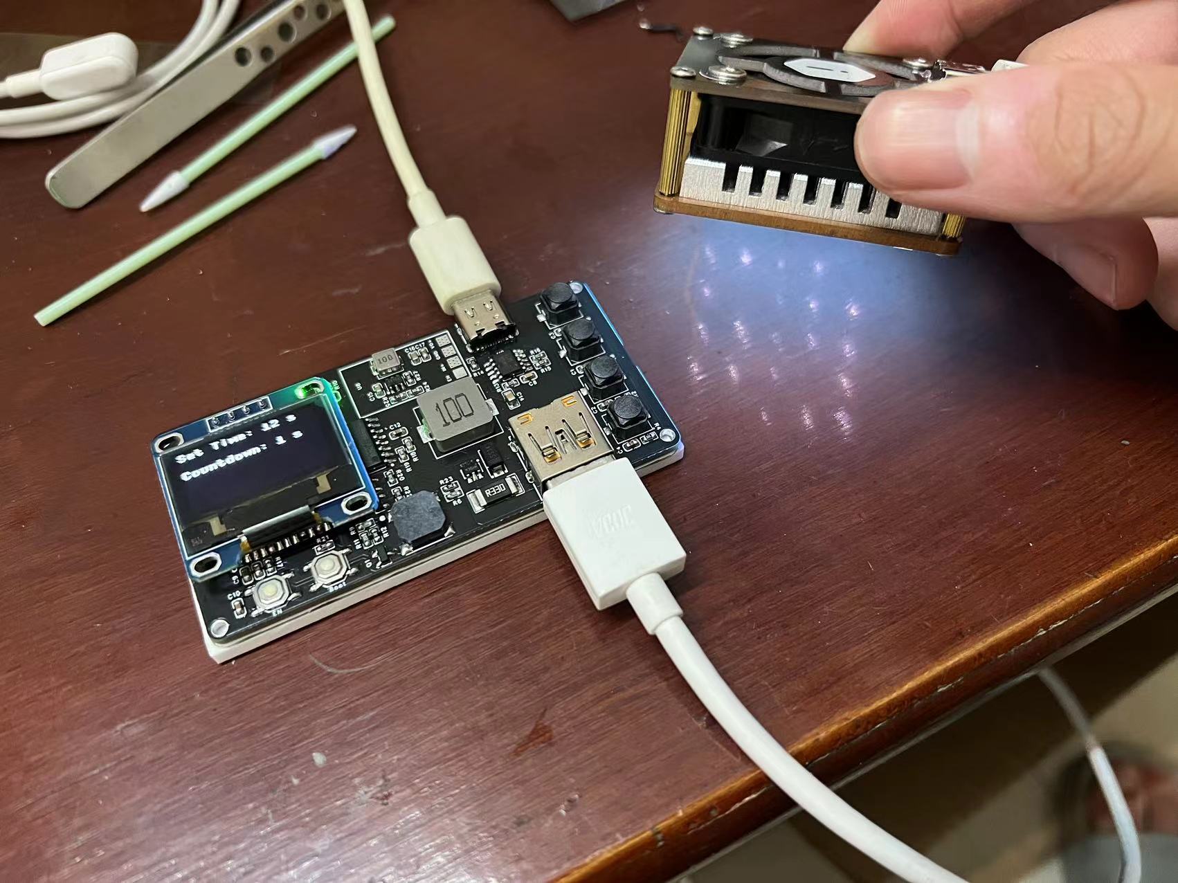

Being a beginner and still learning programming, I only created a simple system. After setting the countdown, pressing the button starts the countdown and illuminates the LEDs; the buzzer sounds when the countdown ends.

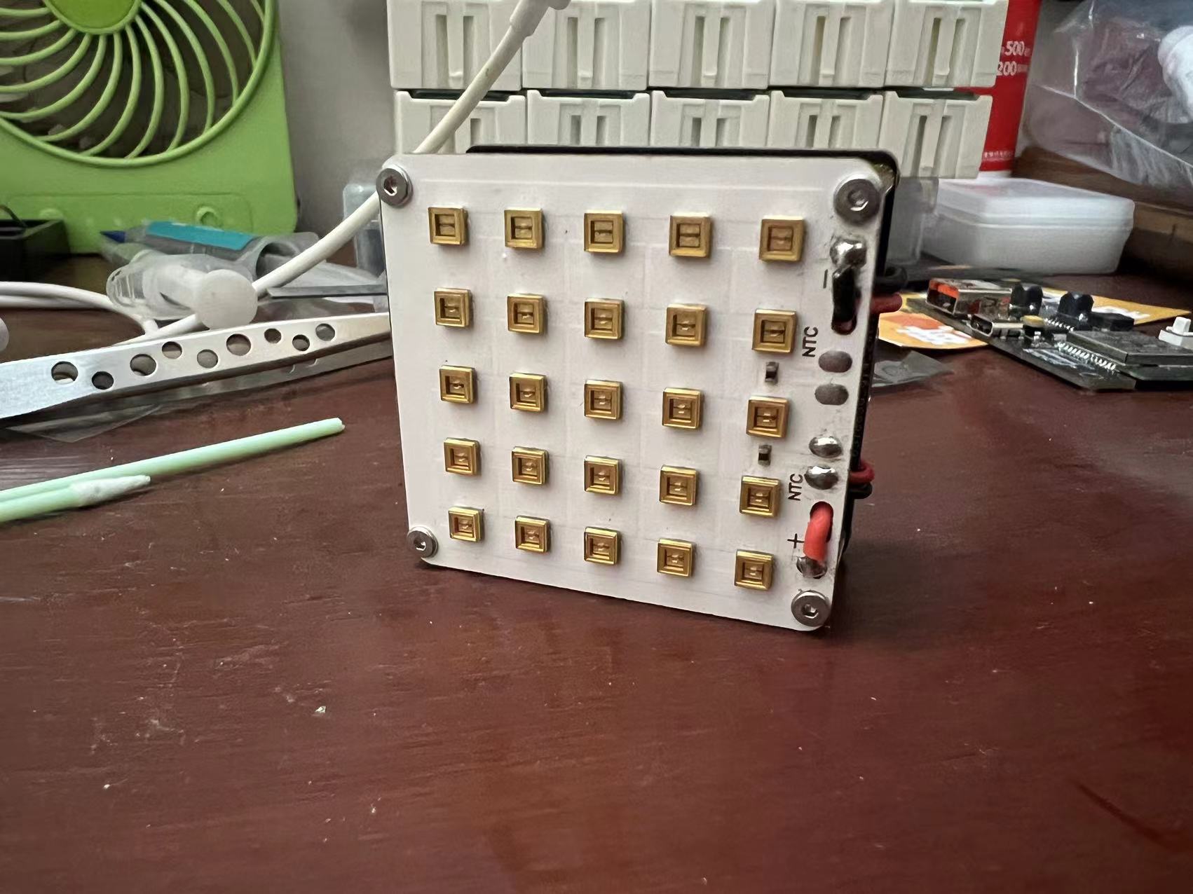

The lamp board arrived a month ago, and I only started working on it after returning from a school holiday trip to Shenzhen. I found that several LEDs wouldn't light up. The seller said they were tested before shipping, but given the long delay and the courier service disruption, I'll leave it as is for now.
The control board outputs 600mA of current to power the lamp board.
I learned circuit design on my own. I initially wanted to use a ready-made step-down module instead of a standard
step-down circuit to reduce the chance of errors. However, after trying the module, I found it difficult to solder. Ultimately, I found a step-down solution, and the solder pads of the original module are still on the board. Thankfully, the step-down circuit didn't fail. After verifying the DC-DC step-down circuit, I removed the solder pads from the original module. The program still has some issues; the buzzer sounds upon power-on, but it works normally after one startup. I'm busy during the Chinese New Year holiday and will fix it when I have time. I would be extremely grateful if an expert could improve the program!
