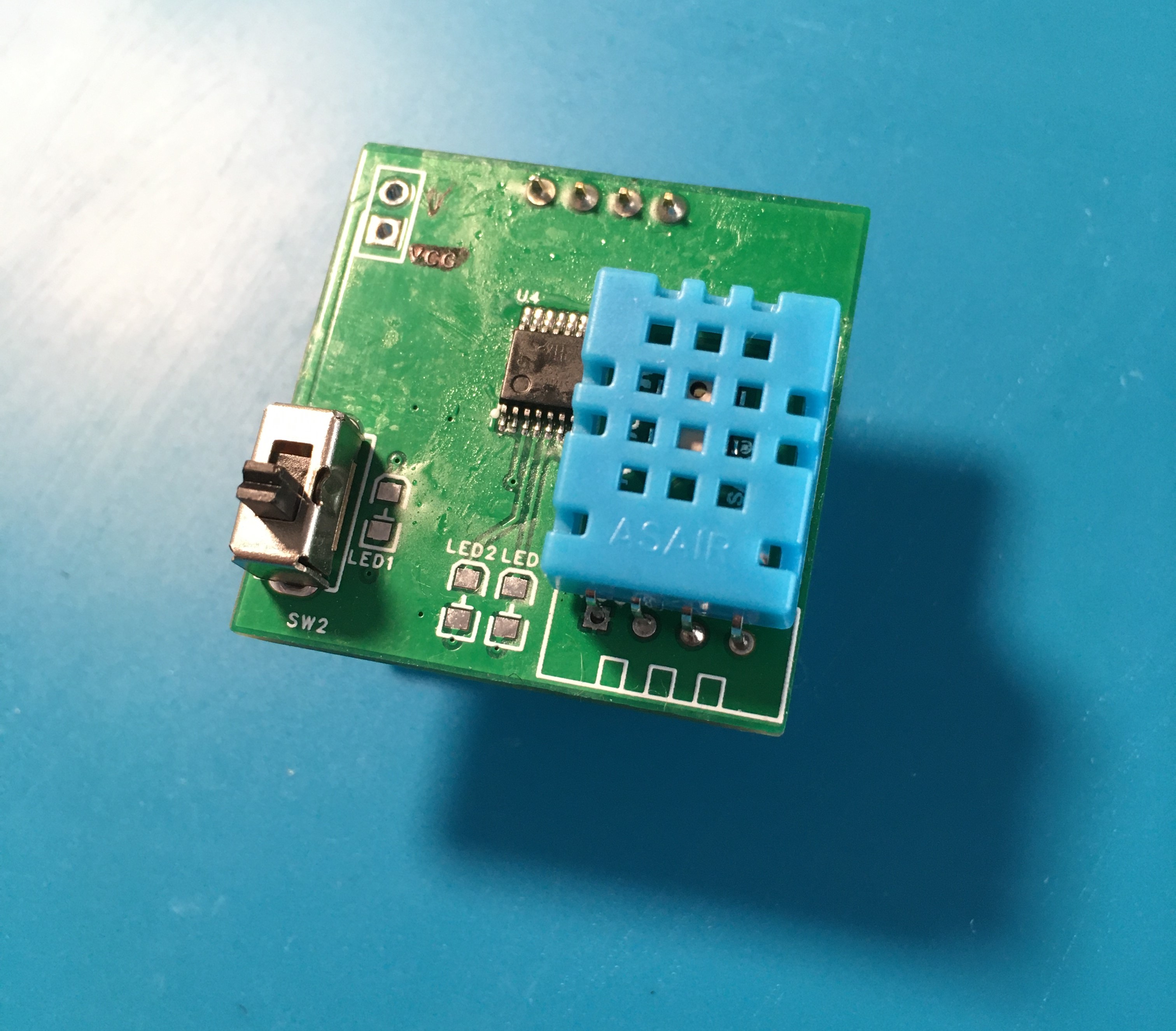

Temperature measurement is achieved using a DHT11 sensor.

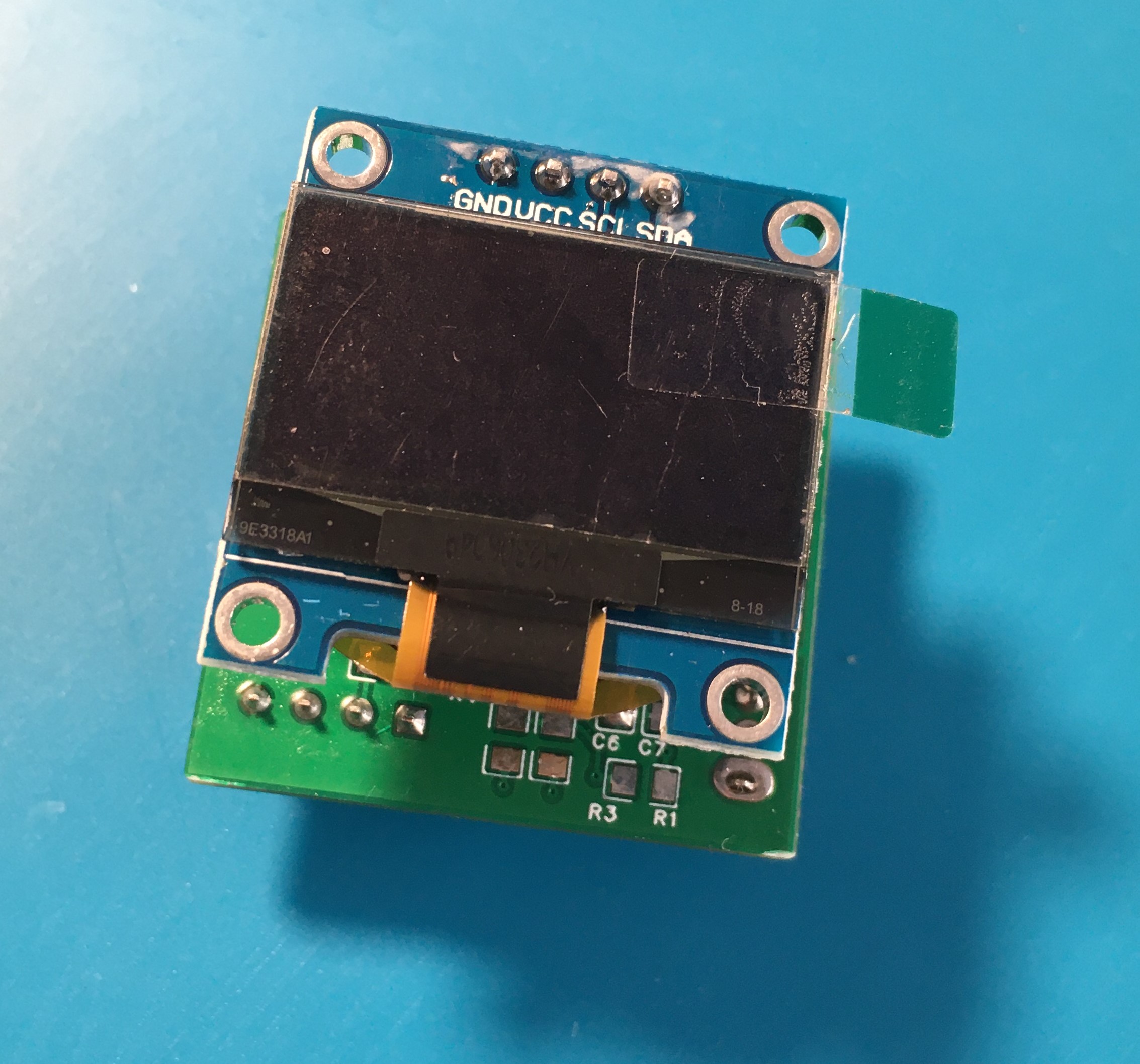

The screen uses a common four-wire OLED module, which can be easily installed by soldering a socket.
Two LED slots are reserved for future code additions to illuminate the LEDs and impress the user.

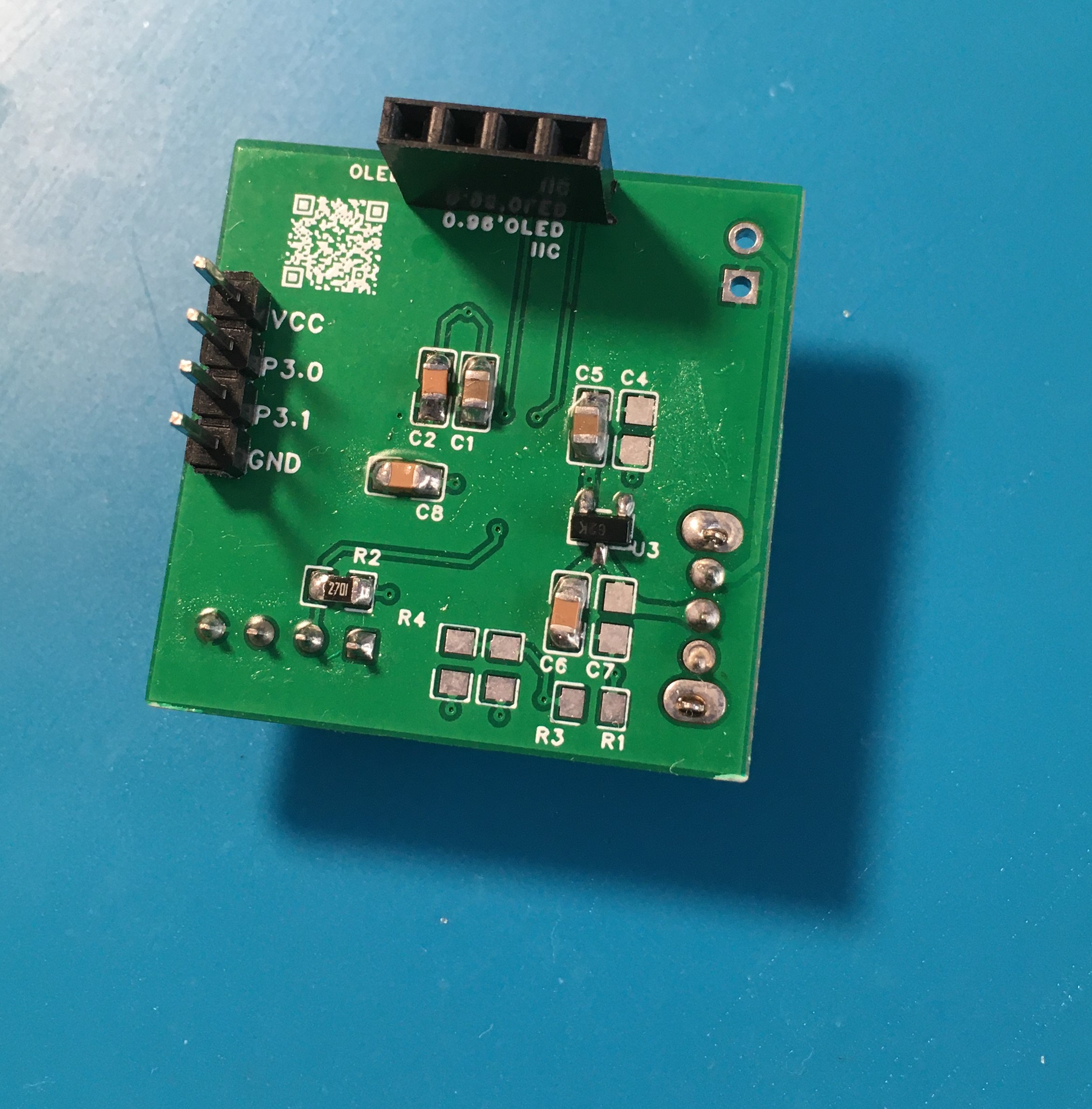

1.28: Received, soldered, verified.
Anecdote:
Regarding the LDO emitting light (smoke) on my first power-on (not really),
after checking, I found that some idiot (yes, it was me) had placed the VCC silkscreen on the GND pad, which made me furious (already corrected).
As a result, an LDO and an MCU burned out, thankfully the DHT11 didn't (doge).

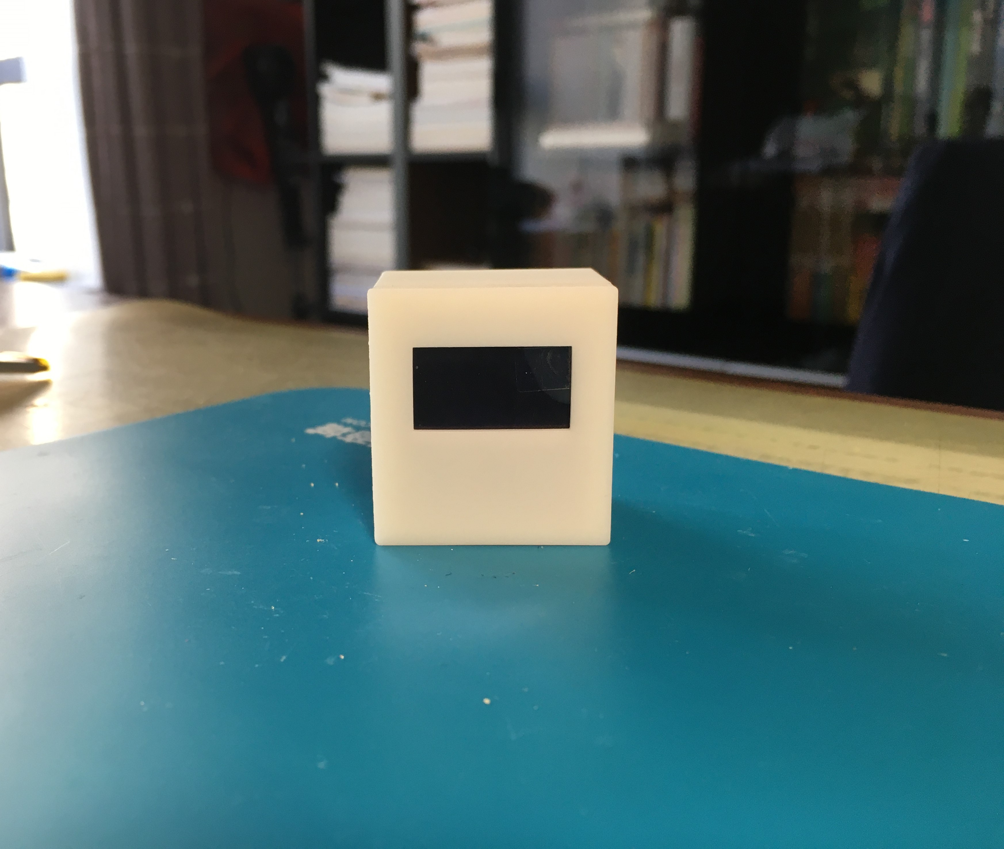

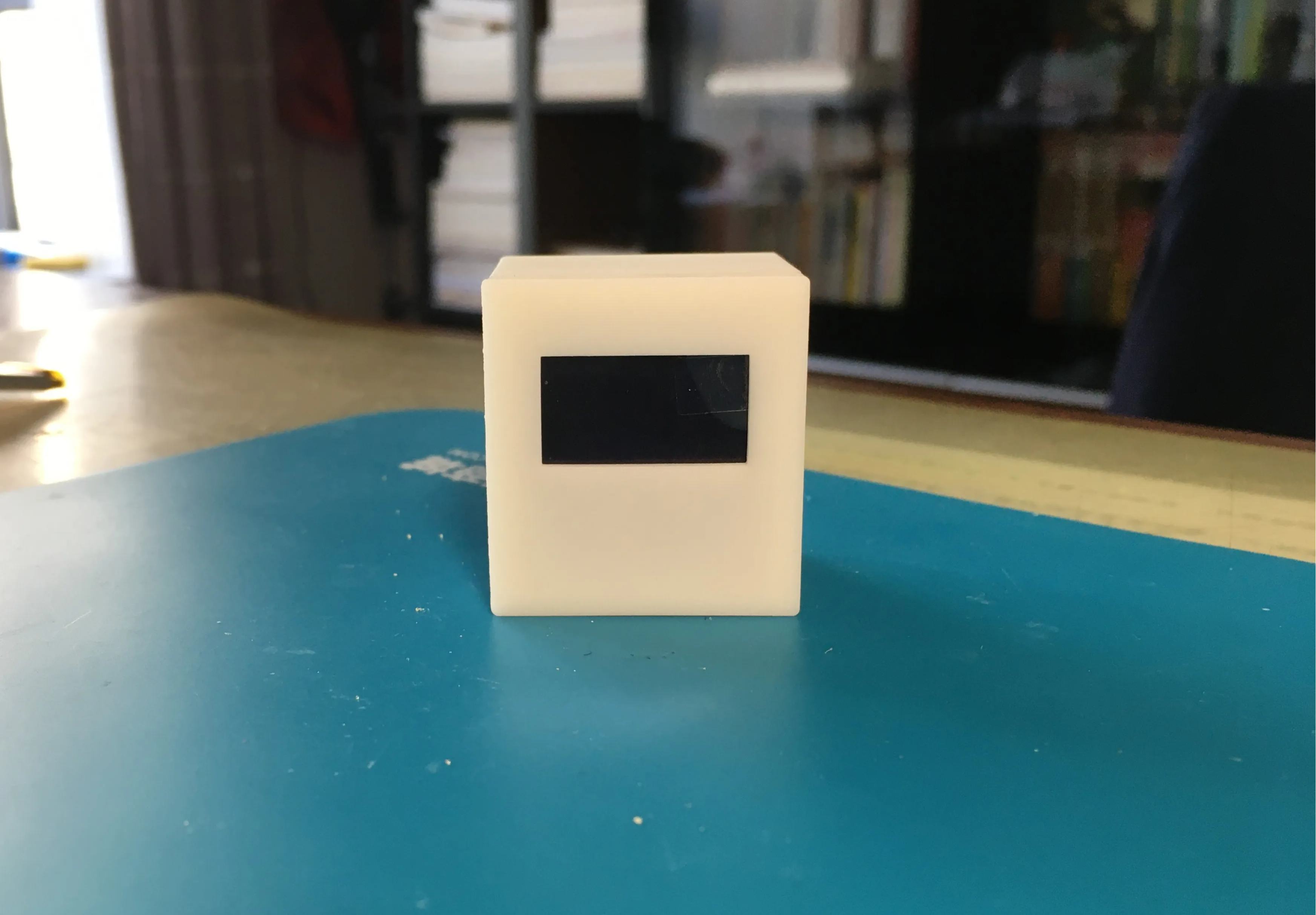

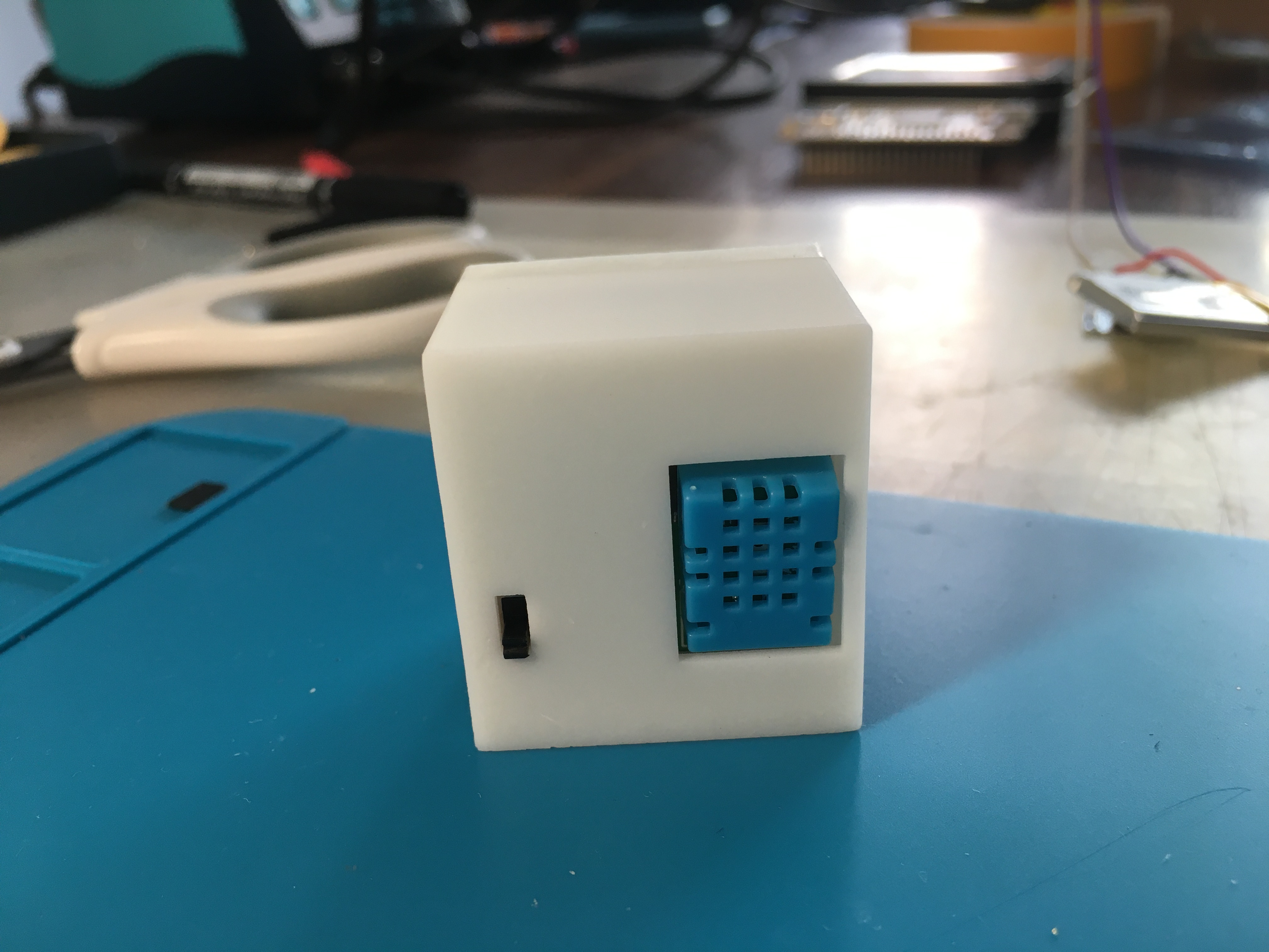

Regarding the casing:
First time designing a casing, a disaster.

Front (with display):
Front (only soldering necessary test components):
Back (board cleaner hasn't arrived yet, so I won't clean it for now):
Casing front:
Casing back:
Other
casing modifications will be made later.
