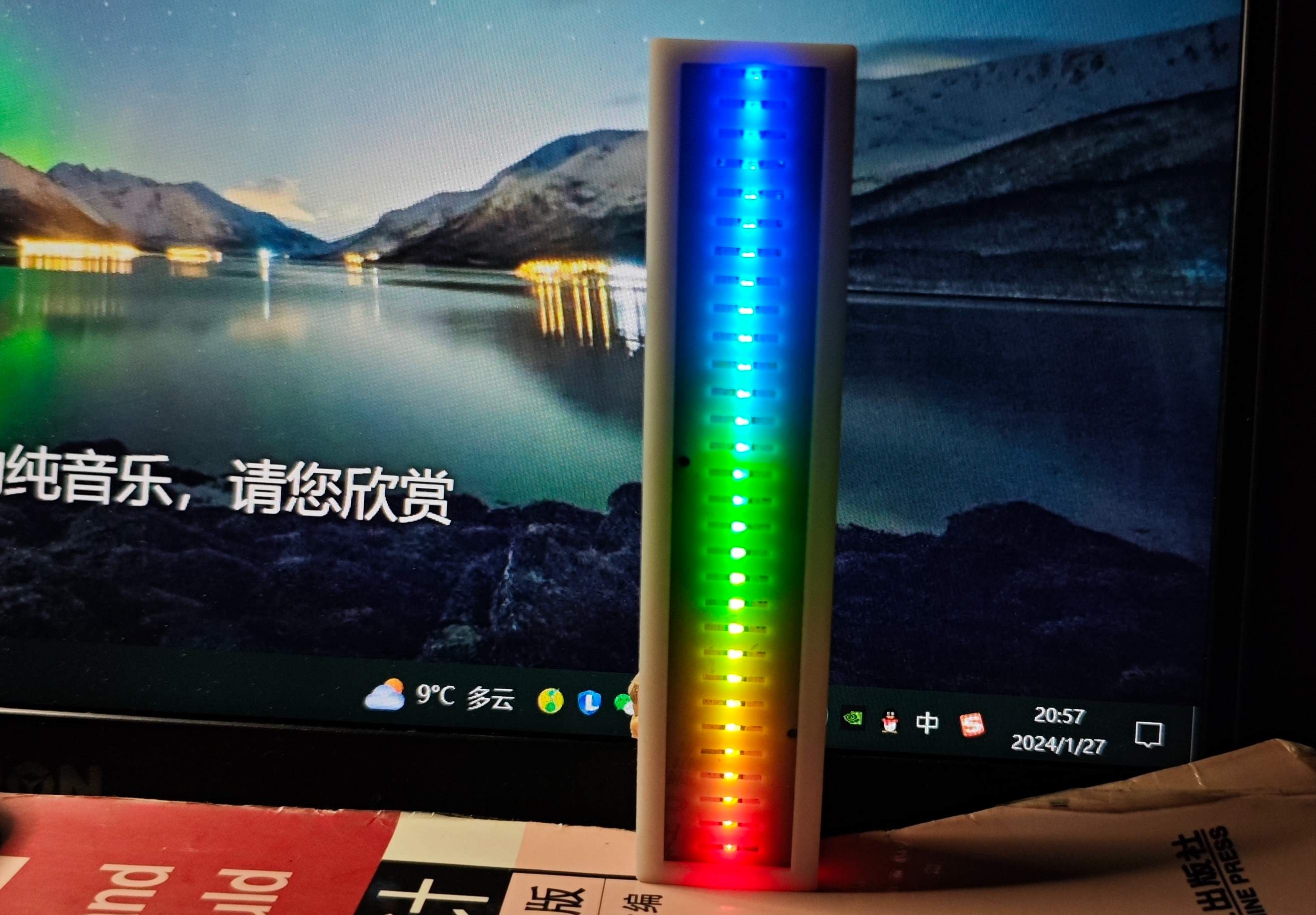

Rhythmic LED strip (color silkscreen printing & modified casing)
 I. Project Introduction
    This project cloned and modified the workshop director's rhythmic light strip. The first version was made a year and a half ago. It was relatively small, and the circuitry was working and verified to be usable. However, due to some issues with the casing design, the circuitry was not convenient for programming. Therefore, a second version was recently designed based on available materials. The biggest difference from the first version is the redesigned casing, which can be 3D printed directly. The snap-fit ​​design makes assembly and disassembly easy, eliminating the need for screw posts, reducing size and cost.
Comparison of the two versions
: First version: The CH340 download circuit was omitted, making downloading and debugging slightly more complicated, requiring an external programmer, but the cost was relatively reduced; due to being a beginner, automatic wiring was used, resulting in messy wiring, but it was usable; calculation errors occurred during casing design, so the casing is barely usable but not ideal; a power switching circuit was missing, leading to situations where the battery is charged and discharged simultaneously, which is not very battery-friendly.
Second version: The second version specifically addressed the issues of the first version.
               1. Added Automatic Download Circuit: An automatic download circuit for the CH340C was added, which has been tested and confirmed to be working. The original integrated MOSFETs were replaced with two NMOS transistors, simplifying soldering and eliminating the need for orientation identification. The program can be burned simply by connecting the automatic download circuit to the computer via a data cable; no download module or button operation is required, facilitating program debugging.
               2. Optimized Layout and Routing: Layout and routing were completed in-house, resulting in a simpler layout and routing compared to the first version.
               3. Housing Structure Design: The housing design was completed using JLCPCB EDA, achieving higher precision. The snap-fit ​​structure was drawn using other housing software, and a grating was used to fix the PCB in place to prevent movement within the housing.
               4. Added Power Switching Circuit: This circuit prevents the battery from using its own power during charging while allowing external power supply during charging, improving battery life and circuit safety.
               5. Added Color Silkscreen Printing: Compared to the monochrome of the first version, the second version incorporates color silkscreen printing, making the PCB more visually appealing.
               6. Complete Project Information: The information is organized, and the purchase of all materials (except the casing, which is included in the accessories and can be printed at JLCPCB) is listed in a convenient inventory list.
Advantages and Disadvantages: Disadvantages: The total cost of materials is approximately 90 (including capacitors and resistors; if you have your own capacitors and resistors, it will be about 10 yuan cheaper; this is the cost of one set, and the average cost will be lower if you make several sets). The cost per set is relatively high, and the cost-effectiveness is lower compared to prices on Taobao. The WS2812 package is small and not easy to solder.
                     Advantages: Complete information allows for DIY and enjoying the entire production process; the circuit is simple and easy to understand, and can be added to or modified; the code is publicly available, simple and easy to learn, and you can also learn about the ESP8266 module; there is an automatic program download circuit, which can be used to burn programs at any time with just a data cable.
