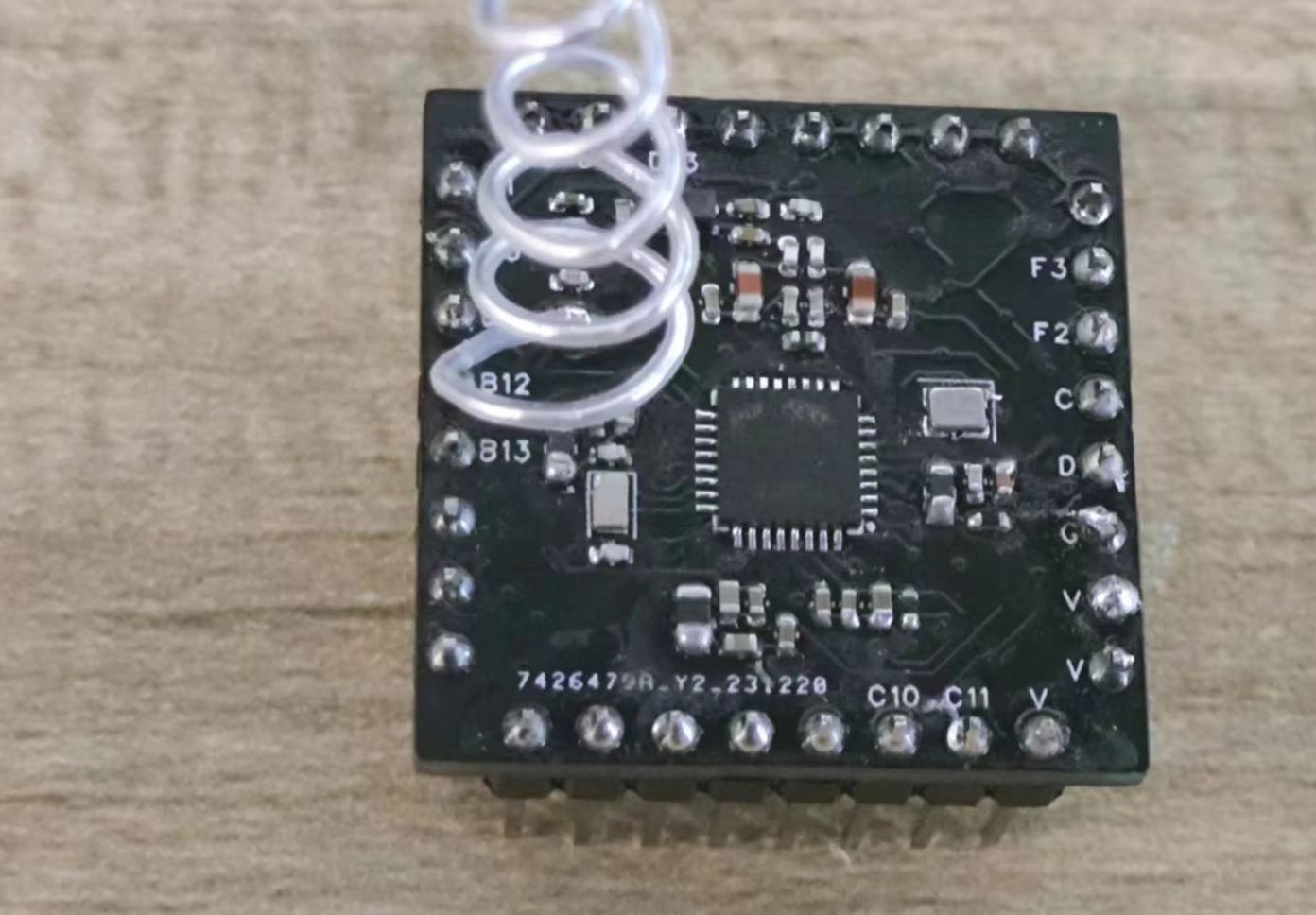

efr32fg14f256gm32 Minimal System

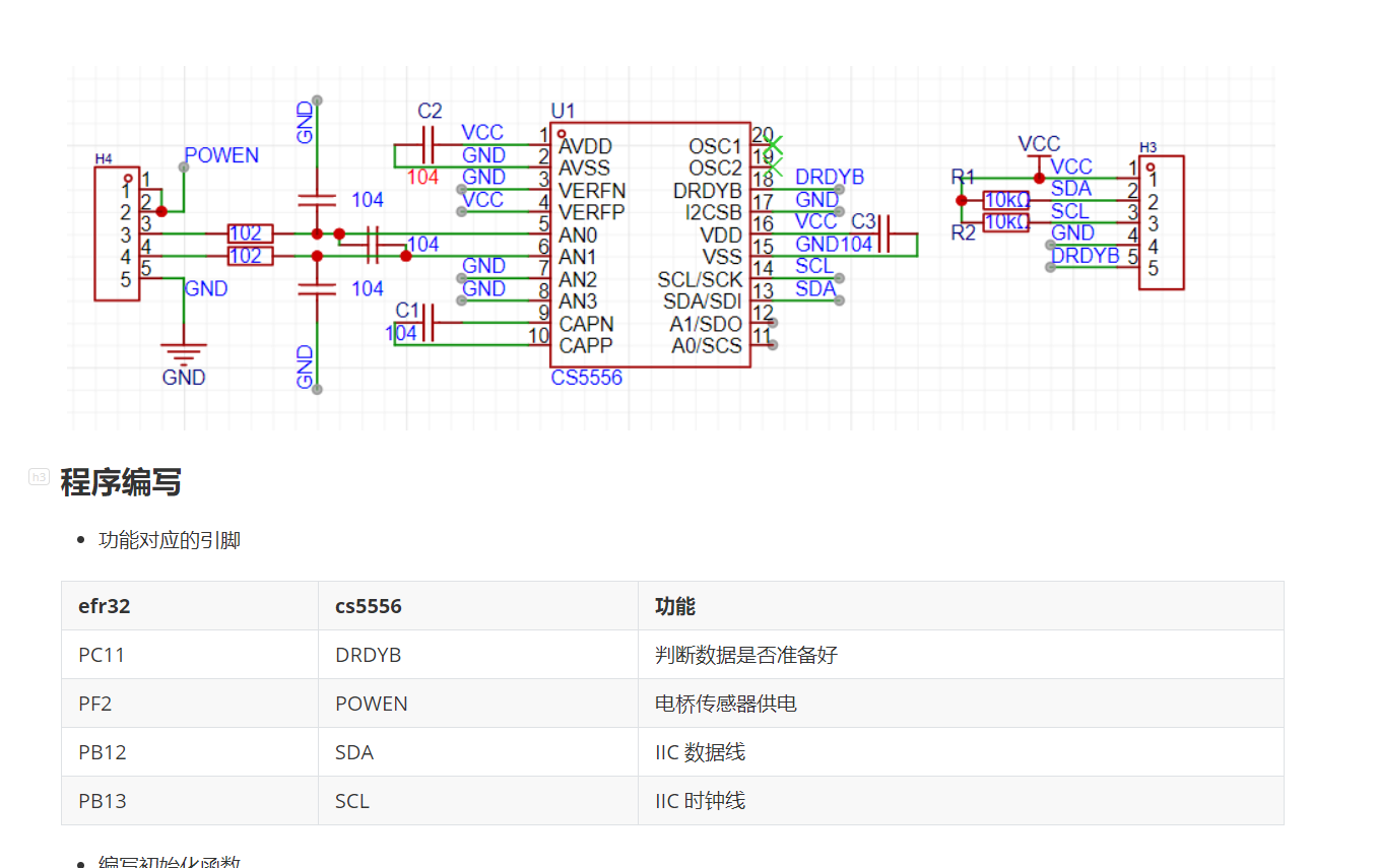

First, below is the schematic diagram of the CS5556 test board. The CS5556 is a 24-bit ADC.

The video content does not need to be connected to a computer and can be received through a separate receiver. The output AD value changes when something is attached to the bridge and when nothing is attached.
