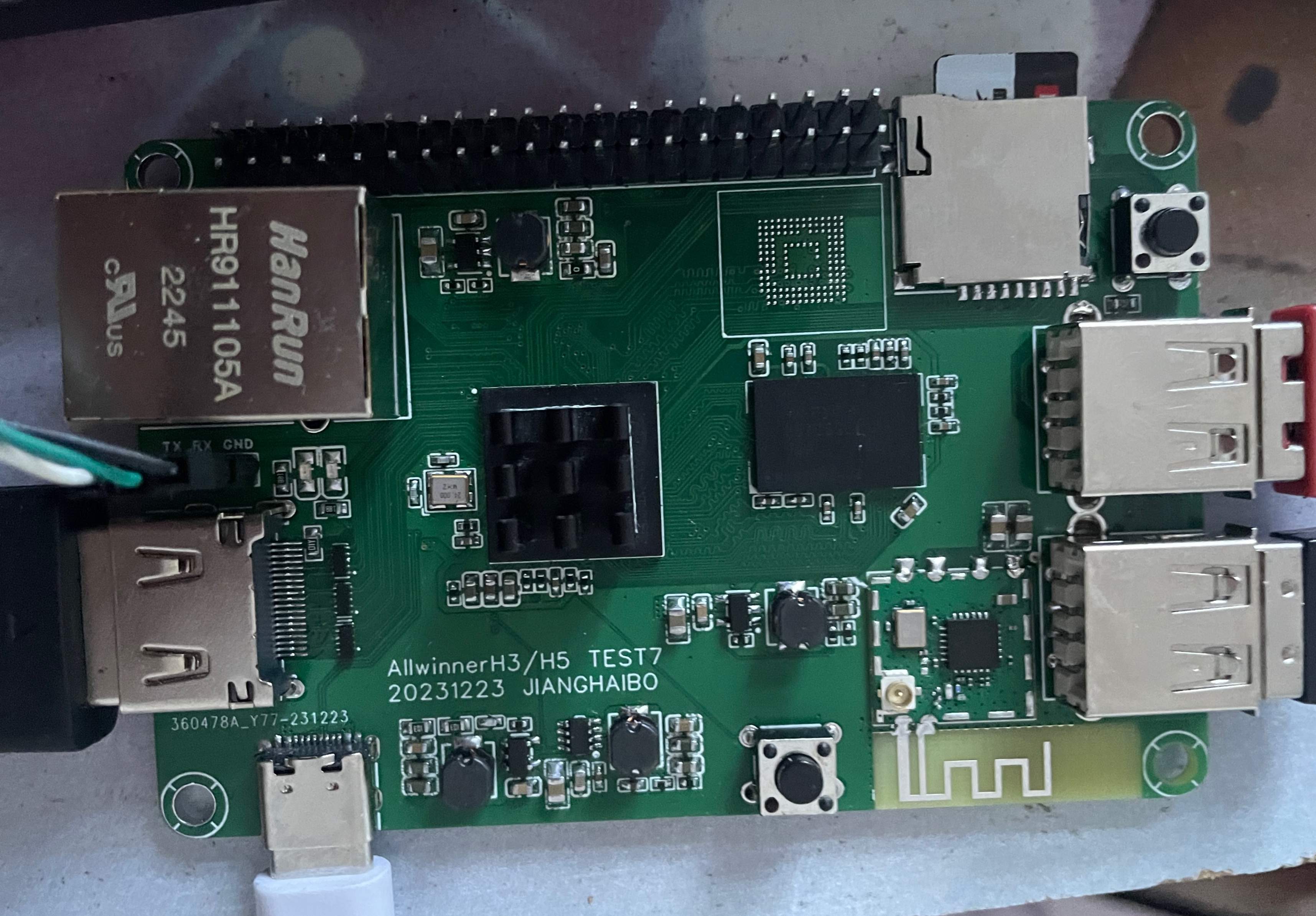

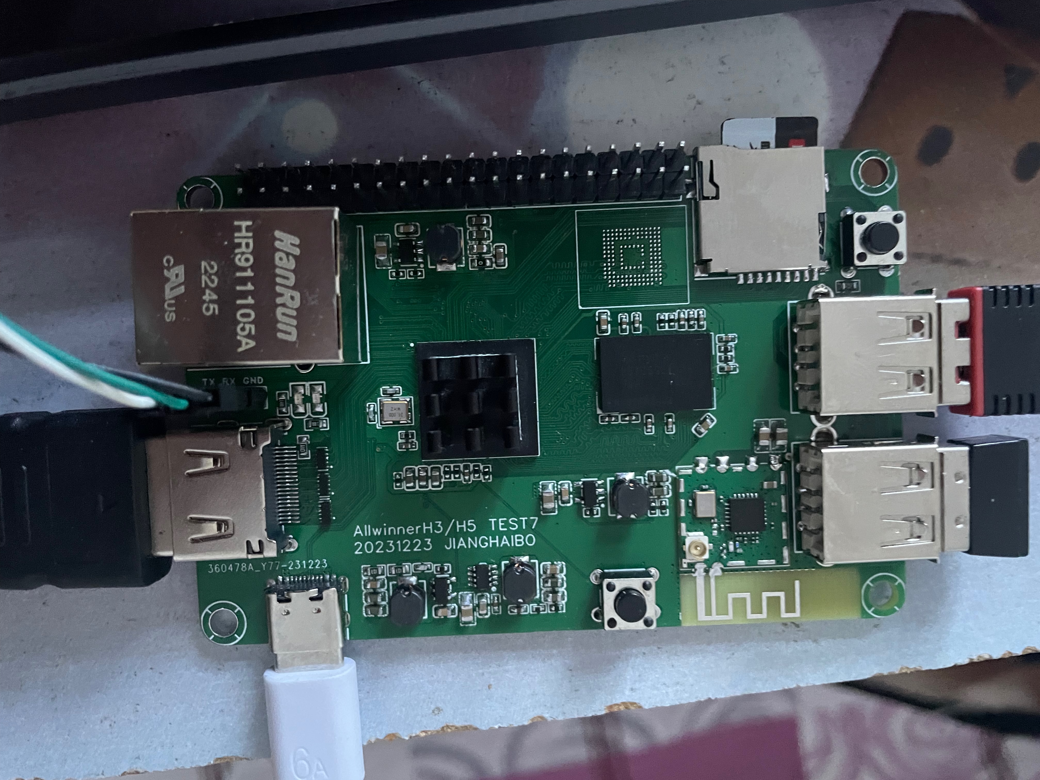

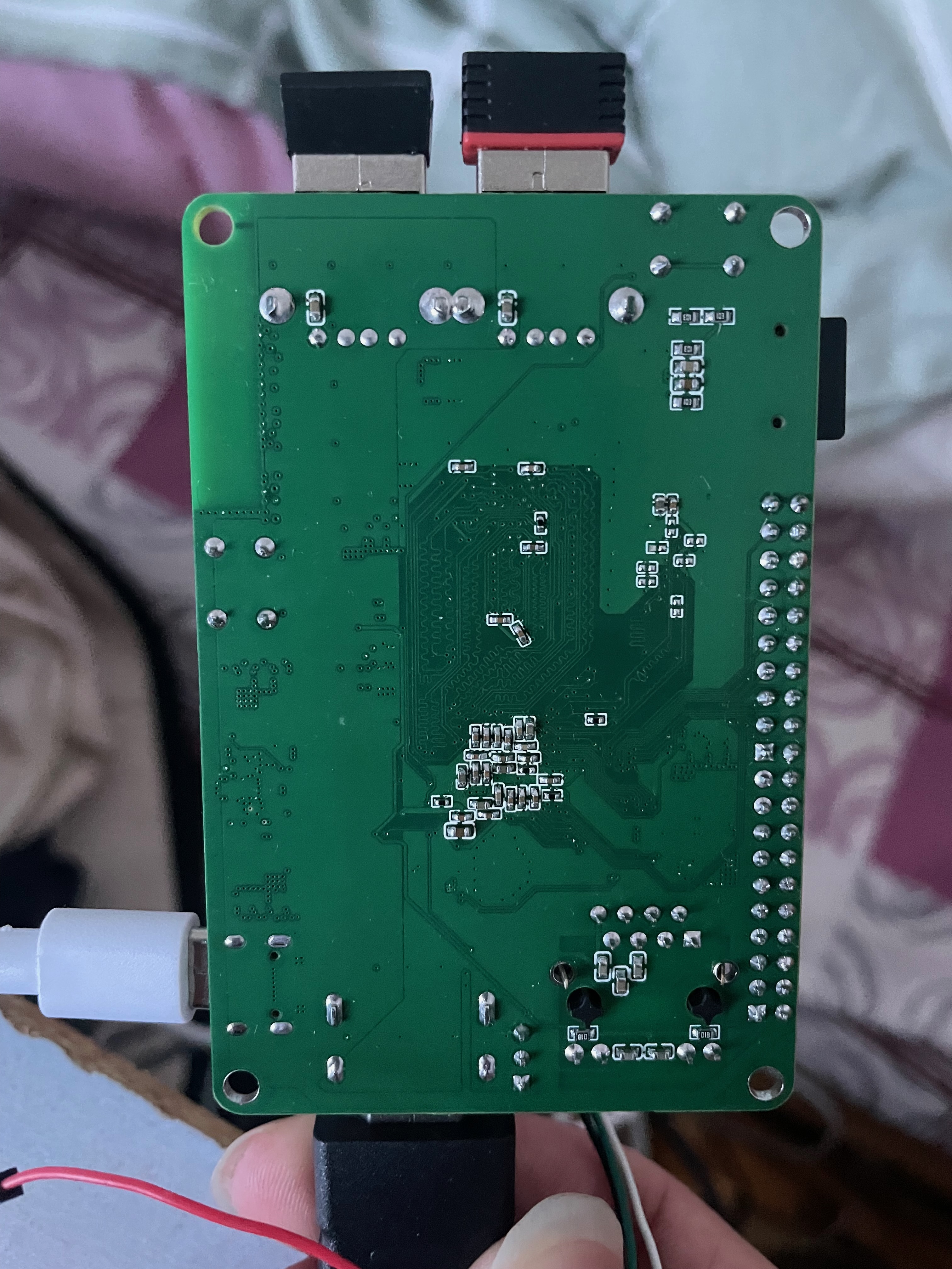

Based on the previous six-layer board, it was changed to a four-layer board to reduce costs, but I haven't figured out its specific use yet. I installed an Android system on one of the H3 boards and watched TV for a whole semester. The
impedance was chosen to be 3313 impedance for the four-layer board!
The board adds an onboard wireless network card (8188) instead of the default one, but at no extra cost. The antenna will report a DRC error. Remember to post this before releasing the board.
