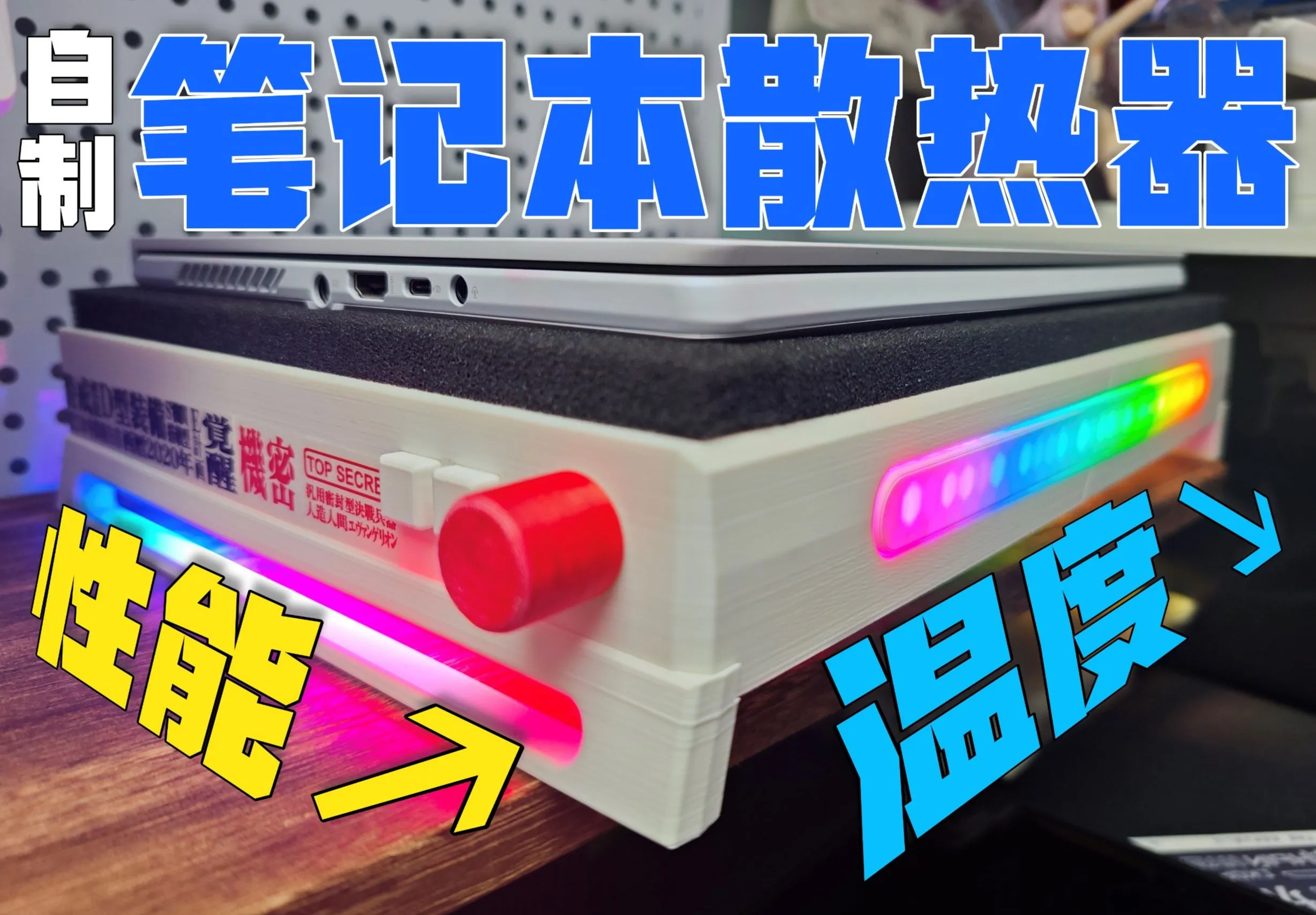

RGB intelligent air pressure laptop cooler
This RGB intelligent fan-driven laptop cooler, based on the ESP Wroom 32e, consists of a main control PCB (communication module, main control module, power supply module), button PCB (button switches, knobs), RGB light strip, turbine fan, and a 3D printed shell.
Background: The heat dissipation and noise control performance of thin and light gaming laptops is generally average, so I decided to make a fan-driven laptop cooler to improve this problem and at the same time beautify my desktop. Functions: Air pressure cooling, RGB equivalent, button and knob control, software remote control, voice assistant intelligent control.
Demonstration: https://www.bilibili.com/video/BV1nitfehE3X/?vd_source=d1f3fc84c98ce29f0b067a18ea300d05
Major Components List:

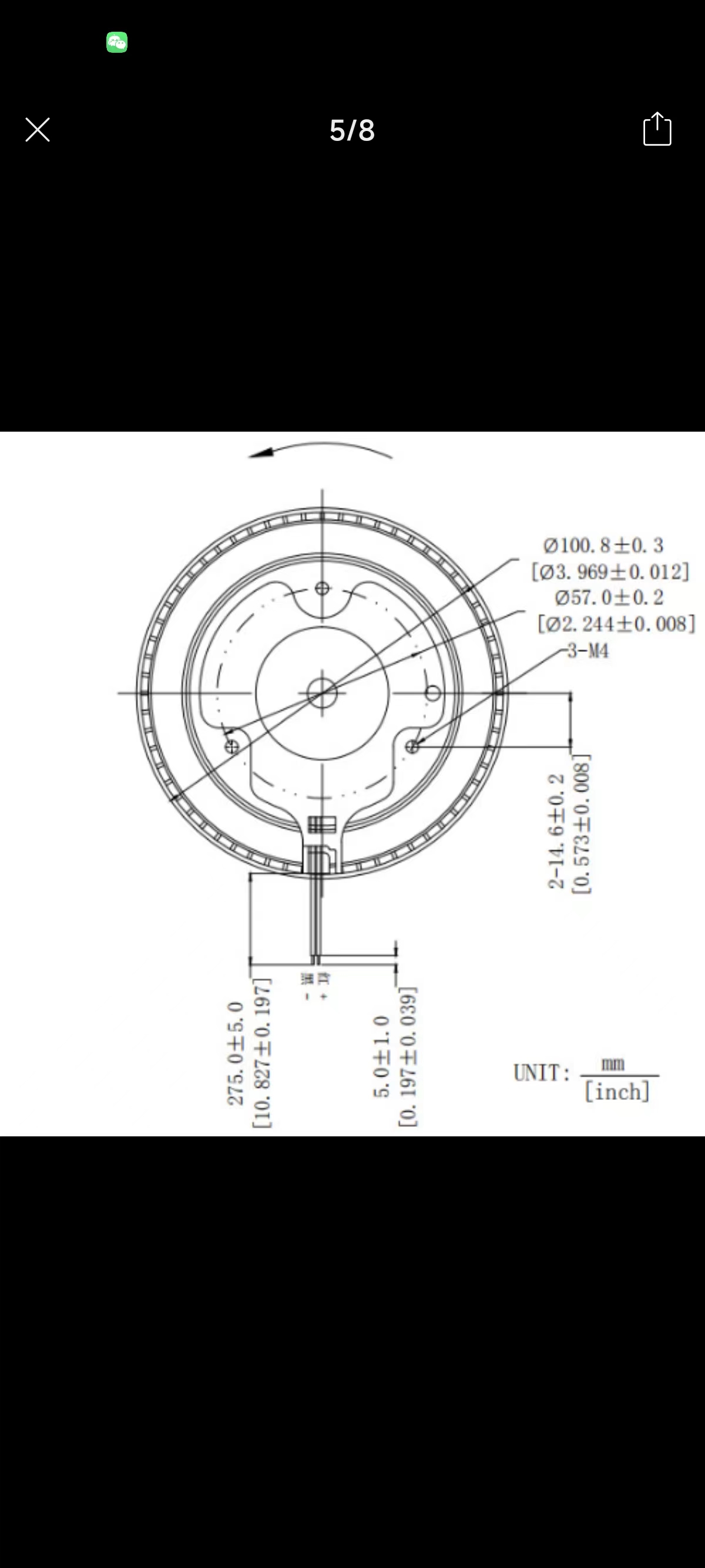

1. Two 12cm turbine fans (
purchased from Pinduoduo; the seller no longer sells them, but they're basically the same; theoretically, turbine fans with screw hole specifications as follows (diameter less than 12cm) can be used).
2. WS2812 LED strip (purchased from Pinduoduo; LED density doesn't need to be too high, 60-80 LEDs/meter is fine; buy one meter)
. 3. Soft sponge single-sided tape, 2cm wide, 1cm thick.
4. 502 glue, hot melt glue, light-shielding tape.

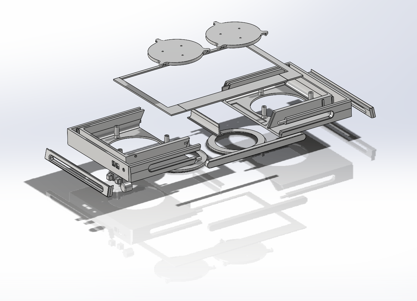

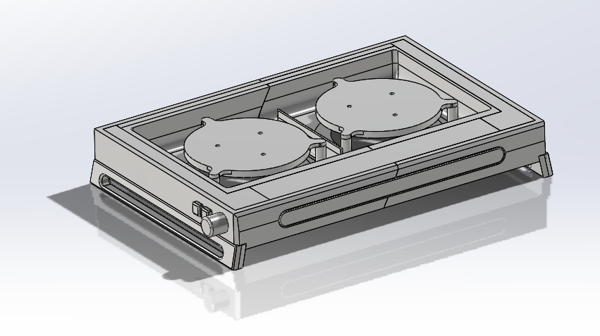

I used Tuozhu X1C for
3D printing. Printing consumables: ESU's economical white PLA. All models in this project will use approximately 700g.
When slicing the model, the two largest printable parts (left and right main body) were adjusted to 6 layers for the walls, and the RGB light strip walls were adjusted to 4 layers with an infill density of 8%. Adjusting the number of layers is mainly to suppress light leakage. My RGB light strips use a honeycomb infill method; different infill methods will result in different light strip effects (different patterns). It
is recommended to use light-shielding tape to fix the RGB light strips. Also, apply an appropriate width of tape above the light strips (to suppress light leakage).

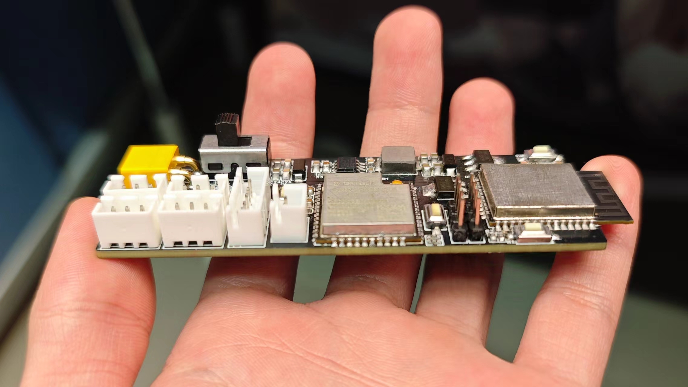

PCB:
See the schematic and PCB at the end of the project.
A picture of the soldered result is also attached.

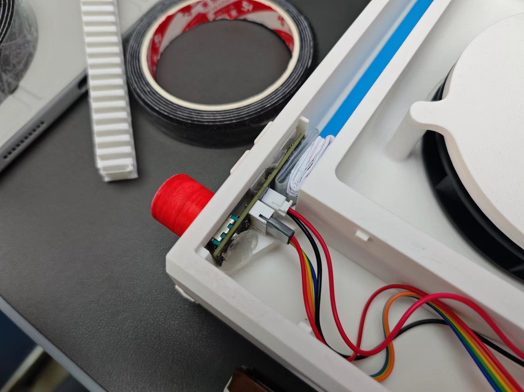

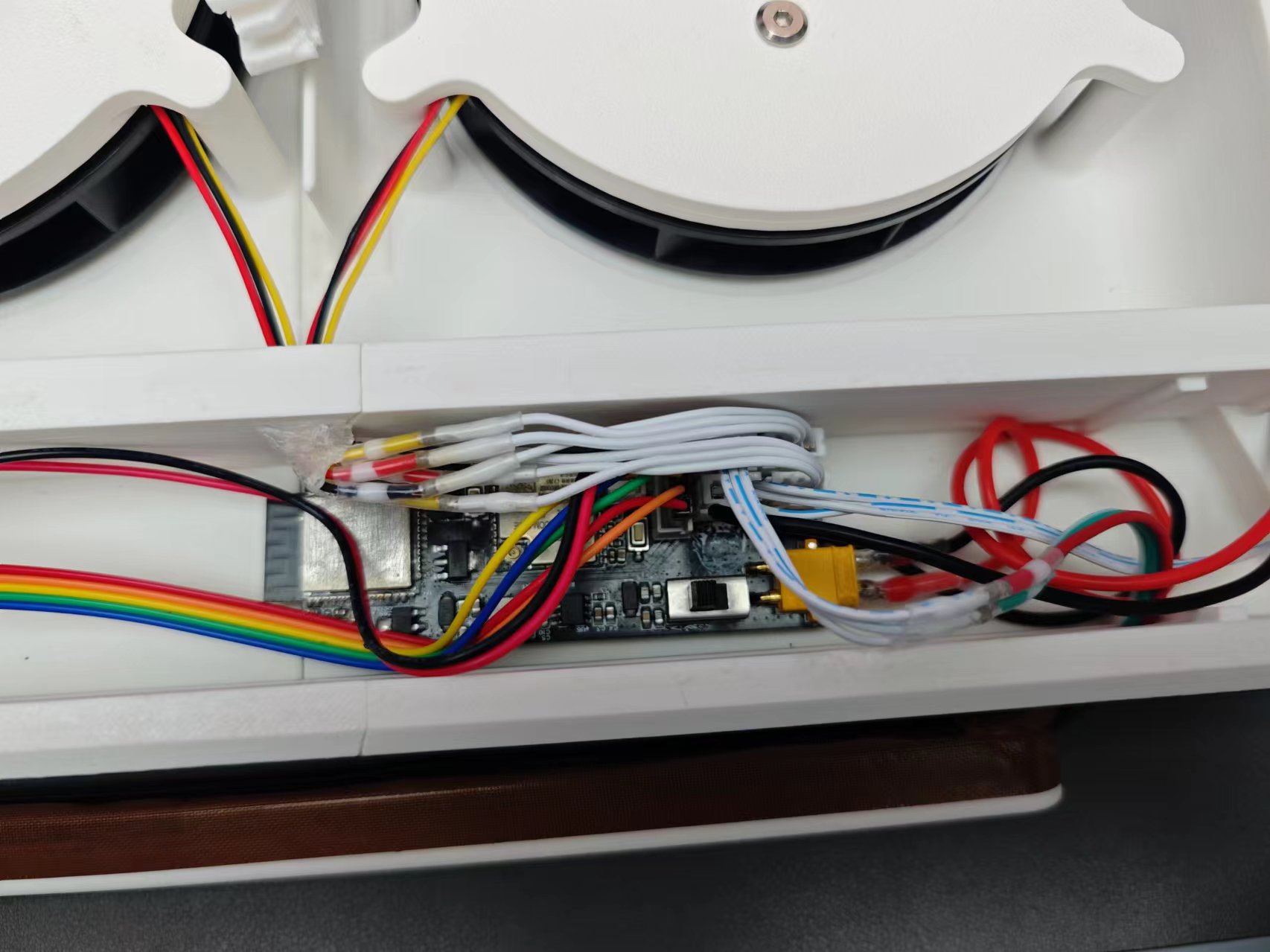

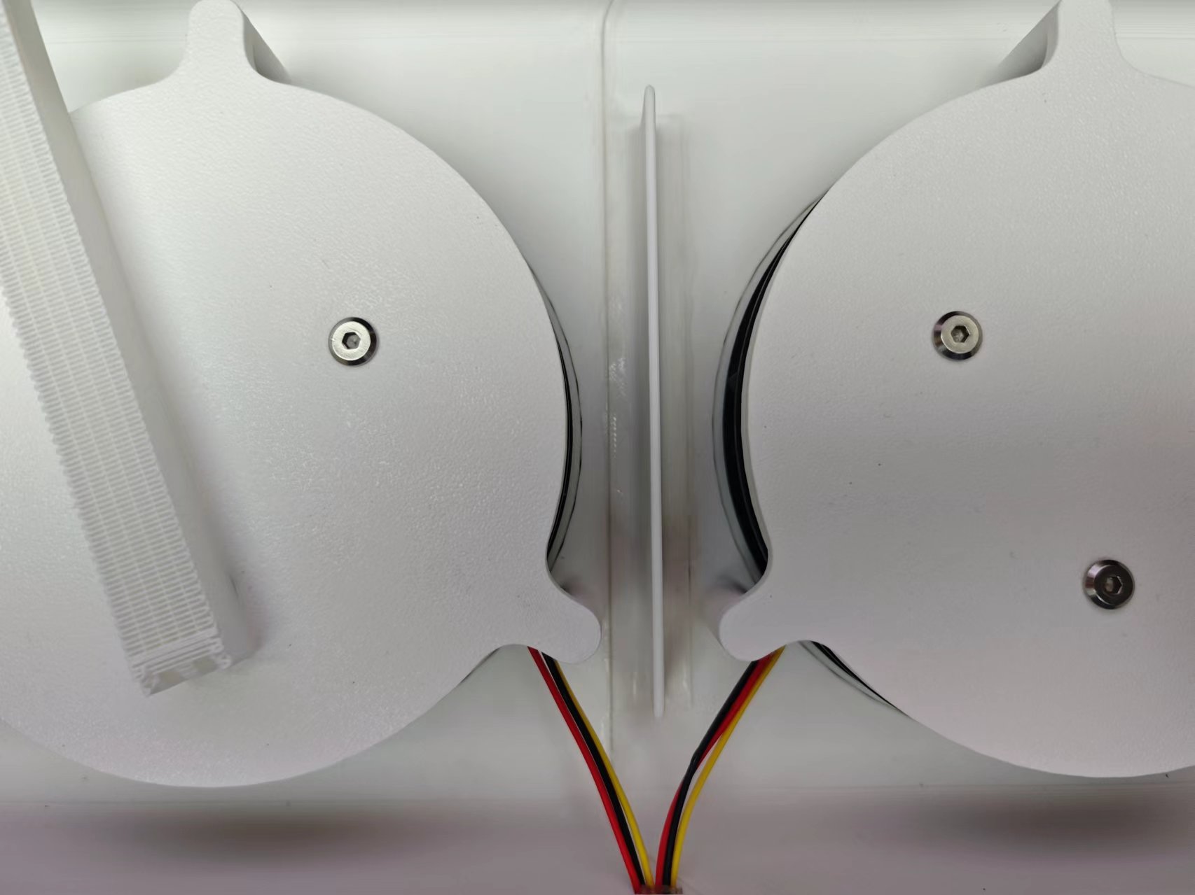

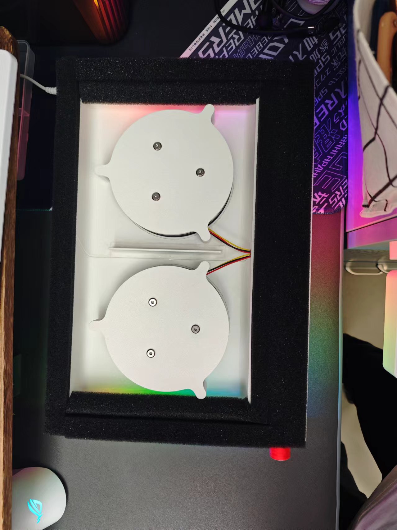

Assembly tips:
Before assembly, please complete other tasks, such as ensuring
high voltage is required in the area where the fan is located during code burning. The gaps in this enclosure are... This was my first time making buttons using 502 glue
. The inside was just a jumbled mess. The blue strip is an RGB LED strip (facing down, on both sides, with wires soldered in the middle) (you can keep the printed support and use it as filler on the LED strip). The folded filler is paper and heat shrink tubing, and the clump is hot melt glue. I was too lazy to buy a new 5-pin XH2.54 cable, so I just used DuPont wire and heat shrink tubing. Some people suggest using XH2.54 wire.
The clump is hot melt glue. Refer to the PCB file for the connector order.
Note: the positive and negative terminals of the XT connector are reversed here. Please pay attention when wiring. Refer to the following diagram (red line is positive).
Extend the XT cable to the right rear of the casing and connect it to the DC female connector. The DC female connector can be directly inserted into the model.
Finally, put on the cover and apply soft sponge and single-sided tape (the effect depends on your dexterity). That's it! (If the laptop is not wide enough to allow air to pass through, you can do the following: add a little sponge on both sides and stick it slightly inside the casing.)

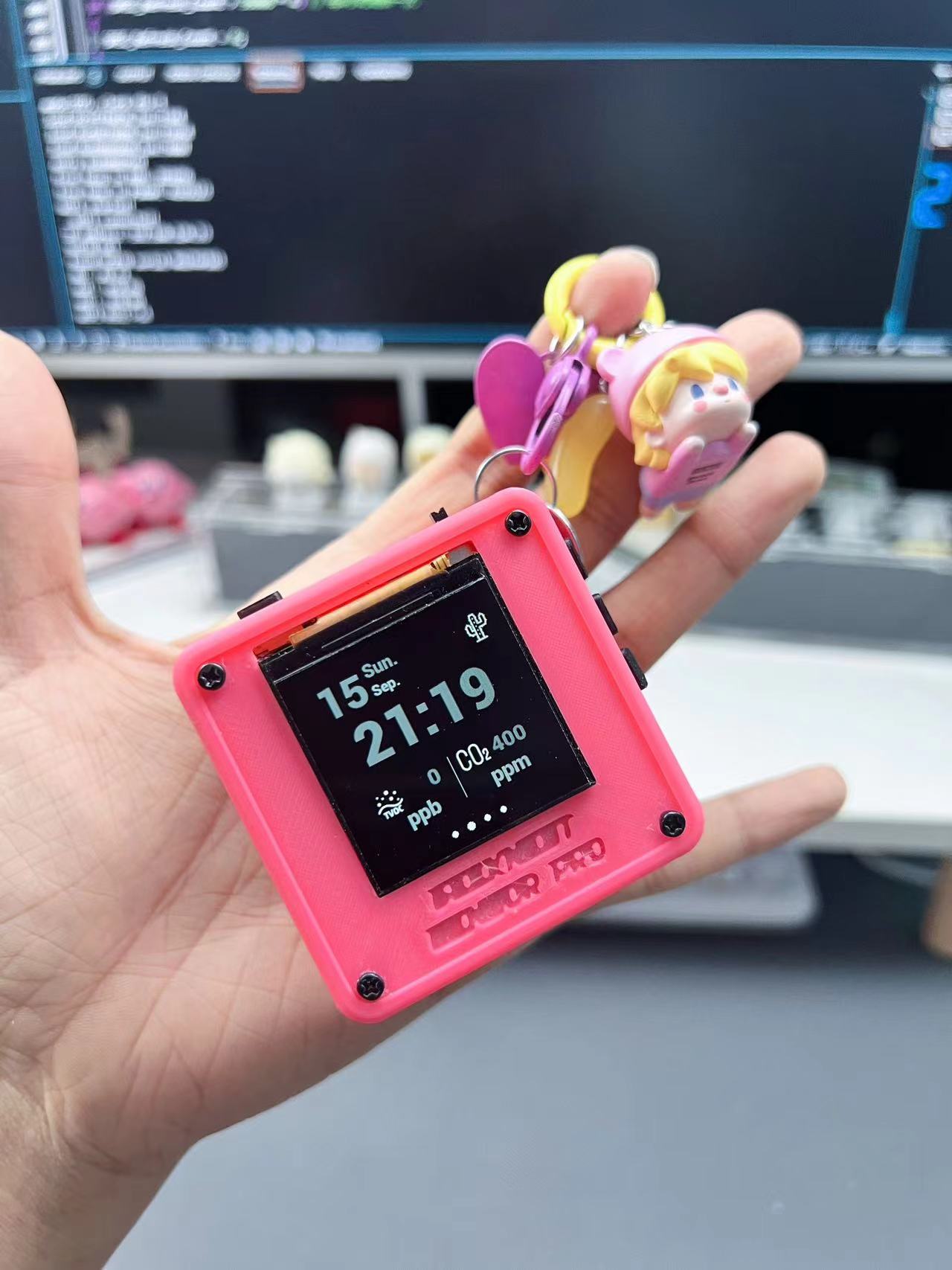

The final ESP32 toy: a sensor and space monitoring data aggregation station – a space environment manager.
This small toy integrates a temperature and humidity sensor, an air quality sensor, and a decibel sound volume sensor. It also supports obtaining geomagnetic and solar activity data from publicly available websites via WiFi. When connected to a charger as an external device, it can monitor the charger's operating status (charging voltage, current, and operating power).
Video Link:
Bilibili Video -- Function Demonstration
Project Introduction
It's been over a year since I started DIYing, and I've been using ESP series chips for MCUs. From not knowing what a serial port was at the beginning to handling the entire software and hardware of this project, it's been incredibly rewarding! So, to test my learning, I tried designing and building this little sensor toy.
Initially, I wanted this little thing to provide as much information as possible about the surrounding environment, including time, climate, ambient temperature and humidity, harmful gas concentration, noise intensity, light intensity, PM2.5 concentration, and even ionizing radiation intensity, which I had previously researched when building a Geiger counter.
Finally, considering the safety and size of the circuit, I decided to temporarily abandon the light intensity (I don't like it anymore), PM2.5 concentration (the module is a bit large), and ionizing radiation intensity monitoring functions (the boost circuit is a little dangerous & the Geiger tubes I researched are too large, and smaller ones are too expensive). I only retained the temperature and humidity sensor (SHT30), CO2, TVOC, and alcohol concentration sensors (SGP30), and the decibel sensor (LM2904). Doing only this felt a bit tedious, so we also incorporated inspiration from HAM fans—space environment monitoring data. The National Space Monitoring Center of the Chinese Academy of Sciences releases various interesting space data from its Space Environment Forecasting Center, some of which can affect radio wave transmission and are therefore familiar to some HAMs.

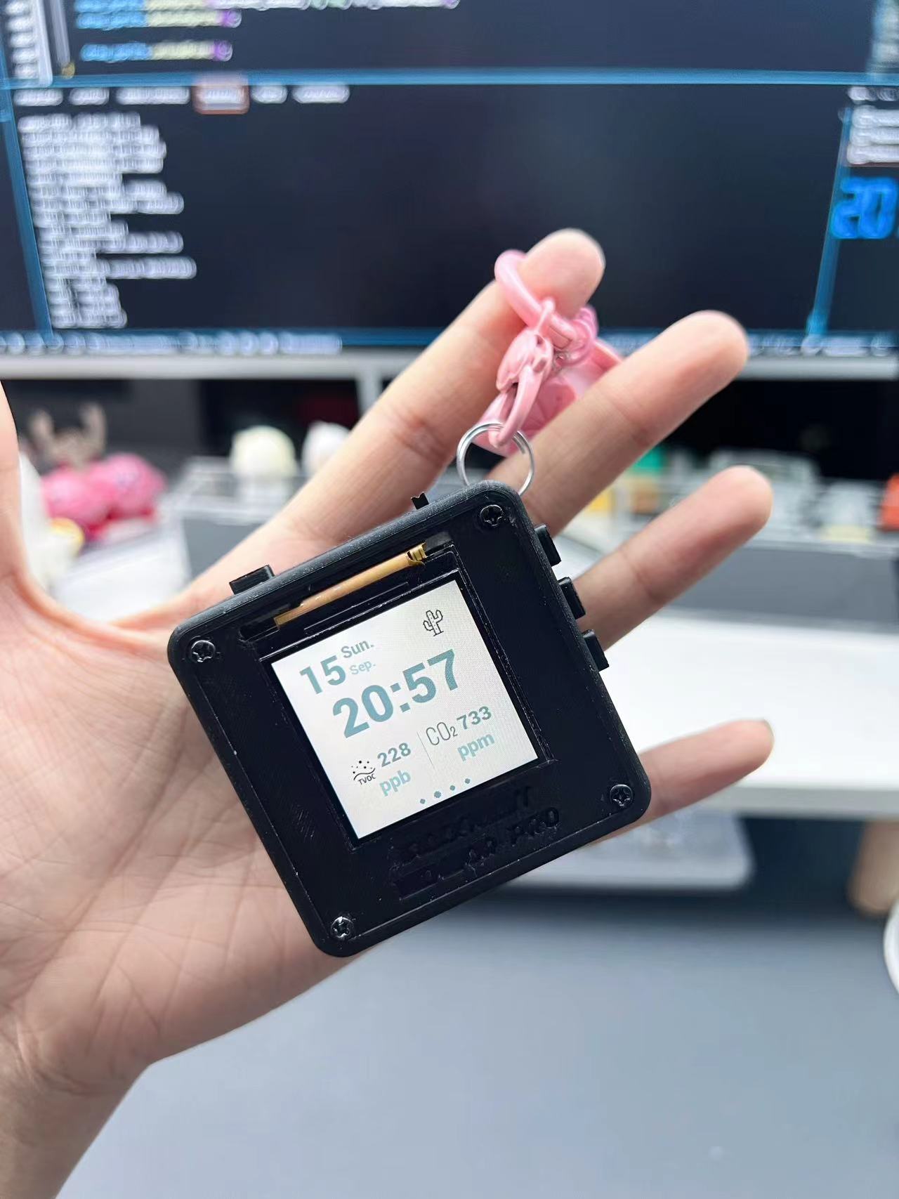

Screen Display:
A total of 4 pages, rotating periodically.
The ambient temperature page displays the date, weather, ambient temperature, humidity, and noise level in decibels (minimum value is 40dB due to sensor limitations).
The air quality page displays the date, time, TVOC, and CO2 concentration data
. The spatial environment page displays geomagnetic and solar activity data.
The charger status monitoring page displays the charger's charging status and the voltage and current output of each charging port. The charger currently uses a self-developed 1-to-3 charger (not open source). If you want to achieve similar charging interface data monitoring, you need to ensure that your charger is programmable.
There are two display color schemes: "Daytime Mode" and "Nighttime Mode," automatically switching between them at 7 AM and 7 PM respectively.
To use:
after tossing the switch in the upper right corner to the left, long-press the top right button 1 to open the administrator account. Other interactive functions are not yet designed.
