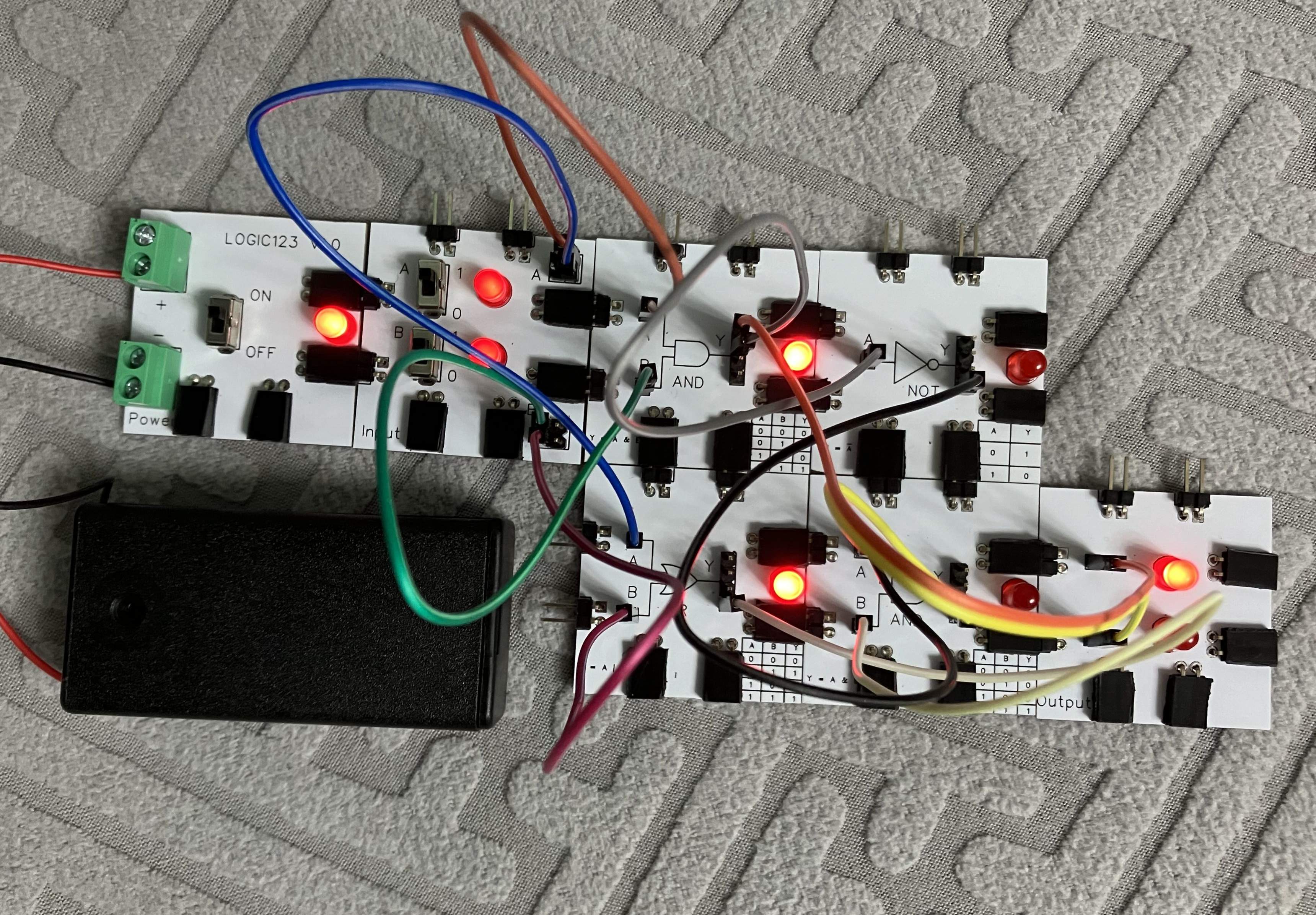

This circuit employs a modular design, comprising six basic modules: power control, input, output, AND gate, OR gate, and NOT gate. It can be freely expanded and combined to achieve various gate circuit combinations. Further expansion with additional gate types, such as NAND gates, NOR gates, and XOR gates, is also possible.
The cover shows a 1-bit adder composed of two AND gates, one OR gate, and one NOT gate.
Power is supplied by a 3V battery, and all components are provided by LCSC.
The default PCB design is a single board, requiring manual cutting. A V-CUT can be added, using six boards, which will significantly increase the PCB cost.
