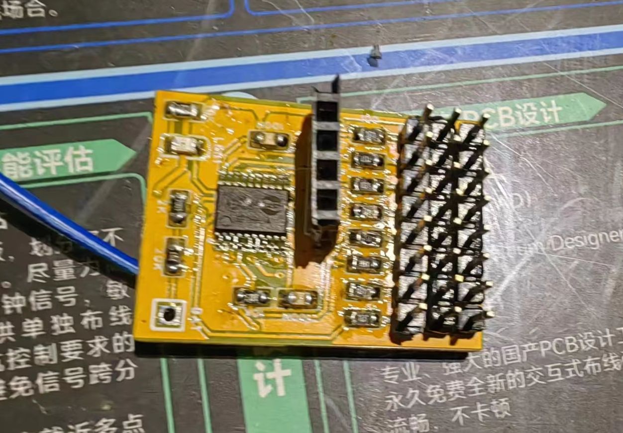

The wiring looks terrible. I rewrote the code myself using the open-source CRServoF to adapt it to the air001 chip.
Thanks to LCSC for providing the board for free; one air001 chip, about 10 resistors and capacitors, one LED, pin headers, and headers cost less than 1 yuan.
Due to the accuracy of the voltage divider resistors, you'll need to adjust the coefficients yourself.
When connected to the flight controller, there's a 1-2 ohm fluctuation in the data across each channel. I wonder if conversion modules costing tens of yuan have this kind of fluctuation. If anyone knows, please let me know in the comments.

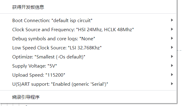

The code is attached;
the programming parameters are shown in the image.
Future plans:
1. Optimize the programming and parameter tuning interface.
2. Change the PWM interface order to make the wiring more elegant.
3. Support PPM output in the code.
