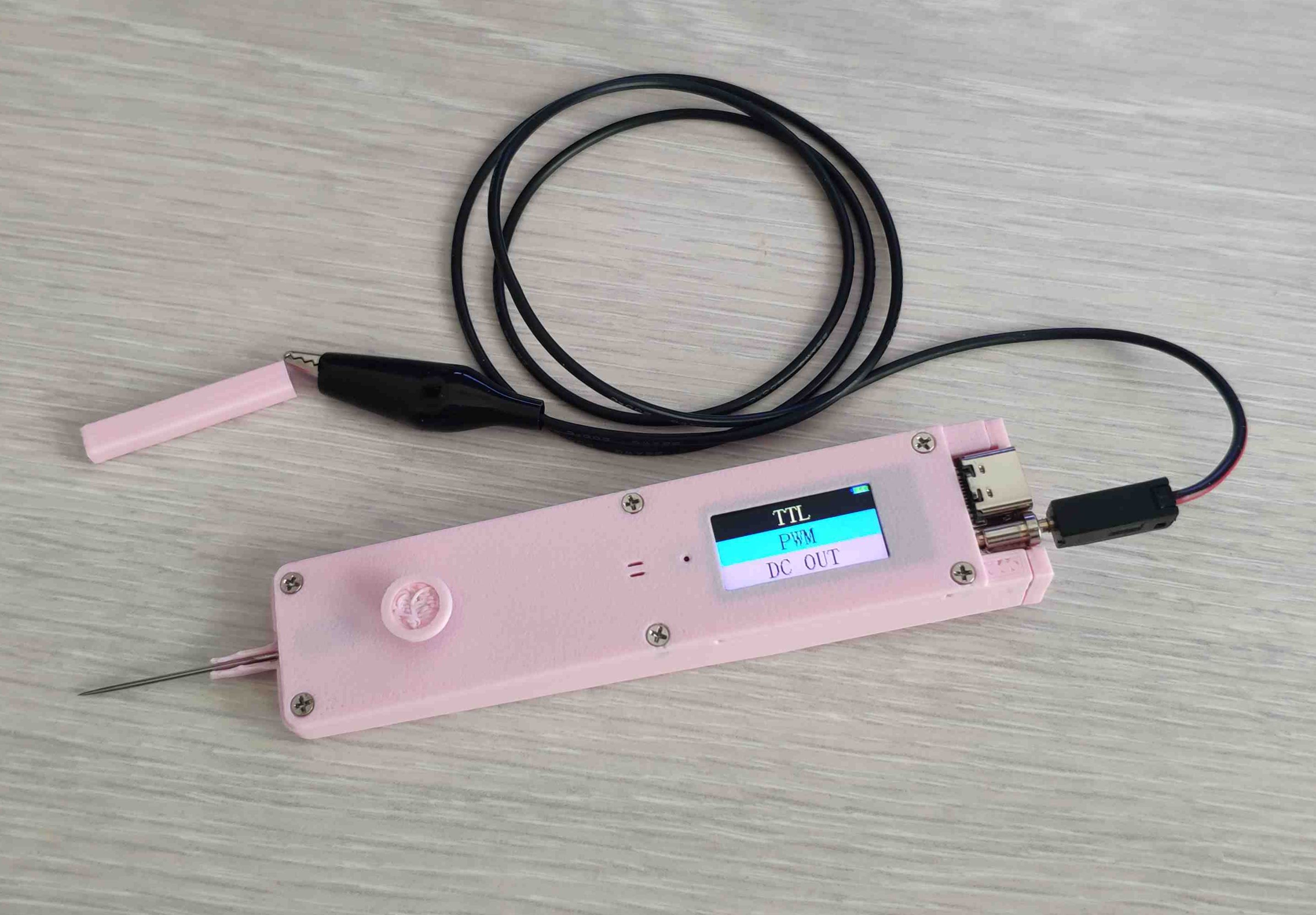

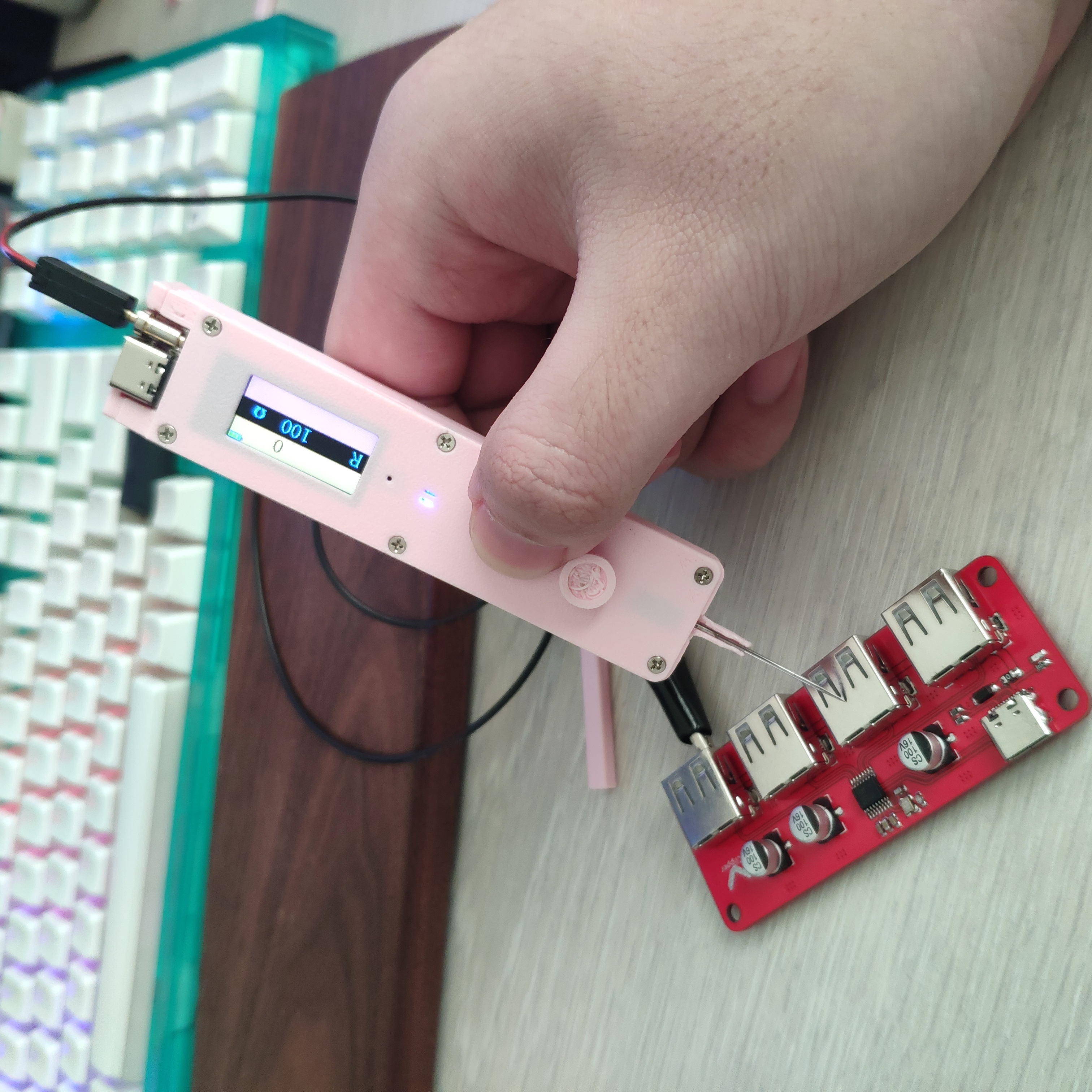

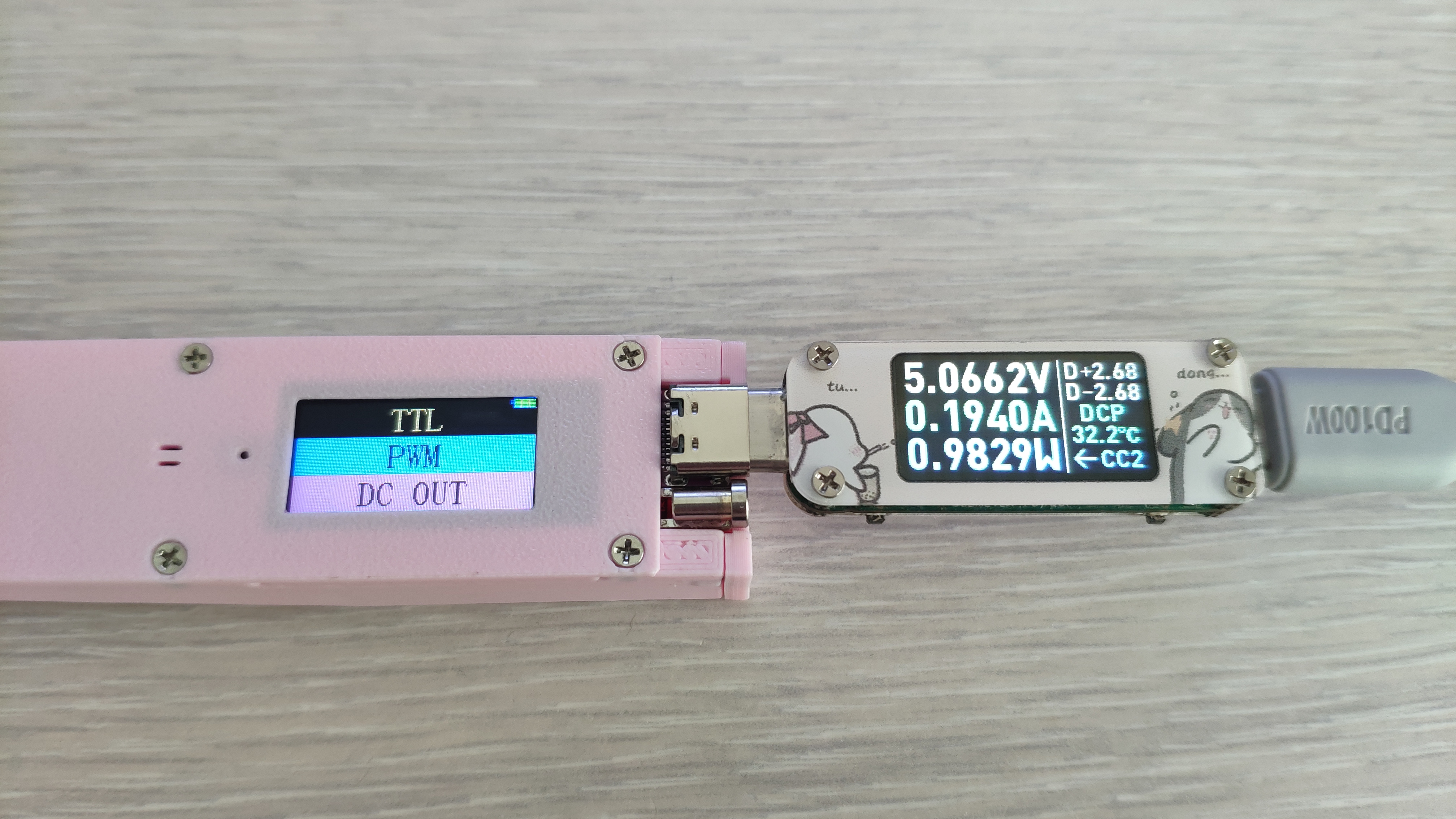

This is a replica of the CW32 multi-functional test pen,
featuring a 502030 battery
and a CM2*3 screw and M2*2.5*3.5 thermoforming nut for
casing fixation. See the attached file for specifications.
The pen tip is replaced with a sewing needle to reduce costs.
The attached program is a modified version of the original; please refer to the original project for the original program.
Modifications: Adapted to HannStar panel screen driver.
No other changes.

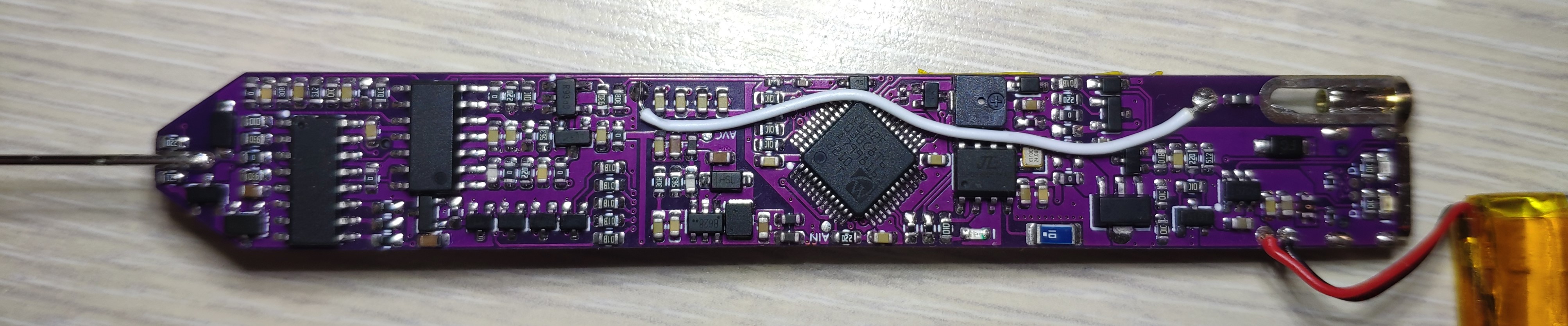

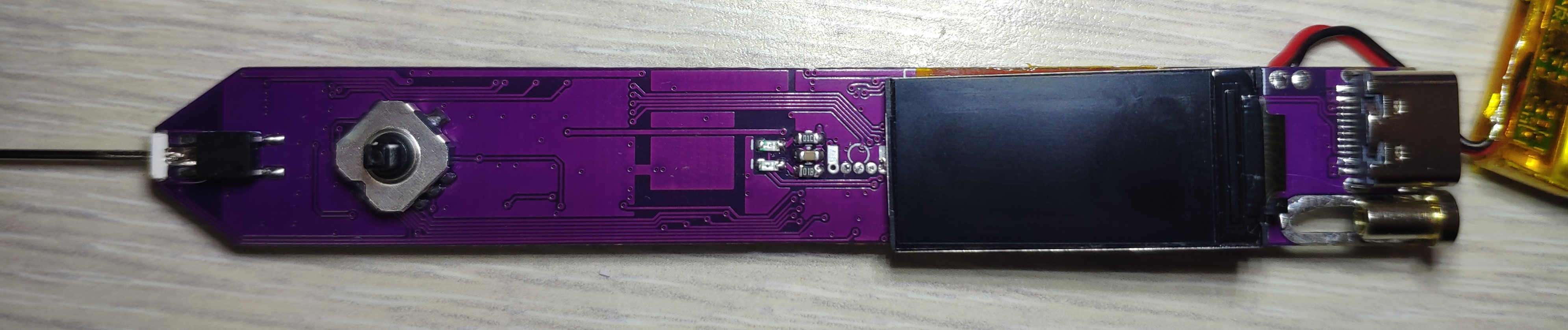

Soldering diagram

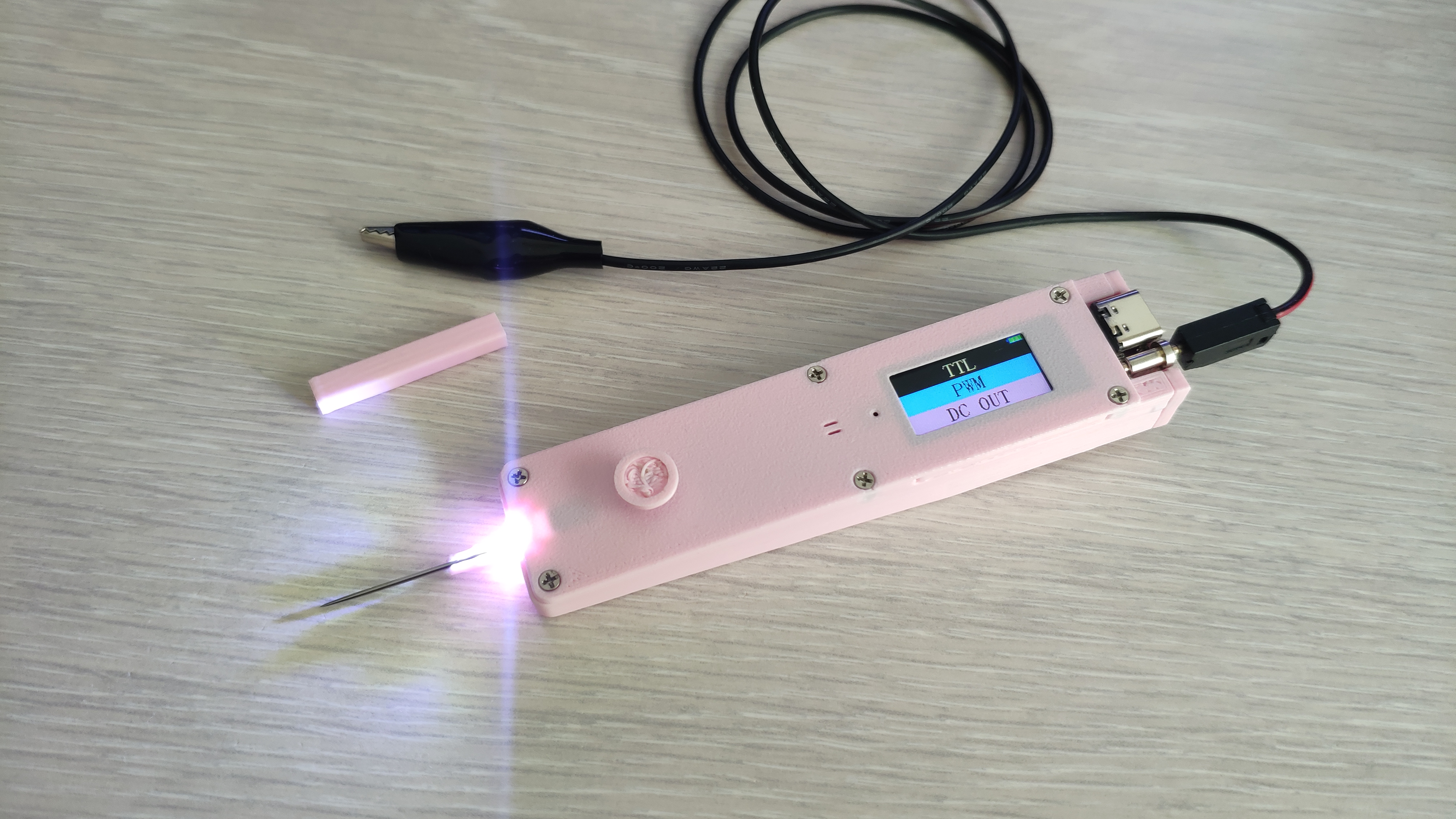

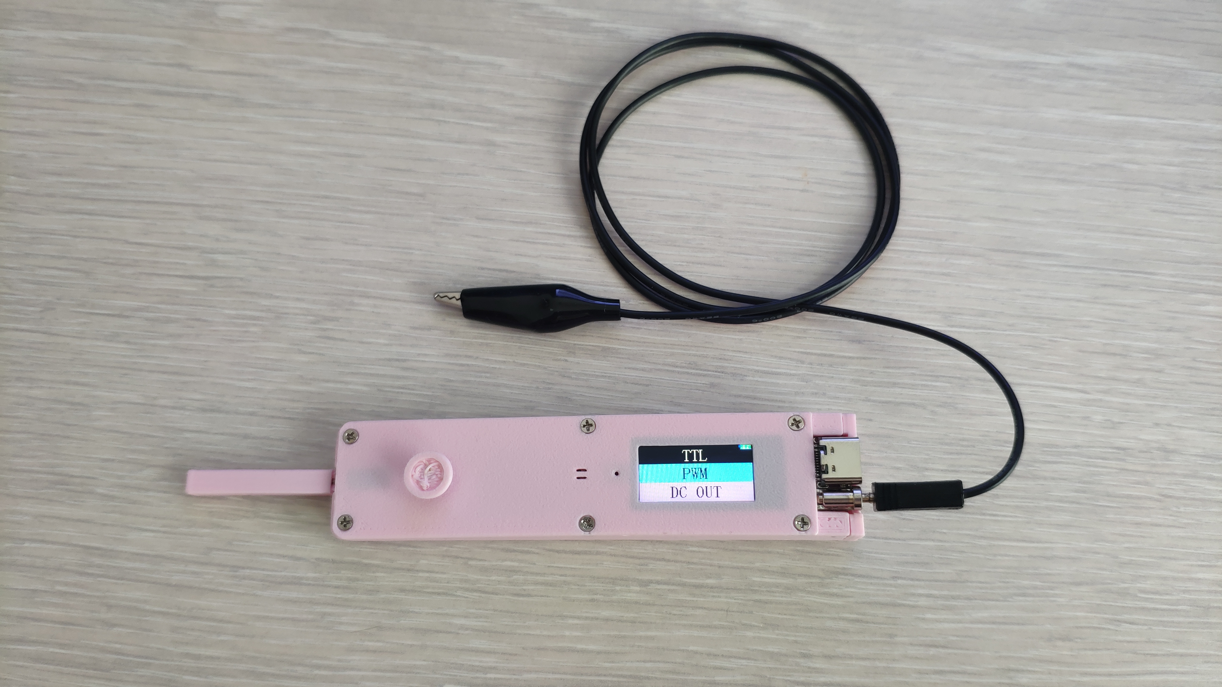

, overall appearance,
head light test,

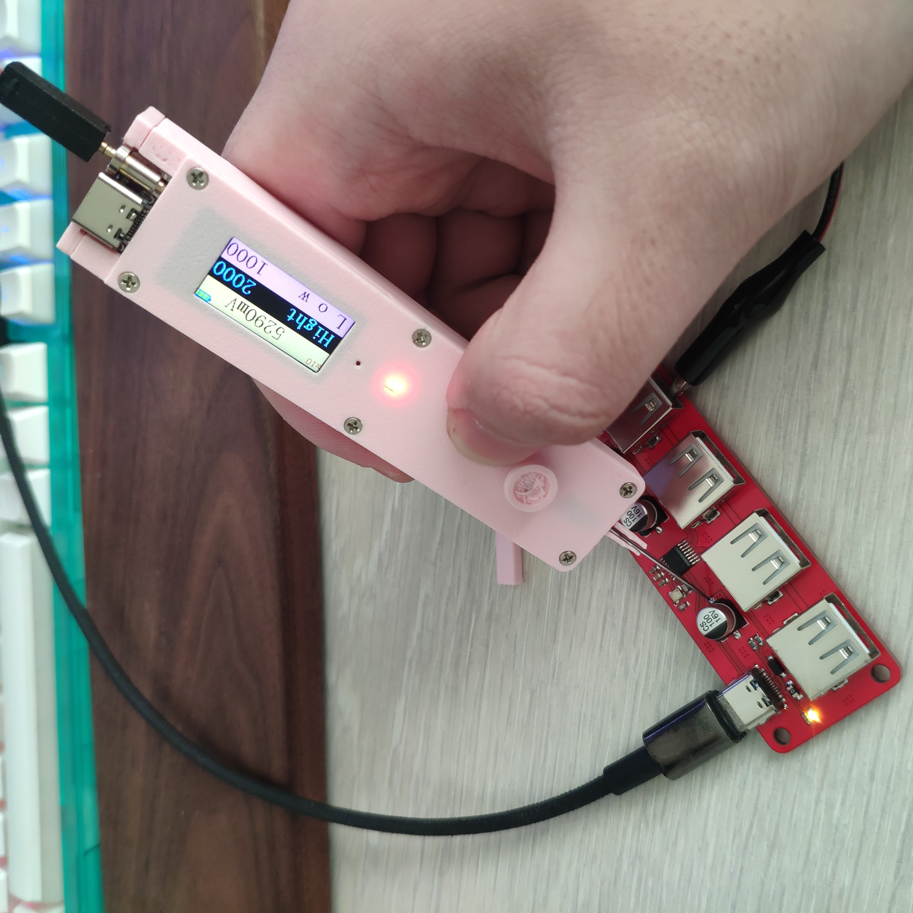

low-level test

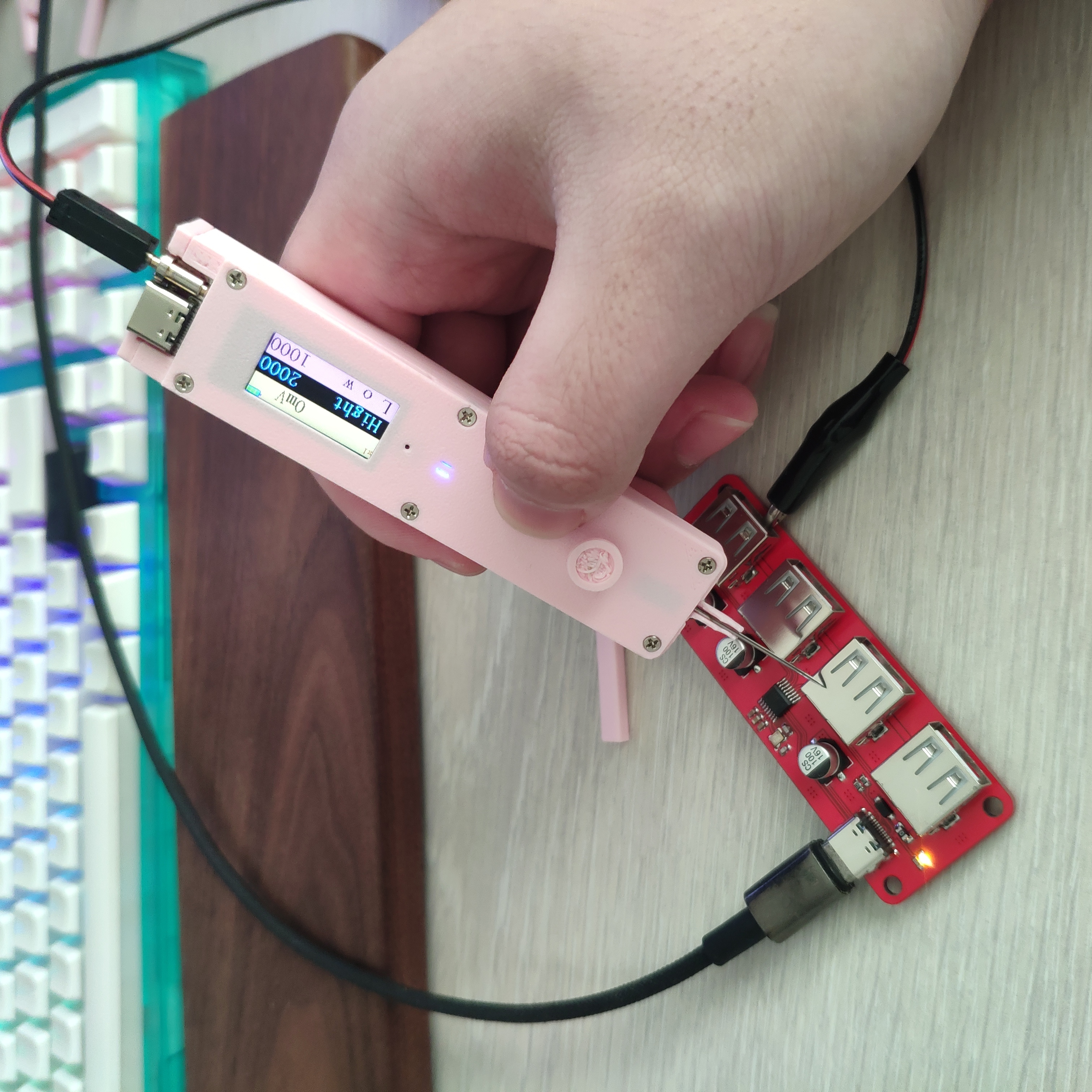

, high-level test

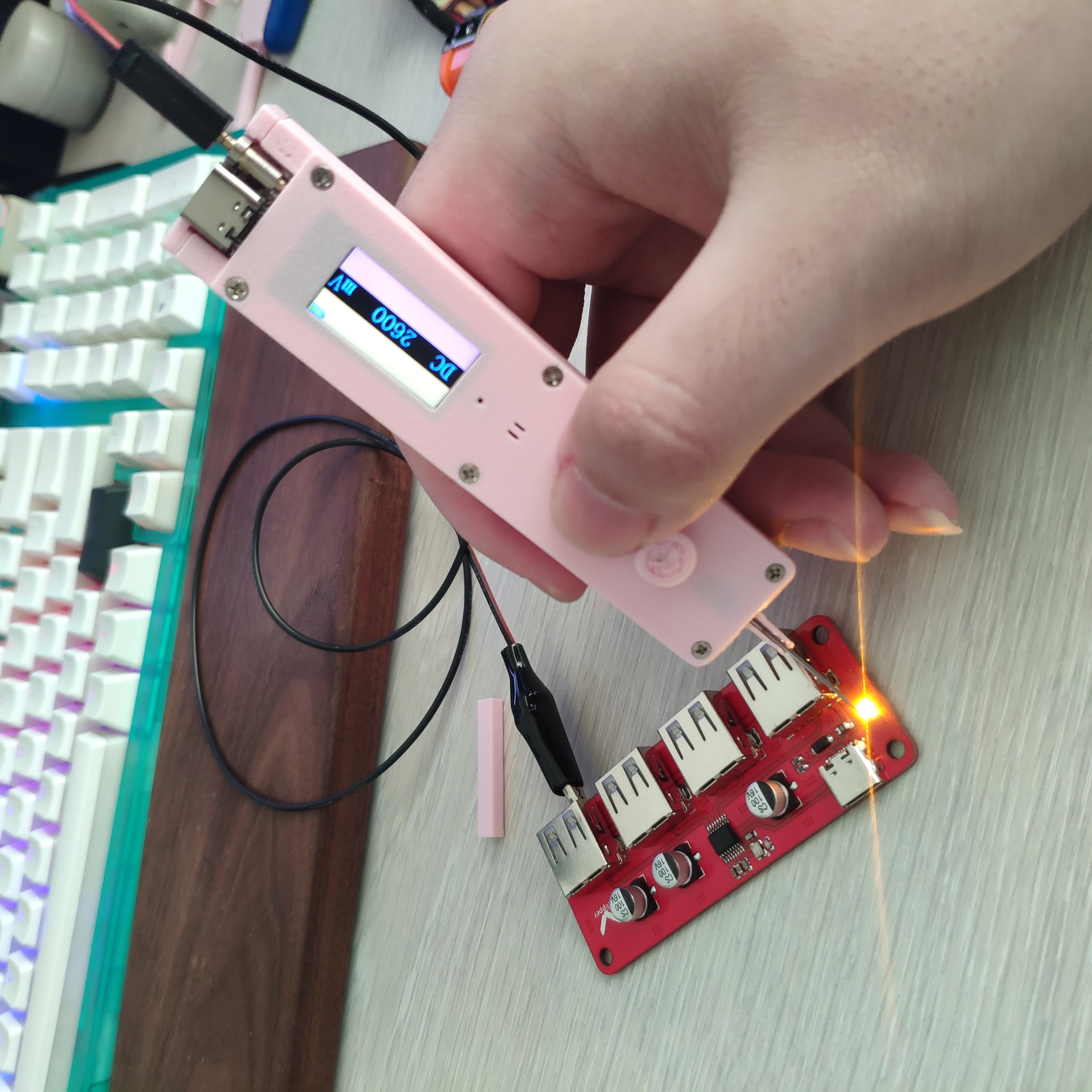

, DC output test,
continuity test,

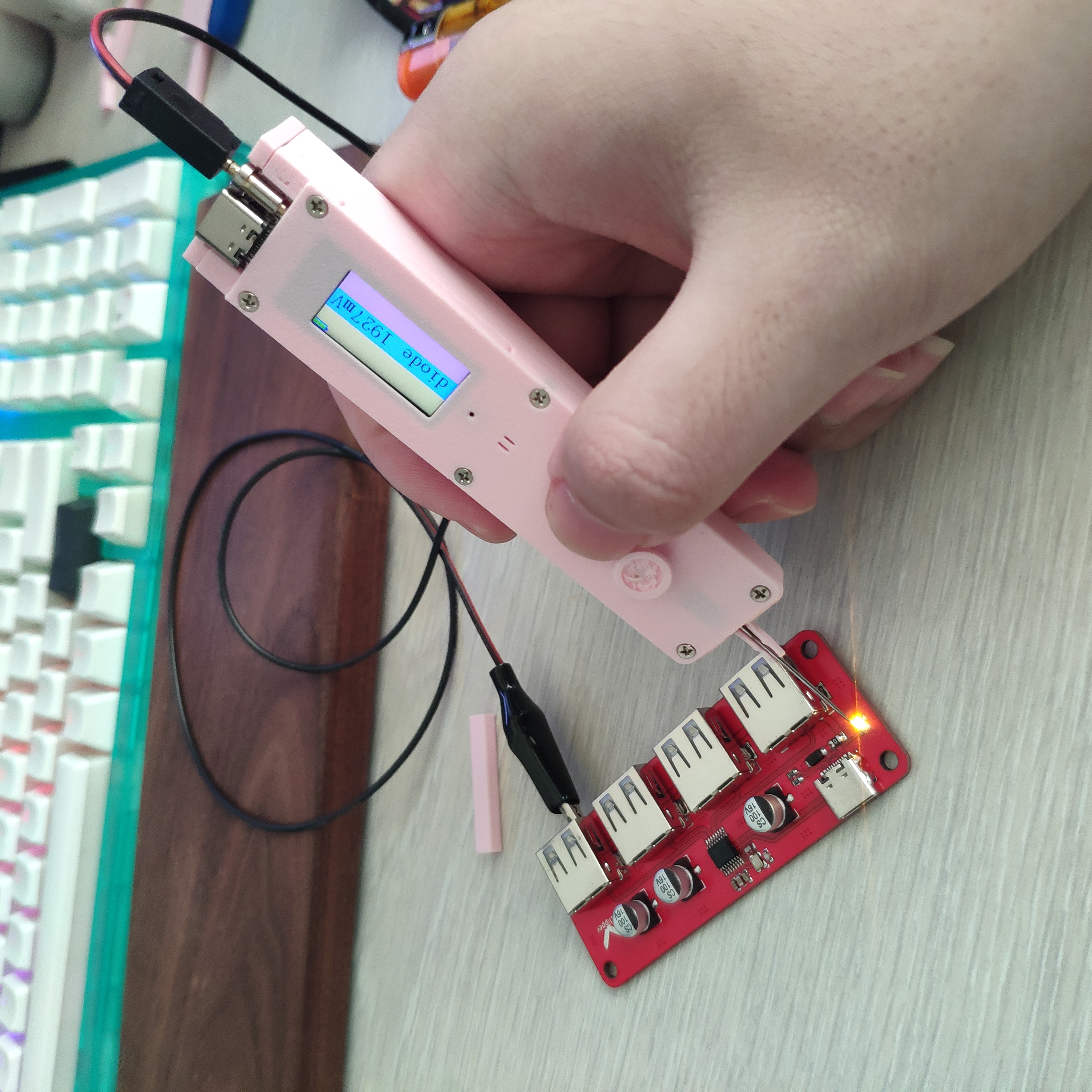

diode test,
charging test.
