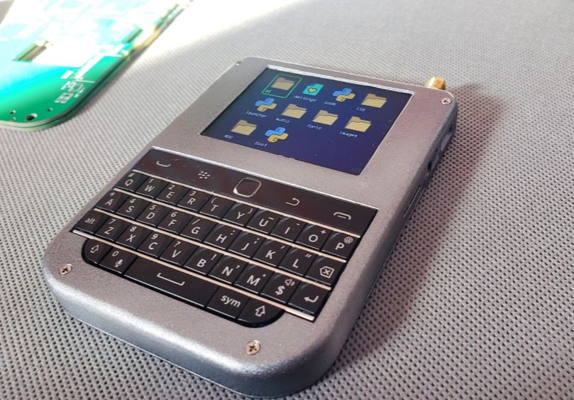

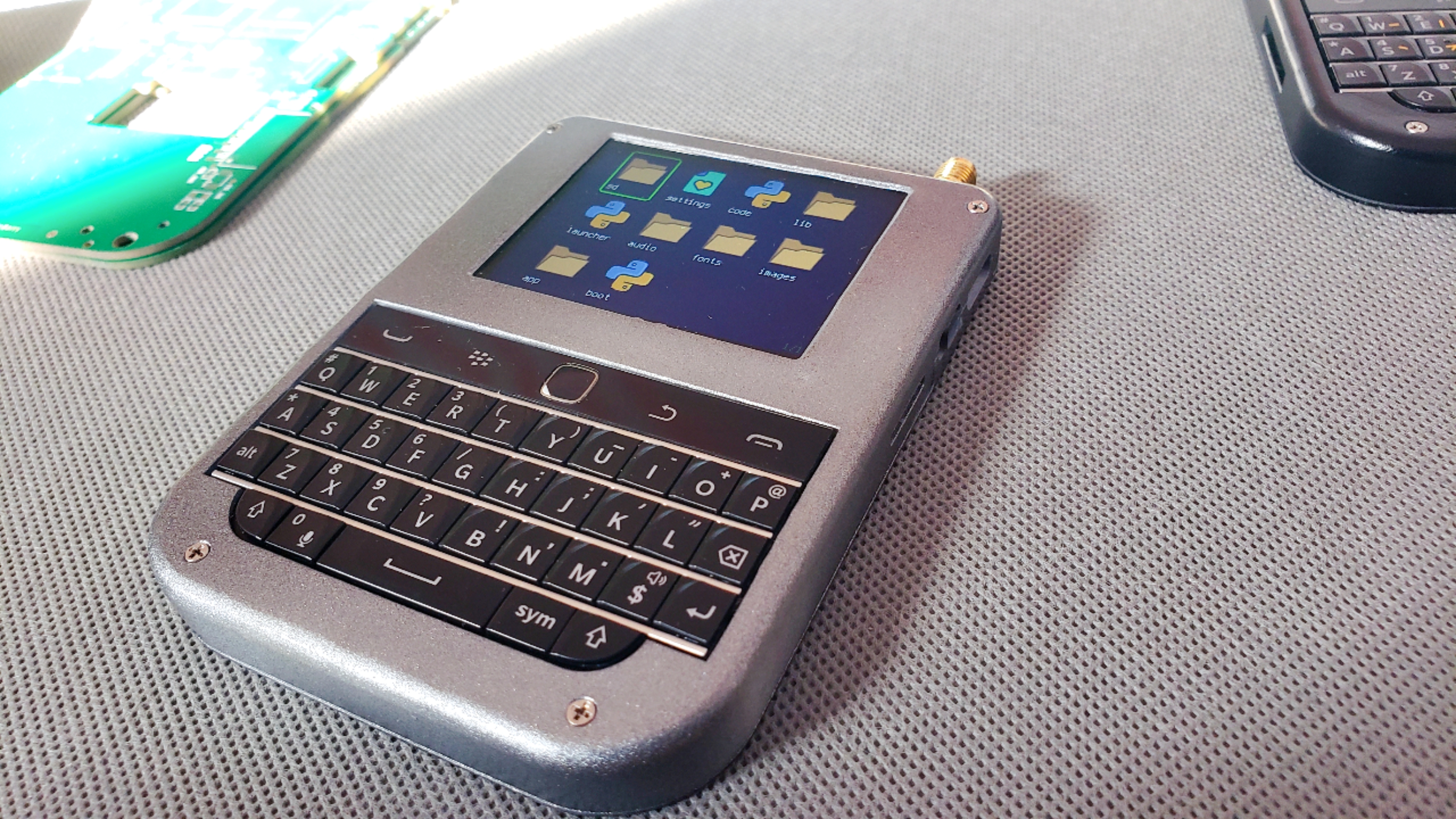

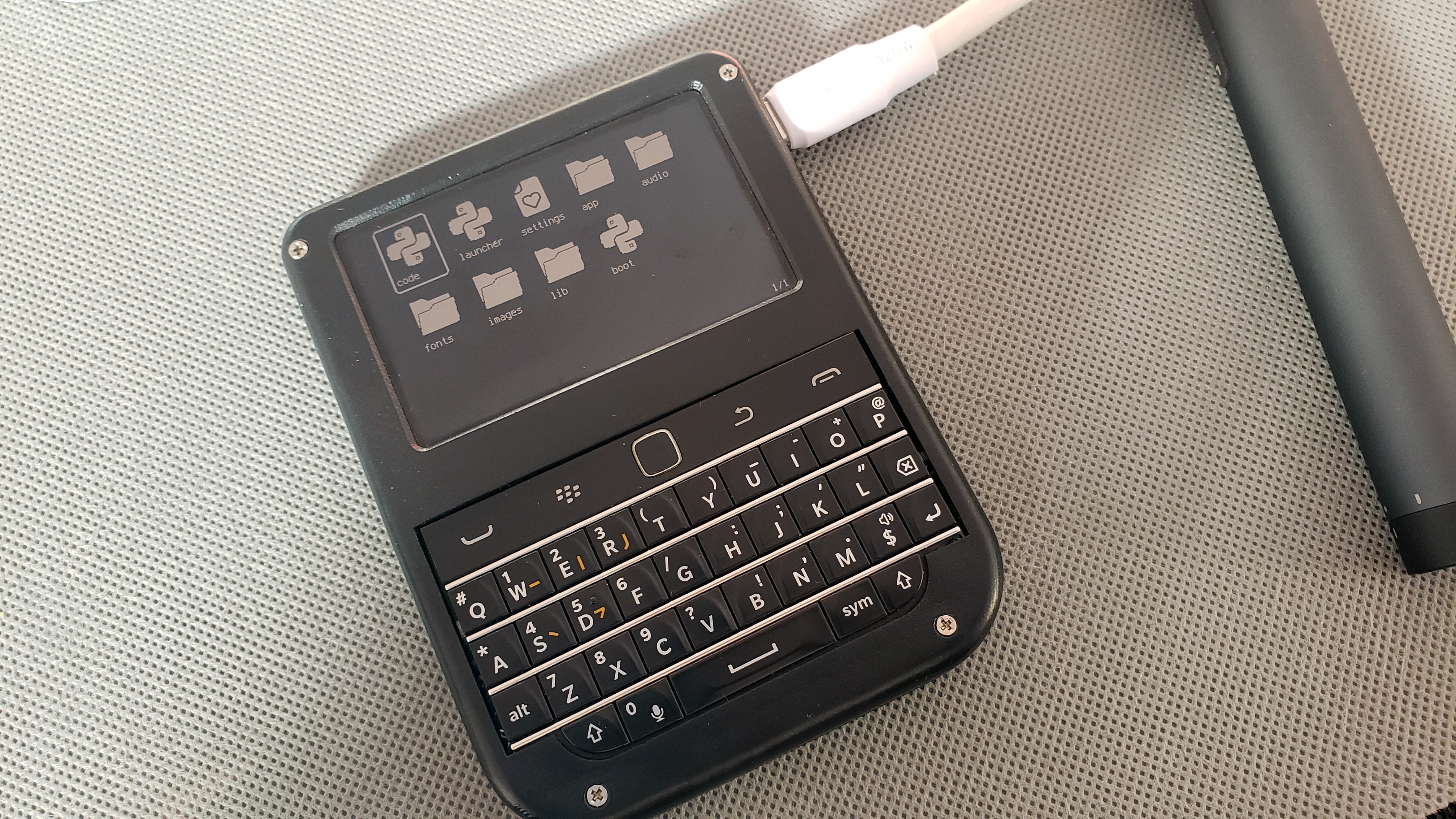

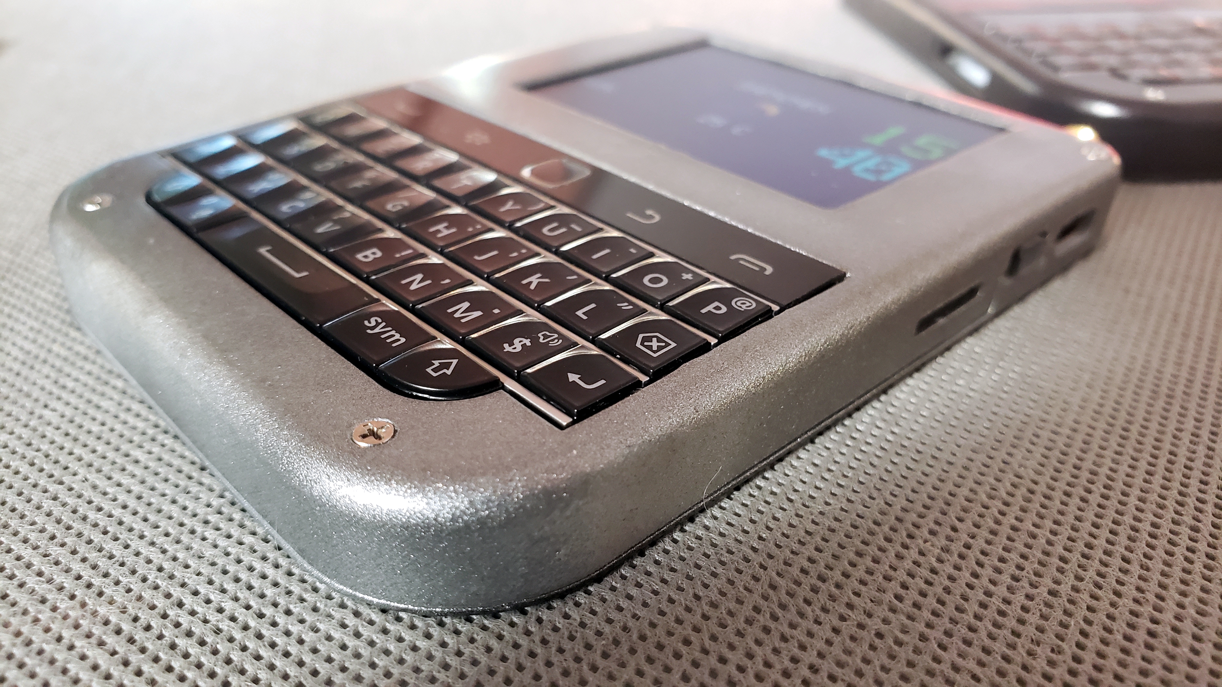

* 1. Project Function Introduction:

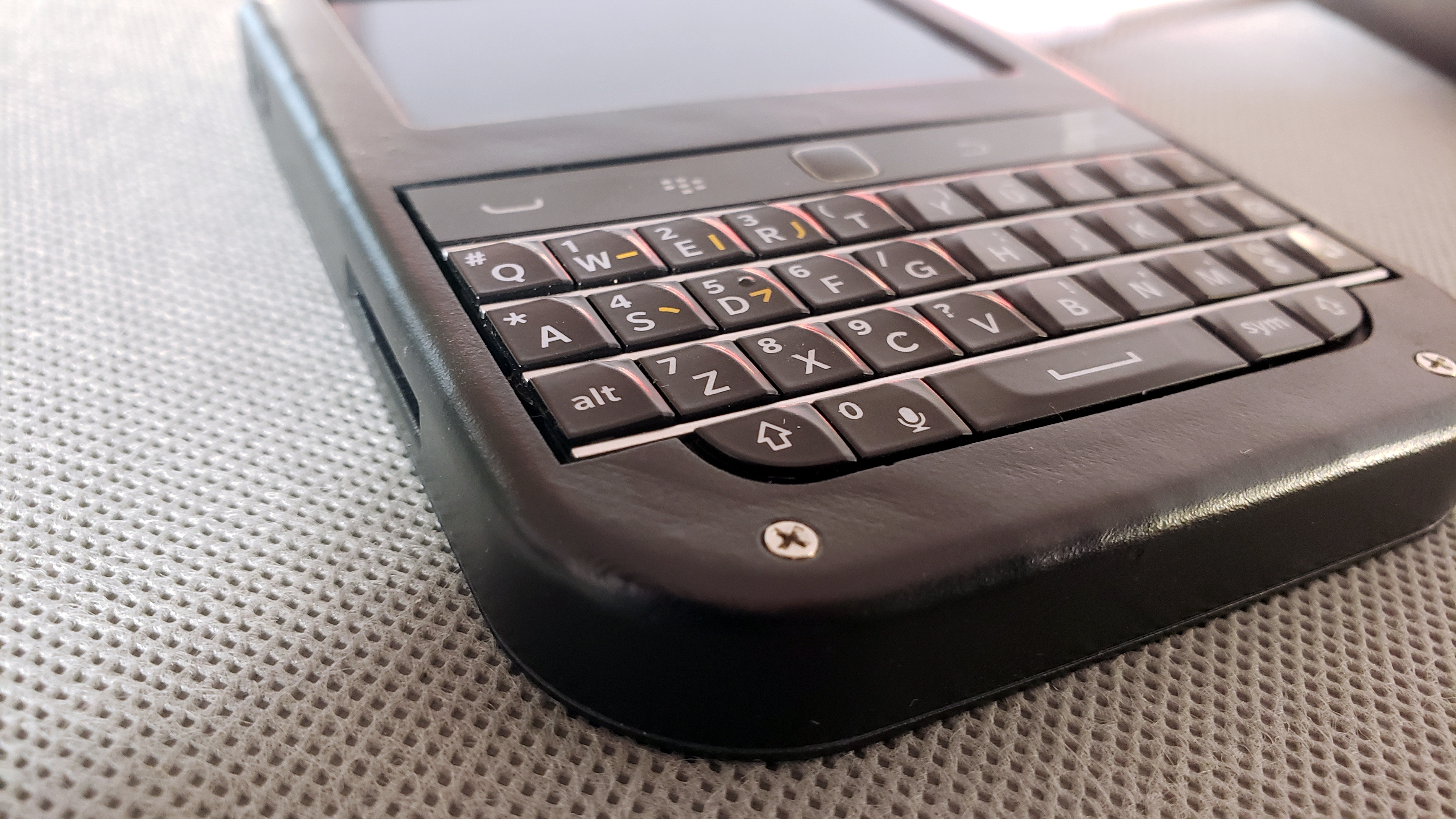

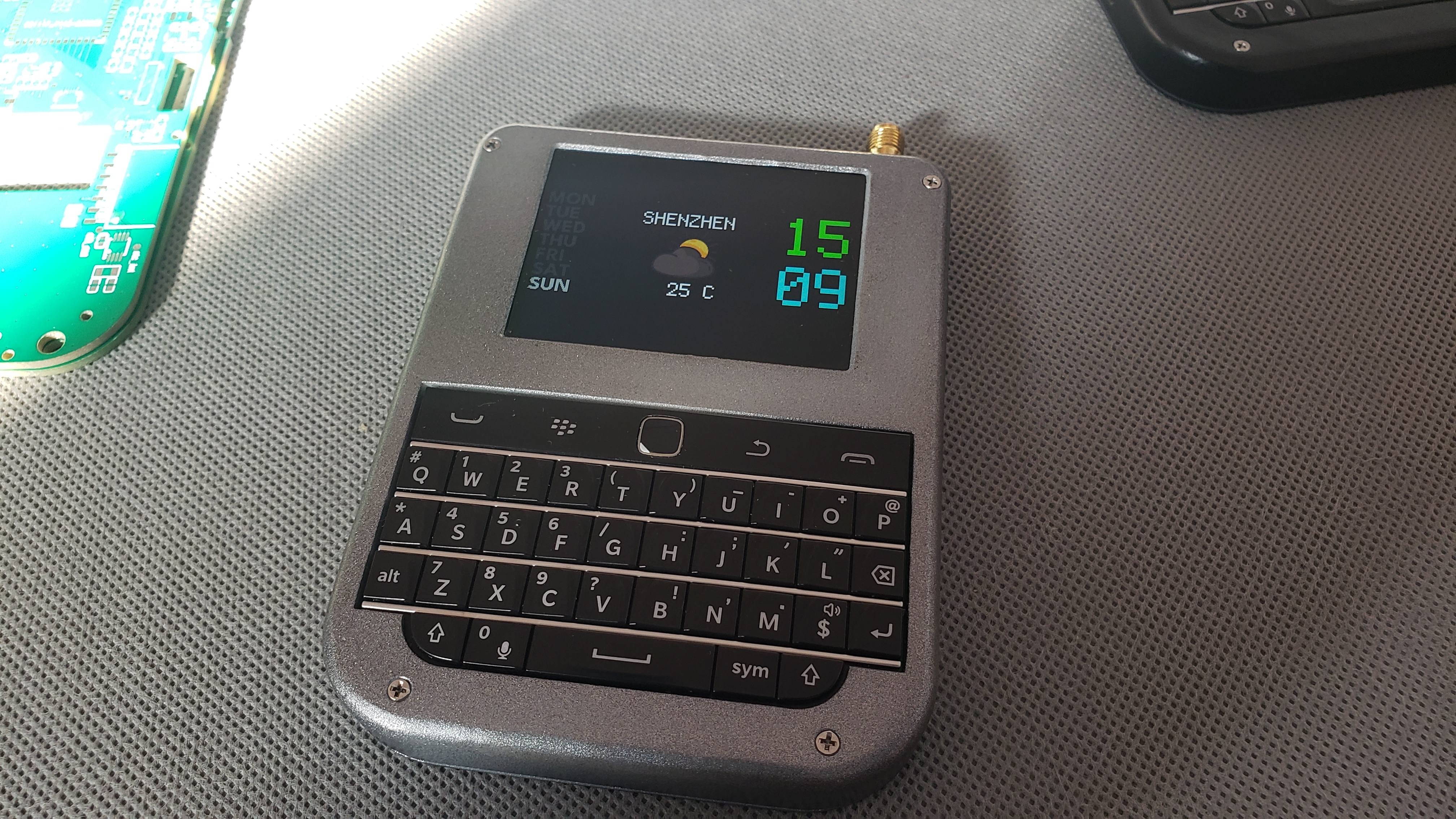

MagicBerry is a pocket-sized gadget with a full keyboard, equipped with a 2.4-inch 320x240 pixel IPS LCD display, a mini keyboard with a touch area, a microSD card slot, a LoRa module, speakers, lithium battery charging management, and an ESP32S3 dual-core processor;
it is a programmable terminal that can be turned into a standalone tool through programming skills. For example, it can be used for serial port monitoring, information sending and receiving, etc.;
this is also a development board for learning programming;
life is short, I use Python, videos

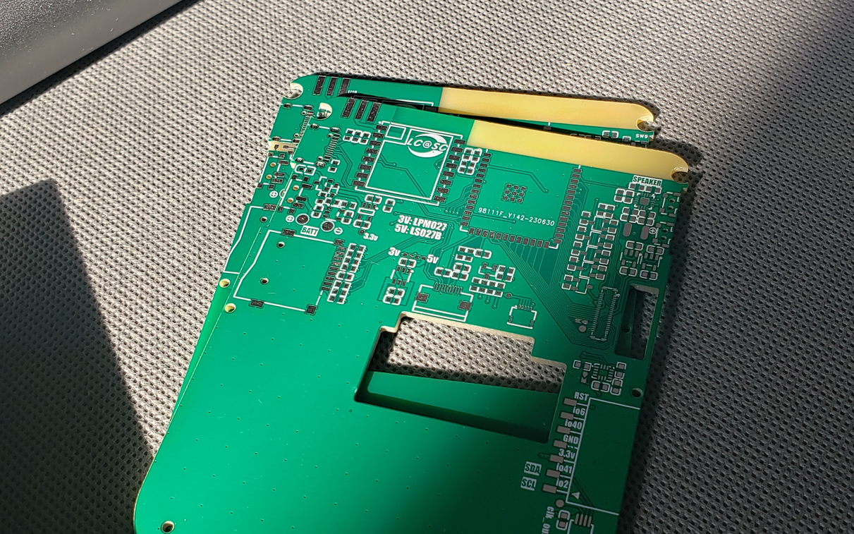

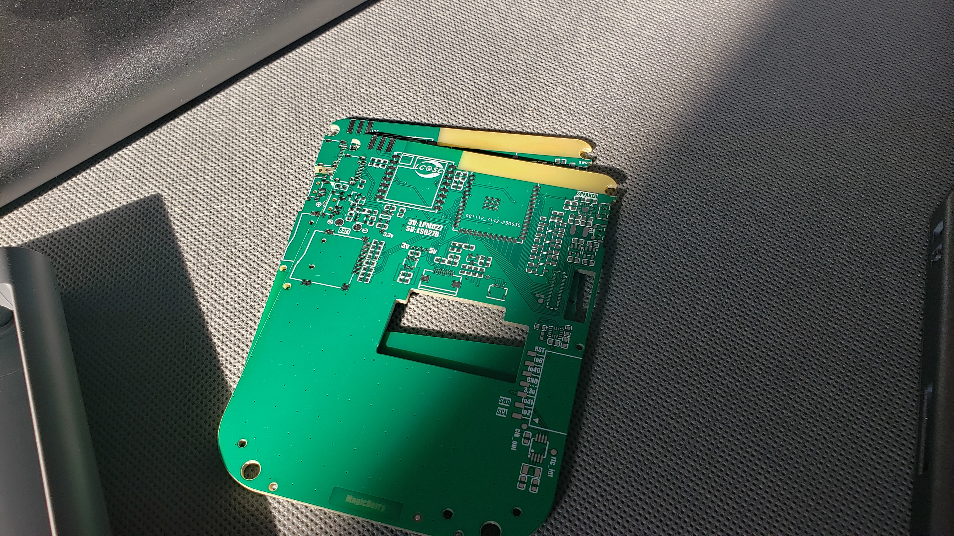

*4, hardware part:

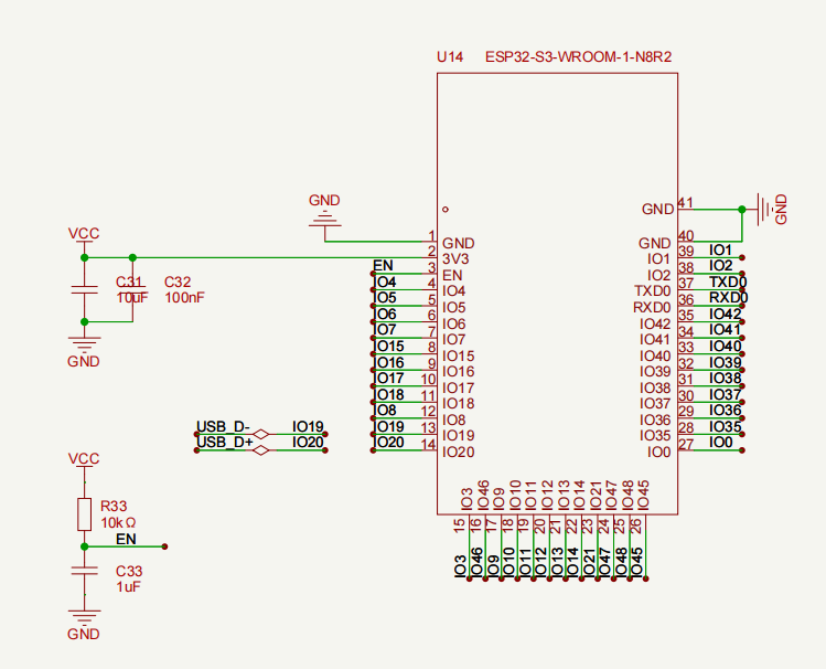

this project mainly uses Espressif's ESP32-S3 as the main controller, 8MB FLASH, 2MB RAM,
and uses IO to directly control the matrix Q20 keyboard;
the display part uses a low-cost 2.4-inch IPS color screen, controlled by SPI bus;

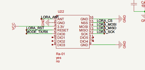

the lora module uses the Aixinke RA-01 module;

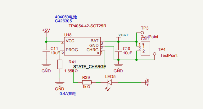

equipped with a lithium battery charging circuit, supports USB Type-C and lithium battery power switching
, one RTC chip to ensure calendar updates in power-off state,
one 6-axis motion sensor
supports microSD card
USB. Type-C, supports firmware or file drag-and-drop updates.
Hardware introduction:
ESP32S3 is used as the main controller, which can well support CircuitPython, making it very convenient for programming learning and practice, and has rich ecosystem resources.
TP4054 is used to charge the battery.

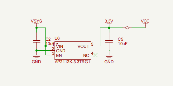

AP2112K provides 3.3V power to the entire circuit.

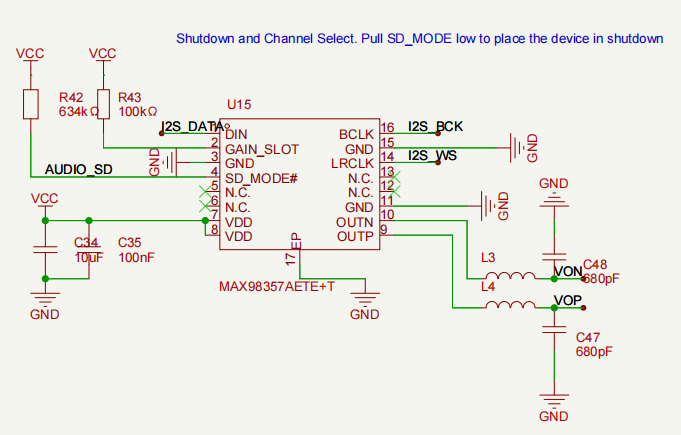

MAX98357 provides speaker output and adopts I2S interface.

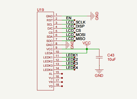

The display uses a 2.4-inch IPS color screen or a 2.7-inch memory LCD with SPI interface.
The LoRa part uses the Ai-Thinker RA-01 module with SPI interface.

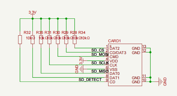

The SD card also uses SPI interface, sharing SPI pins with the display and LoRa module.

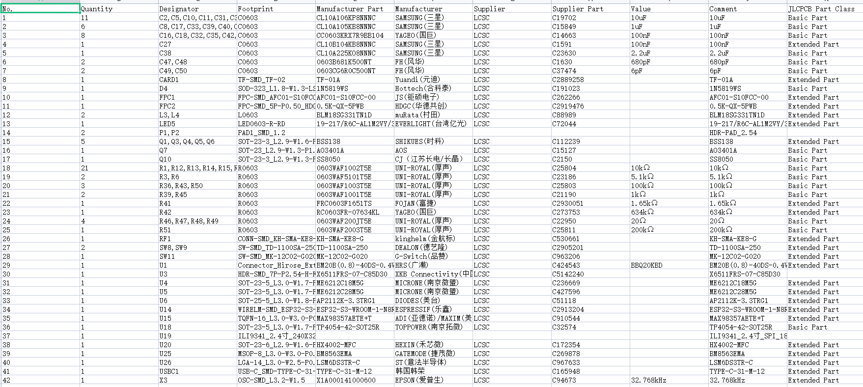

*6. BOM List
Note: BOM list involved in the project. Please upload a screenshot of the BOM here. Please upload the list details in PDF format as an attachment. It is recommended to include model, brand, name, package, procurement channel, purpose, etc. The specific content and format should clearly express the project composition.
