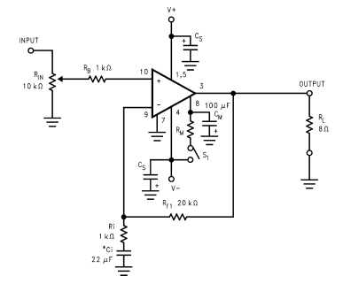

Now let's look at the circuit diagram... National semiconductor engineers have proposed the following basic application circuit.

Now we come to the circuit diagram section... The basic application circuit recommended by the National Semiconductor Engineers is as follows.

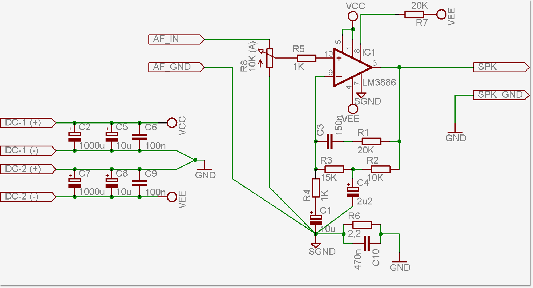

The circuit diagram is remarkably simple and easy to implement. No modifications were made to the signal lines to avoid introducing noise. In the circuit, Rin is the input level potentiometer, Rb is the current-limiting resistor, and Ri and RF1 are the gain resistors. This application achieves a gain of 20K/1K = 21 times (26.4dB). The 22μF capacitor ensures feedback gain flatness by providing an initial roll-off of approximately 7Hz, eliminating low-frequency speaker propagation limitations.
Our application is as follows:
As can be seen, the negative feedback circuitry has been significantly modified. This results in a peak gain of approximately 7dB in the 30Hz-70Hz frequency range, and an increase of approximately 34dB at 30Hz. Designed by Nico Ras, this circuit is suitable for 16 or 20cm wide, 10-15 liter sealed enclosure subwoofers, effectively compensating for the frequency response drop that typically begins at 70-80Hz, and maintaining the low-frequency cutoff (F3) in the 40-50Hz range. The advantages are evident when considering high-quality compact subwoofer systems with an F3 close to 40Hz. However, users seeking extremely low frequencies (20Hz) will need to design an active subwoofer system separately. The application circuit delivers an average output of 65W RMS power with a 26V DC power supply, a 4-ohm speaker, and a 2Vpp input signal. Users with 8-ohm speakers can increase the power supply voltage to ±38V. These values ​​can also be used with lower voltages.

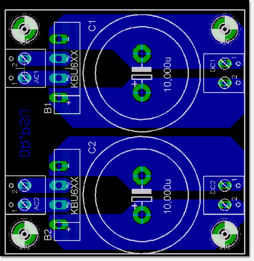

The power supply circuit is also simple:
A "π-type" filter is constructed using dual secondary transformers, two KBU6 series (6A) diode bridges, and two 10000μF inductors and capacitors. A general rule is that 2200μF of capacitor per ampere is sufficient for the voltage regulation requirements of Hi-Fi applications; in this example, 4700μF of capacitor per ampere is used. Based on an average of 2 amperes per channel, it is recommended that users operating at continuously high power (above 80%) use two 10000μF capacitors per channel.
Transformer Selection: Toroidal transformers are commonly used in Hi-Fi applications. These transformers are more expensive (60-80 Euros) but save space, and their low flux leakage allows them to be installed in the same enclosure as the amplifier. If the amplifier and transformer are placed in separate enclosures, a standard EI type transformer can be used. The transformer specifications must at least meet the following requirements:

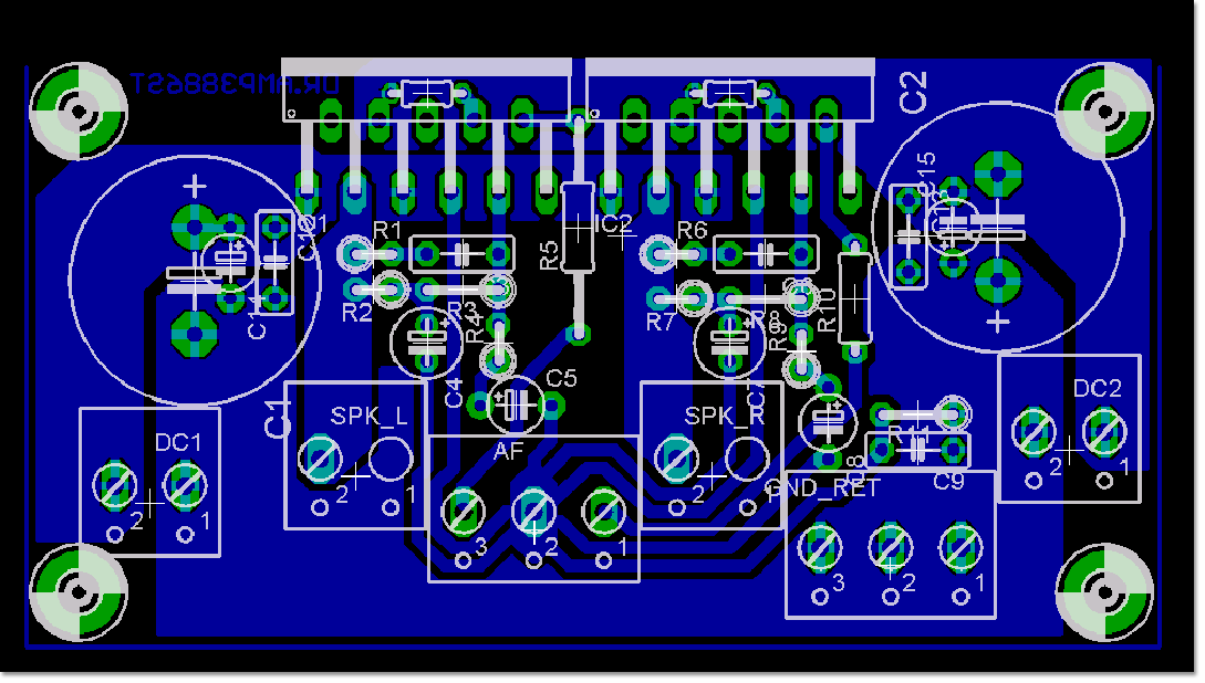

Implementation:

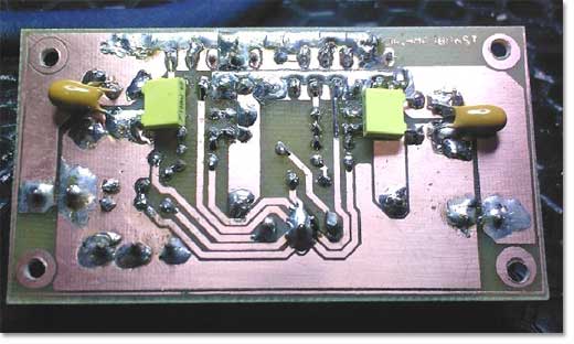

The circuit is made very simple to implement through a carefully designed printed circuit board.
The front view shows a compact structure, though slightly crowded, but far removed from noisy design. This characteristic is particularly enhanced by keeping the NFB (negative feedback) line short. This circuit configuration has been tested and yielded good results.
The installation process is smooth, but note that all input and output terminals should use printed circuit board terminals. 1% precision metal film resistors must be used; otherwise, the same results will not be achieved.
The rear view shows that components must be mounted on the soldering side. Power lines must be kept short; this can be achieved through post-assembly. Integrated circuit power pins must be pre-tinned. While time-consuming to implement, it is not difficult.

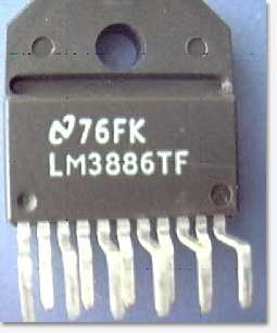

It should be noted that there are two versions of the LM3886: the LM3886TA with an insulating housing and the LM3886TF without an insulating housing. This application uses an insulating gasket and thermal grease for direct connection to the heatsink. Users of the TA version must use an insulating gasket and thermal grease, and ensure that the mounting bolts are insulated from the heatsink.

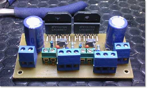

The power supply printed circuit board is as follows:
Gain Cloning Power Amplifier LM3886
This board features a simple design, including four PCB terminals, two KBU6 series diode bridges, and two 10000μF/35V capacitors. It will be mounted in the same chassis as the amplifier and connected via DC1 and DC2 shorts.

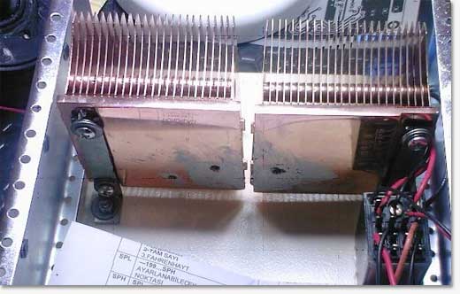

Cooler Selection: TA version users require a 2.8°C/W cooler, which is approximately 5cm x 10cm aluminum heatsink with 8 or more fins. TF version users require a 1.8°C/W cooler, equivalent to twice the size. Smaller copper heatsinks can also be tried. This application uses two fanless copper heatsinks connected together for the AMD Athlon processors.
A standard heatsink costs 50-100 yuan, with a total cost of approximately 35 yuan for the solution... This configuration passed the temperature rise test during an average two-hour rock music session (approximately 20W x 2). Test method: After two hours of operation, if a finger can continuously touch the IC surface for more than 10 seconds, the heat dissipation is considered合格 (qualified). The heatsink surface temperature should be close to the IC temperature. If measured with a thermocouple, the surface temperature should be below 65°C; otherwise, thermal protection will be triggered. If the IC overheats while the heatsink remains cool, the connections and thermal paste need to be checked.

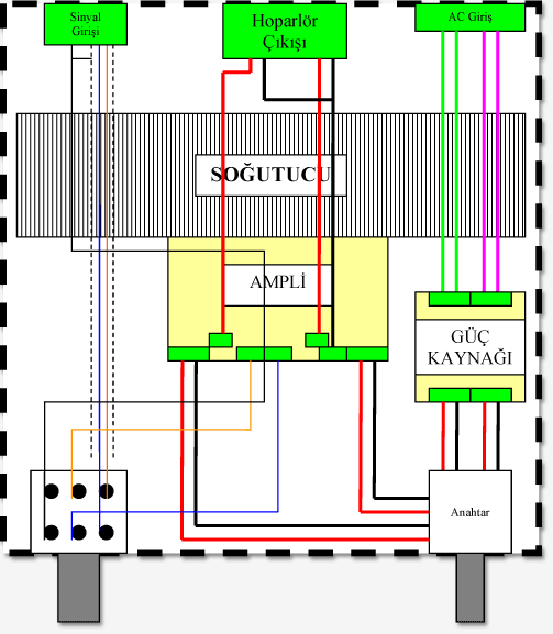

Assembly:
Collect all circuit boards into one or more enclosures and secure them in place. Wooden, plastic, or metal enclosures are recommended, and each enclosure must have ventilation holes. Allow sufficient space behind the enclosure.
The back panel requires connection to three terminals/ports: a 4-pin power connector (or a 4-pin PC hard drive connector), a standard speaker connector, and an RCA signal input connector. For single-input, single-channel amplifiers, single input is recommended to maintain the lowest possible noise.
The signal cable connection is the most critical; improper handling can lead to noise.
- The RCA signal input interface connects to the enclosure via the shortest path and directly connects to the amplifier circuit board using fine-core audio codec terminals.
- The left and right channels of the same RCA connector are connected to the far end of the volume potentiometer via a shielded cable (LIYCY).
- The potentiometer's midpoint is connected to the audio encoding terminal via a short wire, and the cable shield is grounded at one end.
- It is absolutely forbidden to share a ground with two independent shielded wires.
- The RCA connector housing must be grounded.
- Never operate a potentiometer without a load, as this will cause the integrated circuit to oscillate and burn out the tweeter.
- When using the LM3886TA, insulating gaskets and bolts must be installed. Before powering on, the metal parts should be measured to be open circuits.
- A 100Hz buzzing sound will be generated if the signal loop forms a ground loop with the chassis.
Speaker connection: Connect the (+) terminal to the CMB encoding terminal (the only multi-pin terminal). The GND-RET encoding terminal is the power distribution point. Signal lines must not be connected to this point. It can be connected to the chassis through a single-point grounding connection.
Finally, please note: Use at least 1.5mm² cross-sectional area multi-core wire for power and speaker connections, otherwise there is a risk of overheating.
