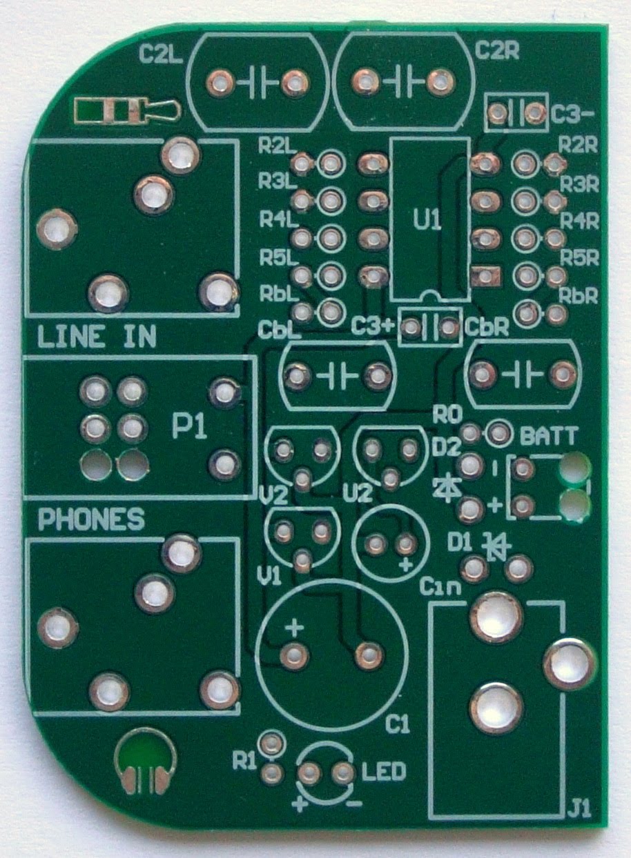

+ Use double-sided PCB with grounding layer

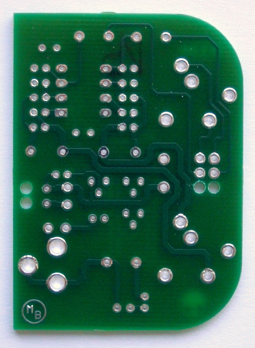

+ Modify PCB shape

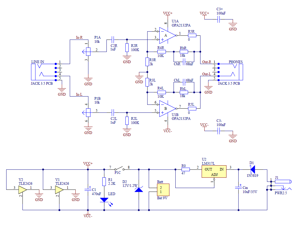

After several hours of thought, a new schematic diagram emerged.
P1 is a volume potentiometer with a switch. C2 is a coupling capacitor. R2 defines the input impedance of the operational amplifier. R3 and R4 define the amplifier's gain (5x in this case). Rb and Cb form the bass boost circuit. These components increase the low-frequency gain. For low frequencies, the gain is 14. You can increase the low-frequency gain by increasing the Rb resistor, and vice versa. You can lower the cutoff frequency by increasing the Cb capacitor. The bass boost can be disabled by shorting the Rb resistor. As for the operational amplifier, I use the OPA2132, but many other models can also be used, such as the OPA2134, OPA2227, NE5532, etc. C3+ and C3- are blocking capacitors for the operational amplifier's power supply. R5 is optional, but to avoid some bounce at the output, the value should be around 22 ohms.
V1 is a rail splitter used to create a virtual ground. C1 is a high-quality, low-ESR blocking capacitor. Resistor R1 limits the current through the LED. The value should be modified according to the type of LED. D2 limits the maximum input voltage to 12V. U2, together with resistor R0, creates a constant current source for charging a 9V battery. In my case, R0 is 47 ohms, so the current is approximately 25mA. Cin is a tantalum blocking capacitor for U2. D1 is a Schottky diode used to prevent any damage when connected with voltages of opposite polarity.

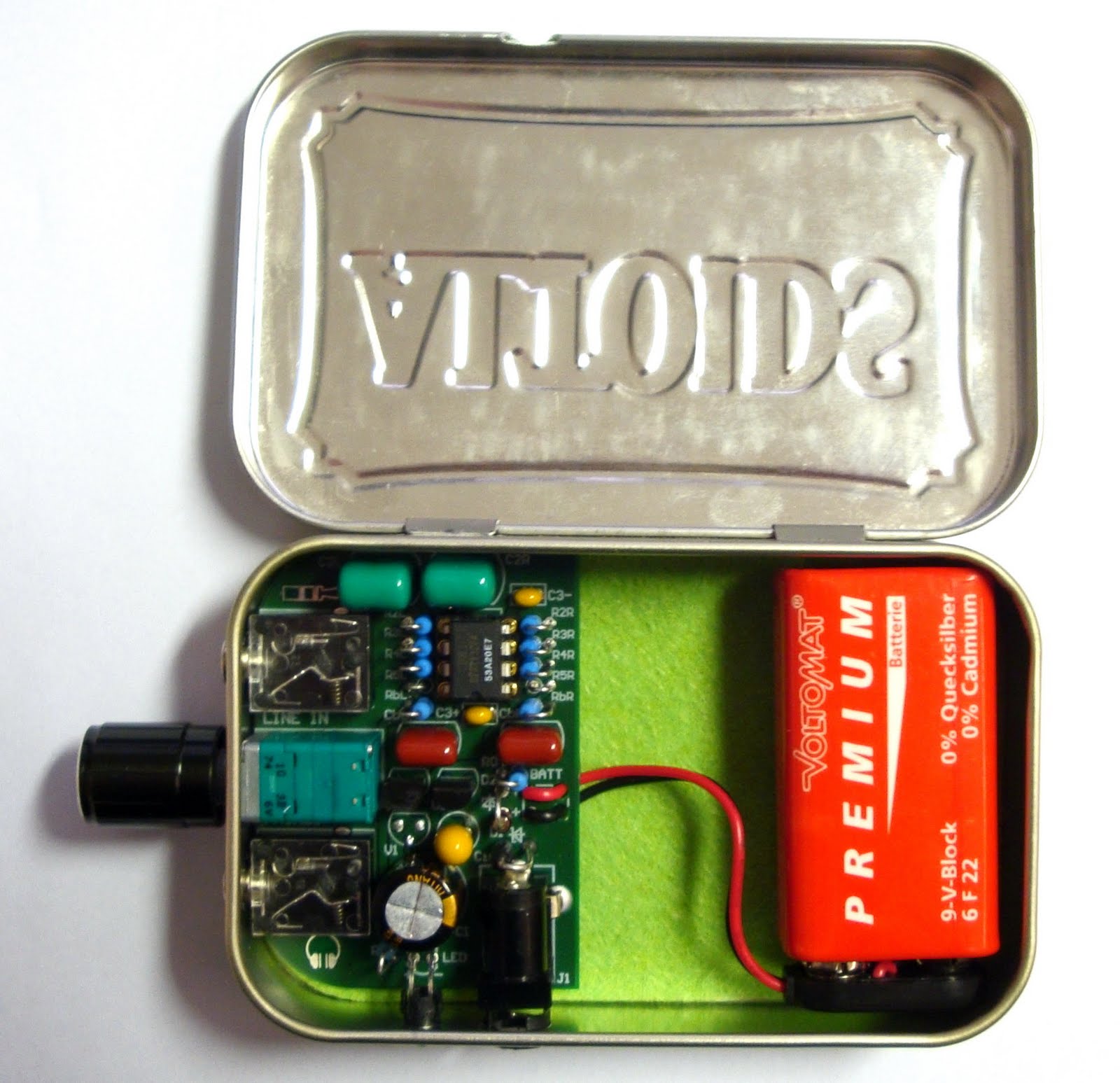

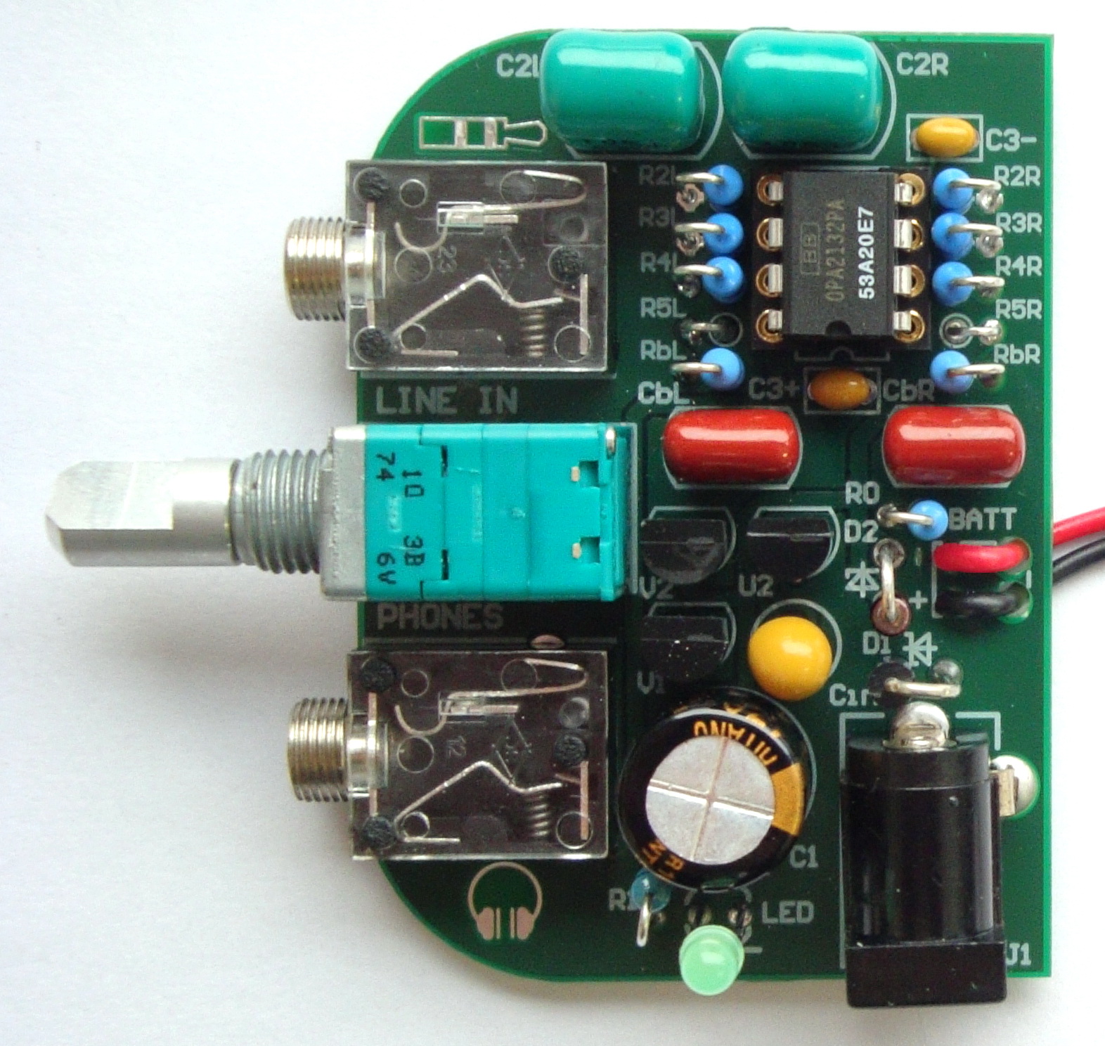

I designed a PCB with two rounded corners. The PCB fits perfectly in an Altoids can (see image below). The PCB also features beautifully designed input jacks and headphone jacks. Resistors and diodes must be mounted vertically to minimize space usage.

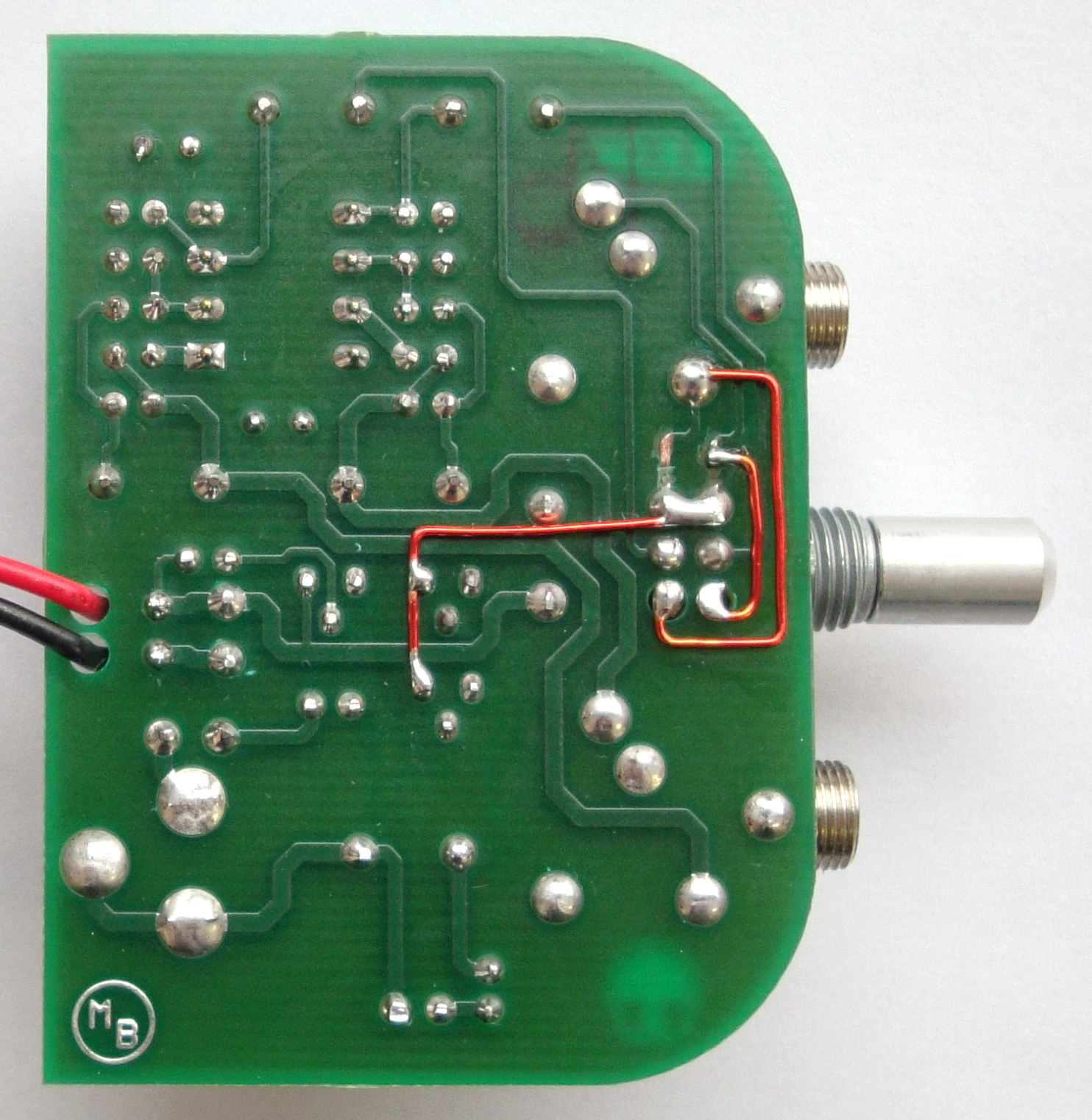

As you can see in my first prototype, there are some errors and modifications:
1) Pins 1 and 3 of the volume potentiometer P1 must be swapped; otherwise, the volume will be set to maximum if the amplifier is on.
2) The polarity markings on the battery clips are reversed.
