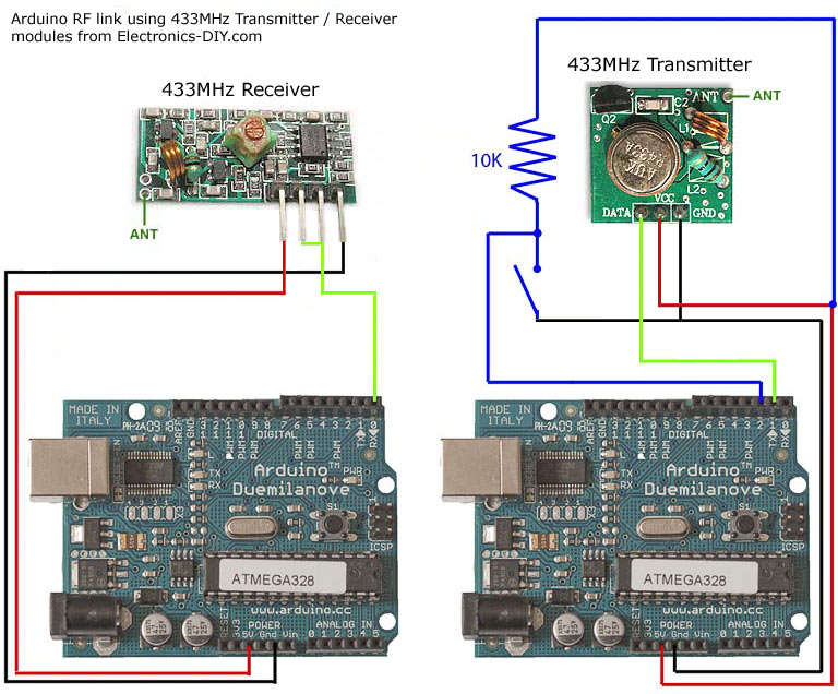

Arduino uses RF links for a 433MHz transmitter/receiver module.
If you're looking for wireless communication between two Arduino modules, this project might be helpful. It uses a low-cost RF transmitter and receiver from Electronics-DIY.com to establish a radio link between two Arduino boards over distances up to 500 feet. Data can be transmitted serially at rates up to 2400 bps. The schematic shows how the receiver and transmitter connect to two different Arduino boards. When connecting the receiver/transmitter, you simply need to power/ground them and then a pin for either TX (serial transmit) or RX (serial receive). I also connected a button to the Arduino making the transmission and used an LED on pin 13 of my Arduino board on the receiver to test the setup. The test application simply blinks the LED on the receiver board when the button is pressed on the transmitter board.
I was looking for a way to handle wireless communication between two Arduino boards. Then I found inexpensive RF transmitter and receiver modules on Electronics-DIY.com.
Here are some things to consider when using RF solutions:
- Communication is unidirectional. If you want two-way communication, you will need to purchase two receivers and two transmitters.
The variable gain on the receiver caused it to pick up a lot of background noise. I had to do some processing with the Arduino to filter out this noise. More details are in the code section below.
The maximum bandwidth is 2400 bps, but there is a 4800 bps version. Most of the bandwidth is used for the network protocol I wrote to handle error detection.
- The range is limited to a maximum of 500 feet.
Its advantages are that it is cheap and quite easy to use.

Because the receiver constantly picks up random noise, I added some extra bytes to each packet. I added two bytes to indicate the start of the packet. Then I sent a byte address. This address allows multiple devices to operate in the same area without interfering with each other. Next is the data (in my example code, an unsigned integer (2 bytes)). Finally, I sent a checksum, which is a simple XOR of all the data bytes, to ensure that the data is not corrupted upon reception.
I split the Arduino code into two files. If you've never used two files in your Arduino before, you just need to put both files in the same directory, and the Arduino IDE will merge them for you.

Increase range
None of my initial tests showed these improvements; everything worked perfectly in the same room.
- Add an antenna. All you need is a 23cm long wire. I did, and it allowed me to reliably transmit data from one corner of the house to another (a three-story townhouse).
- Increase the transmitter voltage. The transmitter can use 2-12 volts. 5 volts was sufficient for my use case, but if you need more range, increase the voltage.
- Lower the baud rate. My test application runs at 1200 bps, with a maximum of 2400 bps. You can further reduce it to 300 bps, which should help reduce transmission errors and hopefully increase range.
