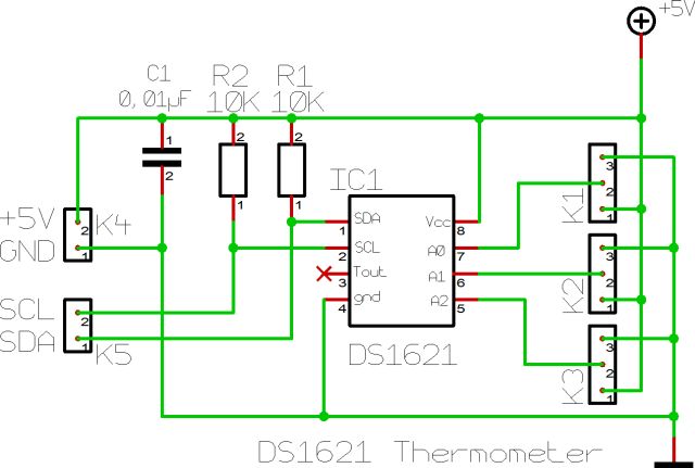

This small thermometer board connects directly to the PORTD of the AVR 2313 project board. It uses the Dallas DS1621 digital thermometer and thermostat chip. The DS1621 measures temperatures from -55°C to +125°C in 0.5°C steps and requires no calibration or external components. It also has a built-in thermostat with high and low setpoints that can be programmed by the user. Below you can see the pin description of the DS1621.
