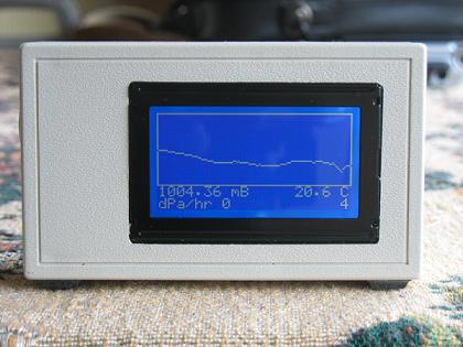

Digital barometer with graphical LCD display
Source: InternetPublisher:fjub27SH Keywords: LCD digital barometer Updated: 2025/12/16
This is a digital barometer using an Atmega8 microcontroller and a graphical LCD display. This project utilizes an SCP barometer sensor with the graphical LCD display connected to the Atmega8 microcontroller. The graphical LCD displays the latest 128 readings, taken every 20 minutes. You can view information for approximately the last two days. The provided C source code can be customized to your needs.
Record barometer/serial LCD code.
SPI pressure sensor
ATmega8
Serial 128/64 LCD
For chart scaling, one year of barometric pressure data was downloaded from the Tyddington, UK station. The data mean is +/- standard deviation 1012.76 +/- 9.9 mbar. Therefore, to cover a range of two standard deviations, a range of +/- 20 mbar needs to be plotted around the mean of 1013.25 mbar (standard atmosphere). Testing showed that this range is too large for short-term observations. The chart range is currently set by dividing by the constant SCALE=8 (default). Therefore, the pixel range [0,47] corresponds to the mbar range {1032.5, 994.8 mbar}.
