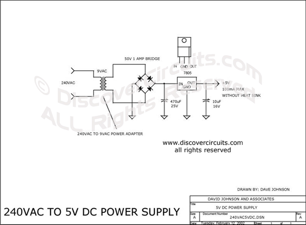

240V AC to 5V DC power supply
Source: InternetPublisher:DTWAG Keywords: DC power supply Updated: 2025/11/11
This is a simple method for powering some 5V logic circuits from a 240V AC power supply. If a 120V AC power adapter is used, the circuit will also work with a 120V AC power line.
