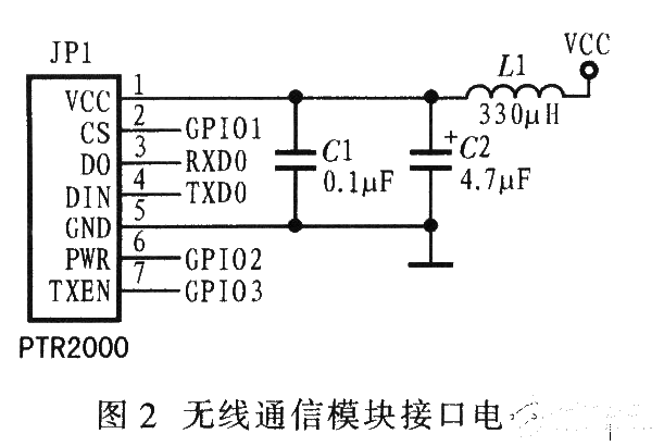

Wireless communication interface design
The system uses the PTR2000 wireless communication data transceiver module produced by Xuntong Company. The circuit interface is shown in Figure 2. This module is developed based on the radio frequency device nRF401 produced by NORDIC. Its characteristics are: ① There are two channels to choose from, and the operating rate is up to 20 Kb/s; ② The reception and transmission are integrated, suitable for duplex and simplex communication, so the communication method Relatively flexible; ③ Small size, less peripheral components required, simple interface circuit, so it is particularly suitable for miniaturization requirements of robots; ④ Can be directly connected to the microcontroller serial port module, simple control; ⑤ Strong anti-interference ability; ⑥ Low power consumption, stable communication.

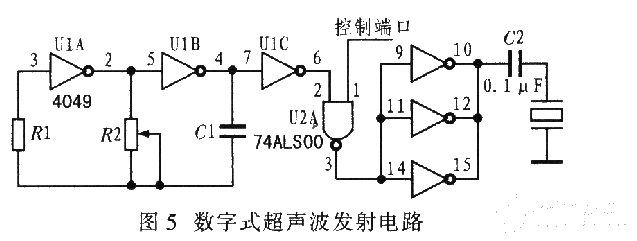

The two ultrasonic sensors are used to control the robot to avoid obstacles, predict the distance of the robot relative to the destination, and play a navigation role. The receiving part is connected to the capture and timing pins of the microcontroller. The entire ultrasonic detection system consists of ultrasonic transmitter, ultrasonic receiver and microcontroller control. The transmitting part consists of a high-frequency oscillator, a power amplifier and an ultrasonic transducer. After being amplified by a power amplifier, ultrasonic waves are emitted through an ultrasonic transducer.
Figure 5 shows an ultrasonic oscillation circuit composed of digital integrated circuits. The high-frequency voltage signal generated by the oscillator passes through the capacitor C2 to remove the DC content in the signal and feeds it to the ultrasonic transducer MA40S2S. Its working process: U1A and U1B generate a high-frequency voltage signal corresponding to the ultrasonic frequency. This signal is converted into a standard square wave signal through the inverter U1C, and then amplified by power. C2 isolates the DC signal and then adds it to the ultrasonic transducer. MA40S2S performs ultrasonic emission. If DC voltage is applied to the ultrasonic transducer for a long time, its characteristics will significantly deteriorate, so the AC voltage is generally treated with DC isolation. U2A is a 74ALS00 NAND gate, and the control_port (control port) pin is the control port. When control_port is high level, the ultrasonic transducer emits ultrasonic signals.
