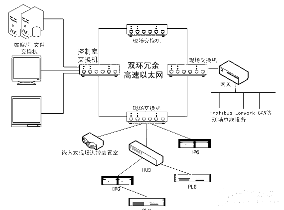

On-site intelligent monitoring devices are the foundation and key to building control networks. The use of high-end embedded technology to develop Ethernet on-site intelligent devices is an important development trend. This article proposes a monitoring system based on embedded industrial Ethernet technology, and details the design process of the hardware and software of the embedded industrial Ethernet monitoring device, including the implementation of the 32-bit microprocessor system, the implementation of the Ethernet interface unit module, uCLinux Embedded operating system analysis and transplantation, driver analysis and implementation under uCLinux, Socket socket analysis, HTTP protocol analysis, embedded Web server implementation, etc. This paper designs a dual-ring redundant high-speed industrial monitoring network system based on Ethernet. The system structure diagram is shown in Figure 1.

Figure 1 Dual-ring redundant high-speed Ethernet structure diagram

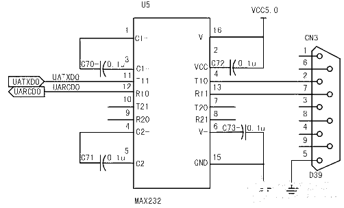

The RS-232 serial interface circuit is used for peer-to-peer connection between the embedded microprocessor serial module and external serial resources to achieve conversion between LUTTL level and RS-232 level. This article designs and uses an RS-232 serial port circuit. . Figure 2 is the RS-232 serial interface circuit diagram. The data transmission signal UATXD0 of UART0 is connected to T11 of MAX3232E. After being converted into RS-232-C level, T10 is connected to the RXD pin of the 9-pin plug. The TXD signal of the 9-pin plug is connected to R11 of MAX3232E. After being converted into LVTTL level, R10 is connected to the data receiving pin UARXD0 of UARTO.
