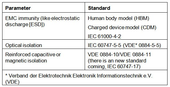

Semiconductors have their own specific EMC and isolation standards at the component level. Some examples are shown in Table 1.
Table 1: Component-level semiconductor standards

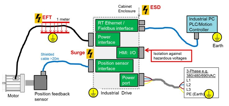

How do EMC immunity, EMI, and isolation requirements apply to industrial drives? What does testing look like? Figure 1 shows a simplified architecture of an industrial drive divided into various subsystems with interfaces and connectors accessible outside the cabinet. EMC immunity test signals such as surge, electrical fast transient (EFT), or ESD are applied to the interface connectors of each subsystem. Typical subsystems with accessible interfaces or connectors include communications, user input and output (I/O) interfaces, position feedback interfaces, power interfaces, and AC power input.
Figure 1: Example EMC immunity test signal in an industrial drive
Each interface or port must pass the corresponding EMC immunity requirements as well as EMI and isolation requirements. In particular, semiconductor interface ICs such as Ethernet PHY, RS-485 transceivers, or isolated gate drivers have a significant impact on passing system-level standards. Therefore, EMC immunity, EMI, or isolation performance at the semiconductor component level, as shown in Table 1, becomes a key selection criterion.
