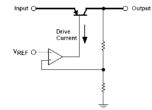

LDO
1. In the design of step-down power supply with large voltage difference or large current, it is recommended to use switching power supply and avoid using LDO.
Using linear power supplies (including LDOs) can achieve lower noise, and because it is simple to use and low cost, it is widely used on single boards. The FPGA core power supply, the power supply for the RF clock portion of some circuit boards, etc. are all adjusted from higher voltage supplies using linear power supplies. LDO must calculate heat dissipation and meet derating specifications
2. When selecting the filter capacitor at the LDO output, pay attention to the minimum capacitance required in the manual and the ESR/ESL of the capacitor to ensure circuit stability. It is recommended to use multiple capacitors of equal value in parallel to increase reliability and improve performance.
The LDO output capacitor provides transient current for load changes. At the same time, because the output capacitor is in the voltage feedback regulation loop, in some LDOs, there are requirements for the capacitance to ensure the stability of the regulation loop. The capacitance of this capacitor does not meet the requirements, and the LDO may oscillate, causing large ripples in the output voltage.
Multiple capacitors in parallel, as well as large-capacity electrolytic capacitors in parallel with small-capacity ceramic capacitors, can help reduce ESR and ESL and improve the high-frequency performance of the circuit. However, for some linear regulated power supplies, the ESR of the output capacitor is too low. It may induce a decrease in the loop stability margin or even cause loop instability.
