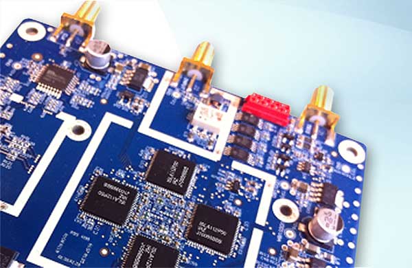

This reference design demonstrates the performance attainable by combining Renesas' ADC technology and SP Devices' interleaving algorithms. In this design, four ISLA112P50 12-bit, 500MSPS analog-to-digital converters are interleaved to sample at a rate of 2.0GSPS. At this sampling rate, the reference design provides over 6dB more SNR and 13dB better SFDR than the best alternative stand-alone ADC.
Collaboration of Renesas and SP Devices
Demonstrates 4-way interleaving of Renesas 500MSPS ISLA112P50s
Sample rate: 2.0GSPS
Resolution: 12 bits
Interleave correction details
SP Devices’ ADX4 provides real-time, digital, FPGA based digital interleave correction of four ISLA112P50s' performance
