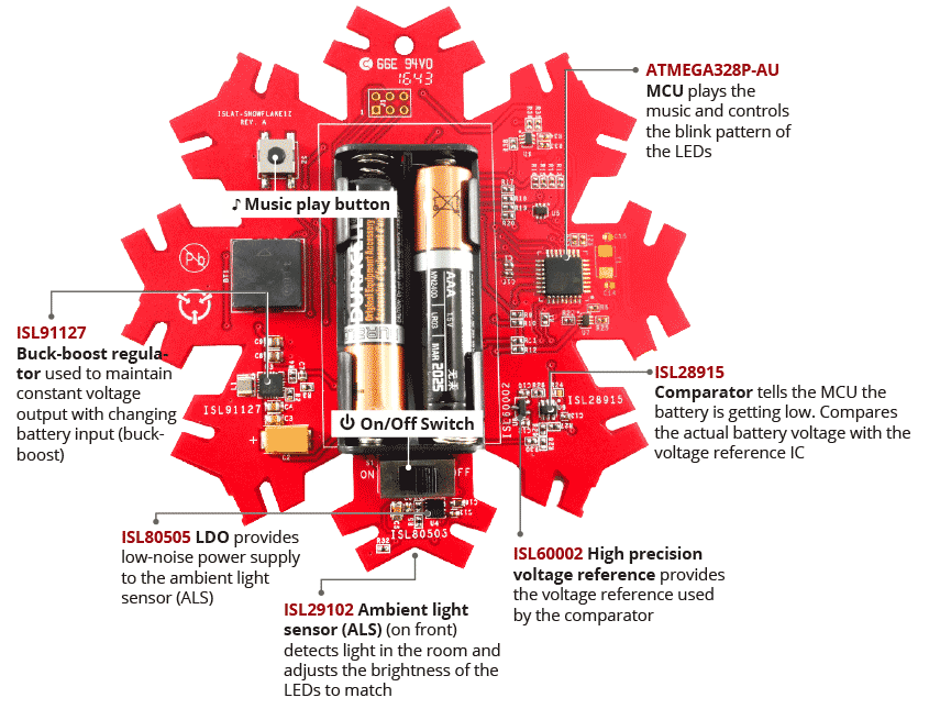

The snowflake ornament reference design has a series of LEDs that fade on and off in an eye-pleasing pattern and plays the familiar song “Let it Snow, Let it Snow, Let it Snow” via a small buzzer when the button on the back of the board is pressed.
The brightness of the LEDs adjust to the ambient light in the room in order to keep the brightness appropriate to the surroundings. Additionally, there is a low-battery detect feature as well as a four hour time-out alert to remind the user to turn off the reference design and avoid depleting the batteries.
The reference design is powered by two AAA batteries and is light-weight enough to prominently hang on a tree via a hole at the top of the reference design with the included ribbon.
