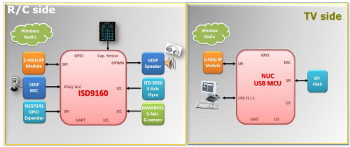

Most smart controls combine RF functionality with smartphone control capabilities in affordable packages. These smart controls are unique universal remote systems capable of controlling multiple devices. The ISD9160 remote reference design is extremely thin and light, and operates via RF rather than infrared, so you don't need to point a straight line at your component. The ISD9160 smart control reference design combines RF functionality and smartphone control in an affordable, universal remote kit. The reference design also supports Skype/Voice calling, with the remote becoming a headset with volume control and microphone support. The remote control can also be used as an air mouse that supports ITG-3050 Gyro (3- axis ) and MMA-8451 (3- axis ) G sensor modules.
ISD9160 smart remote control specifications :
  • FCC/ETSI certification
  • Low power consumption:
    • <5uA @standby mode
    • 17mA @key matrix operation mode
    • 30mA @Microphone operating mode
  • FHSS frequency hopping: 164 channels
  • Operation: 8 meters
  • Audio quality : 16-bit PCM @16KHz
  • Supports Skype / voice calls
  The unique voice activation/recognition function of the ISD9160 reference design can support
  functions such as watching TV, Skype, playing X-Box, watching movies, DVDs, etc. It is designed for low power consumption and competitive BOM cost
