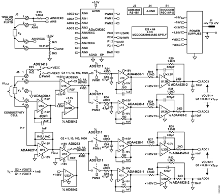

Circuit functions and advantages
The circuit in Figure 1 is a completely self-contained, microprocessor-controlled, high-precision conductivity measurement system suitable for measuring the ionic content of liquids, water quality analysis, industrial quality control, and chemical analysis.
A carefully selected combination of precision signal conditioning components provides better than 0.3% accuracy over the 0.1 μS to 10 S (10 MΩ to 0.1 Ω) conductivity range without calibration.
Provides automatic detection for 100 Ω or 1000 Ω platinum (Pt) resistance temperature detectors (RTDs), allowing conductivity measurements to be referenced to room temperature.
The system supports two-wire or four-wire conductivity cells and two-, three- or four-wire RTDs for increased accuracy and flexibility.
This circuit generates precise AC excitation voltages with minimal DC offset, thereby avoiding damage to the polarization voltage on the conductivity electrode. The amplitude and frequency of AC stimulation are user programmable.
Innovative synchronous sampling technology converts the peak-to-peak amplitude of the excitation voltage and current into DC values, which not only improves accuracy but also simplifies signal processing by the dual-channel 24-bit Σ-Δ ADC built into the precision analog microcontroller. .
Intuitive user interface using LCD display and encoder buttons. The circuit communicates with a PC using an RS-485 interface on demand and operates from a single 4 V to 7 V power supply.
Circuit description
The excitation square wave for the conductivity cell is generated by switching the ADG1419 between +VEXC and −VEXC voltages using the PWM output of the ADuCM360 microcontroller . The square wave must have an exact 50% duty cycle and very low DC offset. Even small DC imbalances can damage the conductivity cell over time.
The +VEXC and −VEXC voltages are generated by the ADA4077-2 operational amplifiers (U9A and U9B), and the amplitude of these two voltages is controlled by the DAC output of the ADuCM360, as shown in Figure 2.
The ADA4077-2 has a typical offset voltage of 15 μV (Grade A), a bias current of 0.4 nA, an offset current of 0.1 nA, an output current up to ±10 mA, and a dropout voltage below 1.2 V. The U9A op amp has a closed-loop gain of 8.33 and converts the ADuCM360 internal DAC output (0 V to 1.2 V) to a +VEXC voltage in the 0 V to 10 V range. The U9B op amp inverts +VEXC, producing the −VEXC voltage. Choose R22 such that R22 = R24||R27 to eliminate the first-order bias current. The error caused by U9A's 15 μV offset voltage is approximately (2 × 15 μV) ÷ 10 V = 3 ppm. Therefore, the main error produced by the inverting stage is the resistor matching error between R24 and R27.
The ADG1419 is a 2.1 Ω on-resistance SPDT analog switch with an on-resistance flatness of 50 mΩ over a ±10 V range, making it ideal for generating symmetrical square wave signals from ±VEXC voltages. Resistor R23 limits the maximum current through the sensor to 10 V/1 kΩ = 10 mA. The symmetry error caused by the ADG1419 is typically 50 mΩ ÷1 kΩ = 50 ppm.
The voltage V1 applied to the conductivity cell is measured using the AD8253 instrumentation amplifier (U15). U15 positive input is buffered by ADA4000-1 (U14). The ADA4000-1 was chosen because it has a low bias current of 5 pA, which minimizes low current measurement errors associated with low conductivity. The negative input of the AD8253 does not require buffering.
The synchronous sampling stage can eliminate the offset voltage of U14 and U15 without affecting the measurement accuracy.
U15 and U18 use the AD825310 MHz, 20 V/μs, programmable gain (G = 1, 10, 100, 1000) instrumentation amplifier with a gain error of less than 0.04%. The AD8253 has a slew rate of 20 V/μs and a 0.001% settling time of 1.8 μs (G = 1000). Its common-mode rejection is typically 120 dB.
Stage U19 ( ADA4627-1 ) is a precision current-to-voltage converter that converts the current flowing through the sensor into a voltage. The device's low bias current and low offset voltage performance make it an ideal choice for this stage. A 120 μV offset error creates a symmetrical error of only 120 μV/10 V = 12 ppm. The ADA4627-1 has an offset voltage of 120 μV (typ, Class A), a bias current of 1 pA (typ), a slew rate of 40 V/μs, and a 0.01% settling time of 550 ns.
The U22A and U22B ( AD8542 ) buffers provide the 1.65 V reference voltage for the U18 and U15 instrumentation amplifiers, respectively.
The remaining devices on the voltage channel signal path (U17A, U17B, U10, U13, U12A, and U12B) are described below. The current channels (U17C, U17D, U16, U21, U20A, and U20B) work the same way.
ADuCM360 can generate the PWM0 square wave switching signal for use by the ADG1419 switch, and can also generate PWM1 and PWM2 synchronization signals for use by the synchronous sampling stage. The voltage and three timing waveforms of the conductivity cell are shown in Figure 3.
The output of the AD8253 instrumentation amplifier (U15) drives two parallel sample-and-hold circuits; these two circuits consist of the ADG1211 switch (U17A/U17B), series resistor (R34/R36), holding capacitor (C50/C73), and unity gain buffer ( U10/U13) composition.
The ADG1211 is a low charge injection, four-channel SPST analog switch that operates from a ±15 V supply voltage and accepts input signals up to ±10 V. The maximum charge injection due to switching is 4 pC, resulting in a voltage error of only 4 pC ÷4.7 μF = 0.9 μV.
The PWM1 signal enables the U10 sample-and-hold buffer to sample on the negative cycle of the sensor voltage and then hold it until the next sample period. Therefore, the U10 sample-and-hold buffer output is equal to the DC level corresponding to the negative amplitude of the sensor voltage square wave.
Similarly, the PWM2 signal enables the U13 sample-and-hold buffer to sample during the positive period of the sensor voltage and then hold it until the next sample period. Therefore, the U13 sample-and-hold buffer output is equal to the DC level corresponding to the positive amplitude of the sensor voltage square wave.
The sample-and-hold buffer ( ADA4638-1 ) has a typical bias current of 45 pA, while the ADG1211 switch has a typical leakage current of 20 pA. Therefore, the worst-case leakage current of the 4.7 μF holding capacitor is 65 pA. For an excitation frequency of 100 Hz, the period is 10 ms. The voltage drop over half a cycle (5 ms) due to 65 pA leakage current is (65 pA × 5 ms) ÷ 4.7 μF = 0.07 μV.
The ADA4638-1 zero-drift amplifier has a typical offset voltage of only 0.5 μV, which contributes negligible error.
The last stage in the signal chain before the ADC is the ADA4528-2 inverting attenuator (U12A and U12B), which has a gain of −0.16 and a common-mode output voltage of +1.65 V. The ADA4528-2 offset voltage is typically 0.3 μV, so the error contribution is negligible.
The attenuator stage reduces a ±10 V maximum signal to ±1.6 V, with a common-mode voltage of +1.65 V. This range is equivalent to the ADuCM360ADC input range, which is 0 V to 3.3 V (1.65 V ± 1.65 V) using a 3.3 V AVDD supply.
The attenuator stage also provides noise filtering, with a −3 dB frequency of approximately 198 kHz.

The CN-0359 circuit allows programmable excitation voltages ranging from 100 mV to 10 V, and the R23 (1 kΩ) series resistor limits the maximum conductivity cell current to 10 mA. The most fundamental precaution is not to exceed the conductivity cell excitation voltage or excitation current rating.
