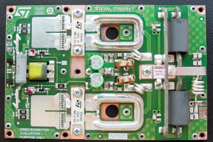

The STEVAL-TDR029V1 is a RF broadband power amplifier intended for FM broadcast radio transmitters over the band 87.5 to 108 MHz using 2x STAC2942B N-channel MOS field-effect transistors.
STEVAL-TDR029V1 is designed in cooperation with InnovAction S.r.l in italy.
Main features
  • Excellent thermal stability
  • Frequency: 87.5 - 108 MHz
  • Supply voltage: 48 V
  • Output power: 700 W min
  • Gain: 20 dB typ.
  • Efficiency: 77 % typ
  • Harmonics: - 36 dBc max
  • Gain flatness: ± 0.5 dB max
