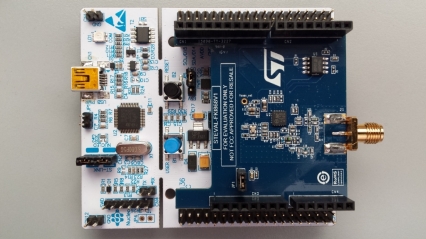

STEVAL-FKI868V1
The STEVAL-FKI868V1 evaluation board is based on the S2-LP sub-1 GHz ultra-low power low data-rate transceiver, suitable for ISM bands and Wireless M-Bus.
The main board is the NUCLEO-L152RE development board, equipped with a low power microcontroller STM32L to control the S2-LP and the ST-LINK/V2-1 debugger and programmer for firmware updating.
Main features
  • S2-LP narrow band ultra-low power sub-1 GHz transceiver in a standalone RF Module tuned for 860 - 940 MHz frequency bands
  • STM32 Nucleo development board with STM32L152RE MCU
  • Suitable for Wireless M-Bus systems
  • Associated S2-LP development kit including, documentation, firmware for STM32L and GUI
  • Programmable RF output power up to +16 dBm
  • Modulation schemes: 2-FSK, 2-GFSK, 4-FSK, 4-GFSK, OOK, and ASK
  • Air data rate from 0.3 to 500 kbps
  • Ultra-low power consumption:
    • 6.7 mA RX
    • 10 mA TX at +10 dBm
  • Excellent performance of receiver sensitivity (up to -130 dBm)
  • Low duty cycle RX / TX operation mode
  • Automatic acknowledgement, retransmission, and timeout protocol engine
  • SPI interface for microcontroller
  • USB interface
  • RoHS compliant
