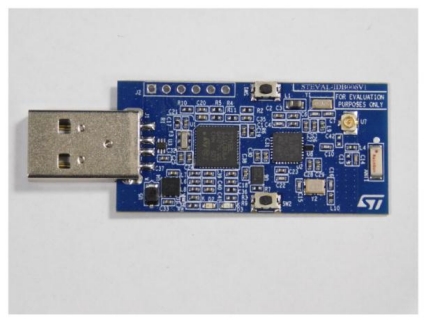

Bluetooth® Smart USB based on BlueNRG-MS
STEVAL-IDB006V1
The STEVAL-IDB006V1 is an evaluation board based on the BlueNRG-MS low power Bluetooth® Smart IC, compliant with the Bluetooth® 4.1 specifications and able to support both master and slave roles.
The STEVAL-IDB006V1 features an onboard, low-power STM32L microcontroller. It is primarily designed to interface with BlueNRG-MS, but can aslo be used for custom application development. The STEVAL-IDB006V1 has a USB connector for PC GUI interaction and firmware updates.
While the board does not come with a mounted JTAG connector, the footprint area is available. When a JTAG connector is soldered, users can develop custom firmware for the STM32L microcontroller.
Main features
  • BlueNRG-MS based Bluetooth® Smart USB dongle for direct PC connection
  • Maximum transmission power + 8 dBm
  • Low power STM32L host microcontroller
  • Major features of BlueNRG-MS: 7.3 mA (RX mode), 8.2 mA (TX mode at 0 dBm) maximum peak current, programmable output power from 18 dBm to +8dBm, up to 96 dB RF link budget
  • USB Interface
  • Bluetooth® low energy 4.1 compliant, supports both master and slave roles
  • JTAG footprint connector for custom firmware development (JTAG connector not mounted)
  • RoHS compliant
