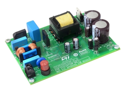

Very Low THD 35W LED Driver Based on HVLED007 Transition Mode Flyback Controller
EVLHVLED007W35F
The EVLHVLED007W35F supplies a stable and isolated 48 V voltage bus suitable for secondary side circuitry (e.g., LED current generators) for a total output power of 35 W when a wide range of input voltages is applied at its input. An auxiliary 12 V output is also present to supply small circuits which absorb a maximum current of 15 mA.
Thanks to an STMicroelectronics patented control embedded on HVLED007, the main feature of this design is the very low input current distortion (THD) in flyback converter operating in Transition mode (Quasi-Resonant).
Fast startup and protections with auto-restart are available for safe operation in lighting environments.
Main features
  • AC input voltage from 90 V to 265 V (frequency range 45 - 66 Hz)
  • Isolated DC bus voltage (Flyback topology): 48 V / 730 mA max.
  • High Power Factor Flyback with very low THD: 100 AC: PF>0.99, THD0.98, THD
  • Efficiency: >89 % @ full load
  • Mains harmonics: meets EN61000-3-2 and JEITA-MITI Class-C
  • EMI: according to EN55022 Class-B
  • RoHS compliant
