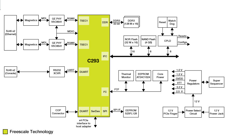

The C29x PCI Express (PCIe) adapter platform is an ideal hardware and software development environment for high-performance networking applications such as unified threat management, application delivery controllers and hardware security modules.
· The platform is based on NXP's C29x cryptographic coprocessor family and uses a small and efficient half-length x4 PCIe form factor
· This scalable solution consists of 3 devices, the C291, C292 and C293 co-processors, providing processing capabilities of 8 to 32k 2048-bit RSA transactions per second.
The C29x PCIe adapter platform gives developers greater flexibility and can be integrated into a hosted development environment or as a standalone desktop embedded system.
