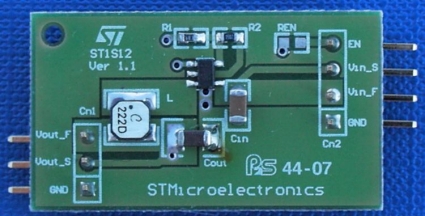

0.7A/3.3V synchronous buck converter with enable function based on ST1S12XX
STEVAL-ISA055V2
This demonstration board is based on the ST1S12 family of synchronous step-down DC-DC converters optimized for powering low-voltage digital cores in HDD (hard disk drive) applications, and is generally used to replace high-current linear solutions when power dissipation may cause high heating of the application environment.
It provides up to 0.7 A over an input voltage range of 2.5 V to 5.5 V. A high switching frequency of 1.7 MHz allows the use of tiny surface-mount components. A resistor divider to set the output voltage value, an inductor, and two capacitors are required for the adjustable version, while only an inductor and 2 capacitors are needed for the 1.2 V and 1.8 V fixed version.
A low output ripple is guaranteed by the current mode PWM topology and by the use of low ESR surface-mount ceramic capacitors.
The ST1S12 device is thermal protected and current limited to prevent damage due to accidental short-circuit. This family of products is available in the TSOT23-5L package.
Main features
  • RDS(on) typ. 250 m and 400 m
  • Non switching quiescent current: max 600 μA over temperature range
  • Uses tiny capacitors and inductors
  • Internal soft-start
  • Enable function
  • Step-down current mode PWM (1.7 MHz) DCDC converter
  • 0.7 A output current capability
  • Fixed output voltage 3.3 V
  • Synchronous rectification
  • Typical efficiency: > 90%
  • 3% DC output voltage tolerance
