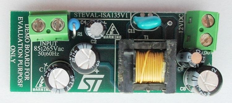

VIPER06HS ​​- 4W, 12V output isolated flyback converter using VIPer™Plus
STEVAL-ISA135V1
The STEVAL-ISA135V1 is a 12 V - 4 W power supply in isolated flyback topology based on the VIPer06HS, a new offline high voltage converter having, as main features: 800 V avalanche rugged power section, PWM operation at 115 kHz with frequency jittering for lower EMI, cycle-by-cycle current limit with adjustable set point, on-board soft-start and safe auto-restart after a fault condition.
Main features
  • AC main input voltage: VIN 85 VAC - 265 VAC
  • Main frequency: fL 50 Hz - 60 Hz
  • Output voltage: VOUT 12 V
  • Max output current: IOUT 333 mA
  • Precision of output regulation: ΔVOUT_LF ±5 %
  • High frequency output voltage ripple: ΔVOUT_HF 50 mV
  • Min active mode efficiency: ηAV 71 %
  • Max ambient operating temperature: TAMB 60 ºC
  • Thermal shutdown with hysteresis
  • Delayed overload protection
  • Open loop failure protection (if auxiliary winding is used)
  • RoHS compliant
参考设计图片
