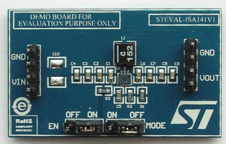

2A, 2MHz, Vout=3.3V, high-efficiency dual-mode buck-boost DC-DC converter based on STBB3J
STEVAL-ISA141V1
The STEVAL-ISA141V1 is a product evaluation board based on the STBB3J, which is a fixed-frequency, high-efficiency, buck-boost DC-DC converter which provides output voltages from 1.2 V to 5.5 V starting from an input voltage in the range of 1.8 V to 5.5 V. This device can operate with input voltages higher than, equal to, or lower than the output voltage making the product suitable for cell lithium-ion applications where the output voltage is within the battery voltage range.
The MODE pin allows the selection between auto mode and forced PWM mode, taking advantage of either a lower power consumption or best dynamic performance.
Main features
  • Input voltage range from 1.8 V to 5.5 V
  • 2 A output current at 3.3 V in buck mode (VIN = 3.6 V to 5.5 V)
  • 800 mA output current at 3.3 V in boost mode (VIN 2.0 V)
  • Typical efficiency higher than 94%
  • ±2% DC feedback voltage tolerance
  • Automatic transition between step-down and boost mode
  • Adjustable output voltage from 1.2 V to 5.5 V
  • Power save mode (PS) at light load
  • 2.0 MHz fixed switching frequency
  • Adjustable switching frequency up to 2.4 MHz (external synchronous square signal)
  • Device quiescent current less than 50 µA
  • Load disconnect during shutdown
  • Shutdown and soft-start functions
  • Shutdown current
  • Available in Flip-Chip 20, pitch = 0.4 mm
  • RoHS compliant
