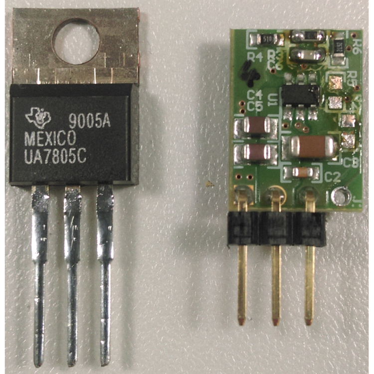

TI reference design TIDA-00947 demonstrates a 10.5mmx14.5mm, 92% efficient low electromagnetic interference (EMI) DC/DC module using the TPS54202, replacing low dropout regulators (LDOs) in most appliance applications. High efficiency eliminates the need for a heat sink, resulting in a smaller, lower cost solution. Higher current capacity enables the addition of more functionality (WiFi, sensors, etc.). High efficiency and low current consumption help achieve stringent energy efficiency ratings.
characteristic
  • ● 3.3V regulated voltage, output load up to 1A
  • ● Efficiency up to 92%
  • ● 1.5μA standby current and 84μA no-load current
  • ● Compact size: size and pin compatible, smaller than TO-220 (10.5mmx14.5mm)
  • ● Temperature rise is less than 31 o C at full load , no radiator required
  • ● Reduces the complexity of onboard DC/DC design, saving R&D time and energy in switching power supply EMC design (faster to market)

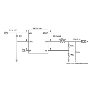

Blockdiagram
