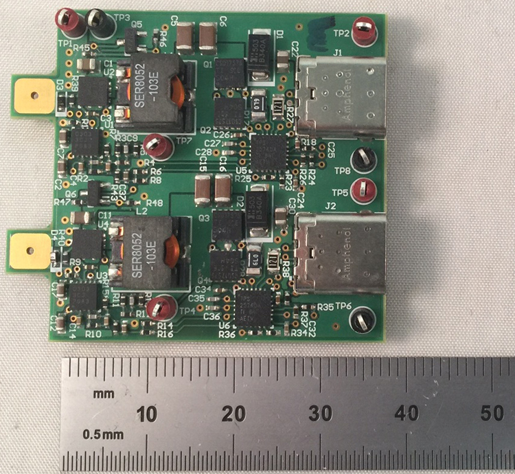

The PMP20172 reference design delivers up to 36W on two USB Type-C outputs. Input is 17VDC bus. These two outputs enable port power management. If only one port is used, the entire 36W will be allocated to that port. If two ports are used, 18W will be allocated on each port. Supported output voltages are 5V, 9V or 15V.
characteristic
  • ● Extremely efficient, providing 15V output while achieving over 98% efficiency
  • ● Intelligent power balancing
  • ● Compact reference design, 38mm x 38mm (1.5" x 1.5")
  • ● Low thickness, 5mm (0.2")
