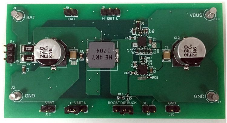

6A power solution reference design with 0.05% current accuracy for battery test systems
PMP15043
This reference design circuit introduces a high-precision bidirectional current power supply solution used in battery test systems (BTS). The maximum current capacity is 6A, and the full-scale accuracy is less than 0.05%. Controlled by logic pins, this circuit can be used to charge or discharge the battery. During the charging process, the battery voltage can also be controlled through analog signals. Design of this circuit is simple and easy due to the fully integrated buck and boost converters. The performance of the solution can be verified via a built-in evaluation board.
characteristic
  • ● 6A bidirectional current
  • ● FS current accuracy is less than 0.05%
  • ● Programmable current and voltage control
  • ● Fully integrated converter minimizes solution size
