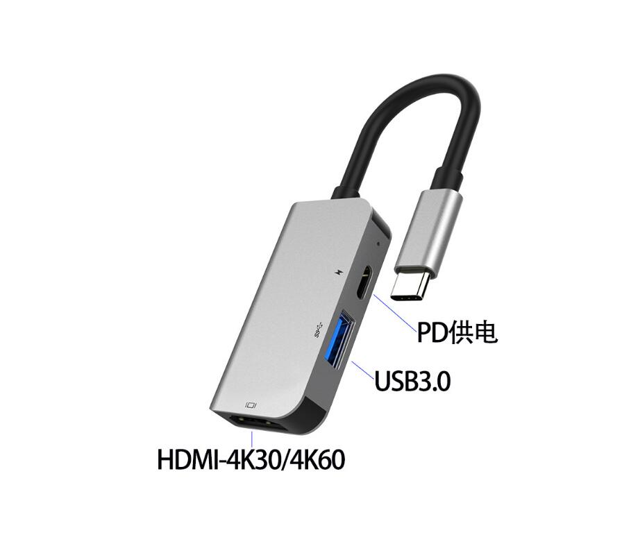

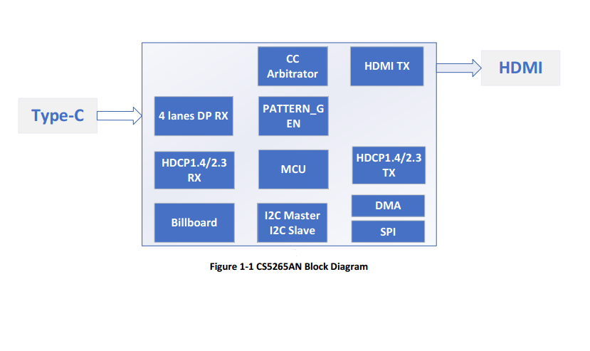

CS5265 is a high-performance TYPEC/DP1.4 to HDMI2.0 converter designed to connect to USB-C or DP1.4 to HDMI2.0 converters.
DP conversion combines HDCP1.4 and HDCP2.3 content protection schemes with embedded keys for the transmission of digital audio content. The HDMI interface includes 4 clock/data pairs, DDC and HPD signals. HDMI conversion is capable of supporting data rates up to 6Gps, enough to handle resolutions up to FHD 1080p 120Hz and UHD 4k 60Hz formats. HDMI conversion includes support for HDCP1.4 and HDCP to HDCP2.3. Thanks to the inclusion of HDCP, the CS5265 allows the transmission of protected content. Embedded keys provide additional HDCP key security.
CS5265 is a highly integrated single chip suitable for multiple market segments and display applications, such as TYPEC docking stations, docking stations, etc.
Blockdiagram
